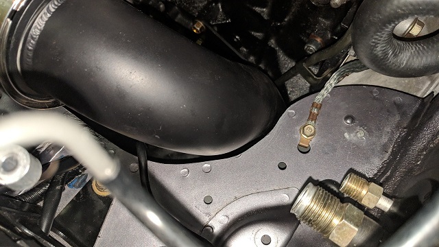

Trimmed the shelf a little more tonight, now has 5mm clearance to the downpipe (should be enough):
My trusty Dremel decided to self destruct internally as I was almost finished, something let go inside and it stopped spinning as it rattled to a stop, no smoke or smell at all - I can only guess that I was pushing the bit too hard into the shelf edge.
RIP trusty Dremel you've served me well over the last 16 years :(
I finished the remaining shaping/finishing with files.
I'll clean it up tomorrow and paint the edge - Dupli-Color's DSMZ17 is supposed to be Mazda's Titanium Grey so I'll give that a go.

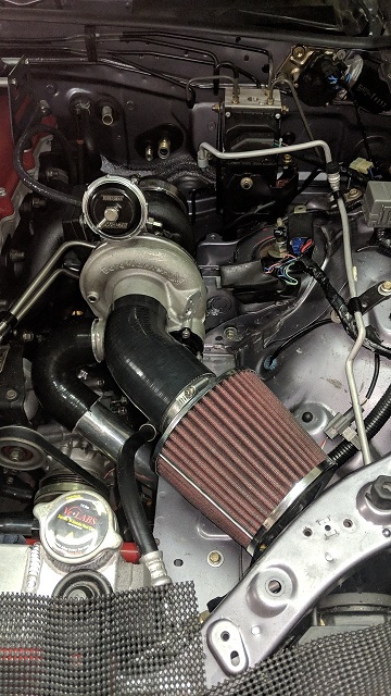

The air filter's 2.5"-3" silcone hose reducer 45* elbow arrived today so I cut it to size and fitted it:
There's a short 3" aluminium pipe joining the filter to the elbow which is completely encased by the silicone hose and air filter..
I'll make a bracket connecting the 3" elbow's end clamp (not in the pictures above) to the shelf so that the filter has more vertical stabilisation.
The Cold Air Box will have to wait until the A/C lines are sorted out but it'll be much smaller than the original one I made.

Good job! I'd check that you have enough clearance for the engine rocking laterally, it could still be a little tight there. Sorry :frown:

greenMachine: I rocked the engine as hard as I dared with the car on stands (and me standing on the car ramp which was under the passenger-side wheel in case the stand collapsed) and there's not much forward-reverse movement, there's more left-right movement and when the engine's running, left-right movement is "the norm" due to the rotation of the crankshaft. Painting the cut shelf edge and looking at the ceramic-coated downpipe will make it very easy to spot if this is a problem.

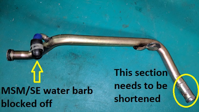

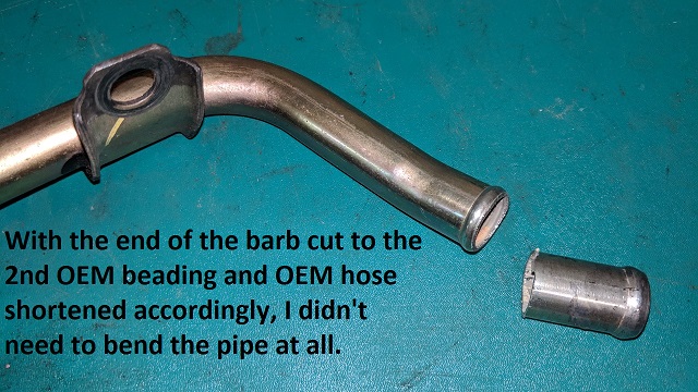

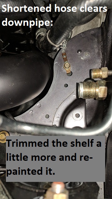

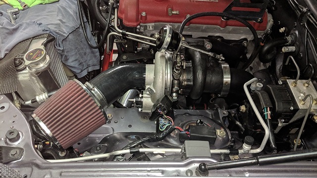

This weekend's jobs were to modify the water heater pipe since the hose is too close to the downpipe, shorten the 4-AN oil line so that it could route to the turbo on the engine side vs the opposite side (cleans up that side nicely) and re-mount the A/C Receiver/Drier cannister so that I can get an A/C guy to to re-route the plumbing.
The TSE instructions indicate that the water heater hose pipe may need to be shortened and bent to give it enough clearance for the downpipe.
Initially I just cut the pipe to the 2nd beading, trimmed the hose accordingly and test-fitted it.
It fit well without needing any bending so I cleaned the end up and trimmed the shelf a little more (greenMachine's comment made me paranoid) and re-painted the edge:
* SHOULD be plenty of clearance for the downpipe now!
* There's a small heat sleeve over the heater hose that NitroDann installed I suspect when he did the initial install which I'll replace with a longer one.

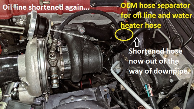

I shortened the 4-AN oil line and used an OEM hose separator clip from "the other" water heater hose to the oil hose to ensure that the hose does not move and rub anything:
Routing the oil line on the engine side frees up space on the other side of the turbo for the new A/C lines.

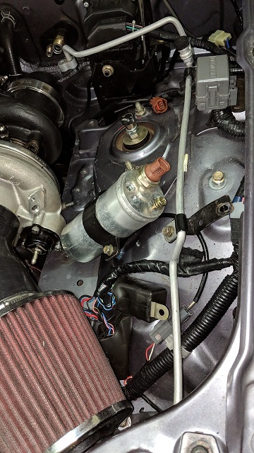

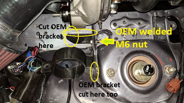

I originally planned to re-mount the A/C Receiver/Drier cannister in the rear passenger corner of the engine bay but it's awkward to fit in there so the only other obvious place was near the air filter.
I modified the OEM bracket and mounted it using an OEM M6 point on the frame that has an M6 nut welded on it:
* I'm hoping I can unfurl the OEM wiring so that the plug can reach the cannister's 2-wire socket (the brown connectors in the photo above), if not I'll need to lengthen the wiring.
I also fitted the rear section of the TSE downpipe.
Dann held his downpipe using a simple DIY bracket mounted to the gearbox and a 3" exhaust U-bolt.
Unfortunately I can't use this same bracket because it's right where the two TSE sections join, they're slightly wider than 3" and require a clamp to hold them together.
For now it's just supported by a jack so I need to see what others have done to support the downpipe.
