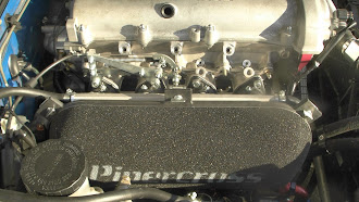

ITB's

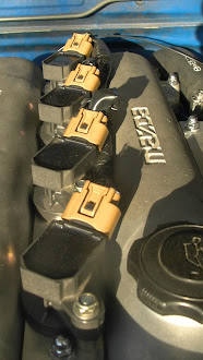

COPs

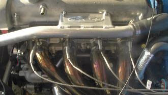

Exhaust, Coolant re-route and Exhaust gas temp sensors

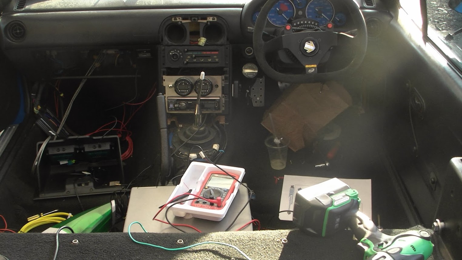

Cabin

Almost all the Innovate hooked up, just 3 more sensors to go (steering, brake pressure, fuel pressure). However, the RPM still needs to be done and it looks like the oil/water temps may not be working, however I'm not running the car for very long.
Also the VBox is almost all installed, it will now be easier to take it out and put it back in when needed. Tomorrow is some of the single warning alarms to be installed, more wiring...

Well today most of the wiring is done. Low or no coolant will trigger a 100 db alarm as well as a warning light. Oil/water temp, set to trip at 120c have been wired up, however not sure if they work... Also installed 2 air temp sensors, one in the mouth of the car and another on the air filter. So all the innovate ports used once the last 4 sensors are installed (steering, brake/fuel pressure and TPS).
Tomorrow is clean/tidy up and possibly install a high brake/rain light.
