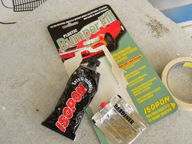

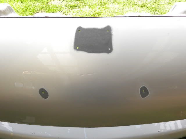

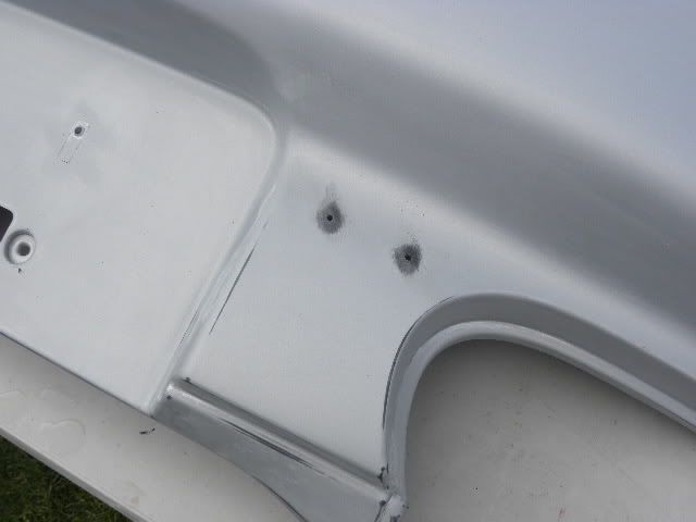

decided to buy some plastic bumper fill from the ;ocal auto shop to fillin the holes from the removal of the badges from the rear bar. cost of the filler $20

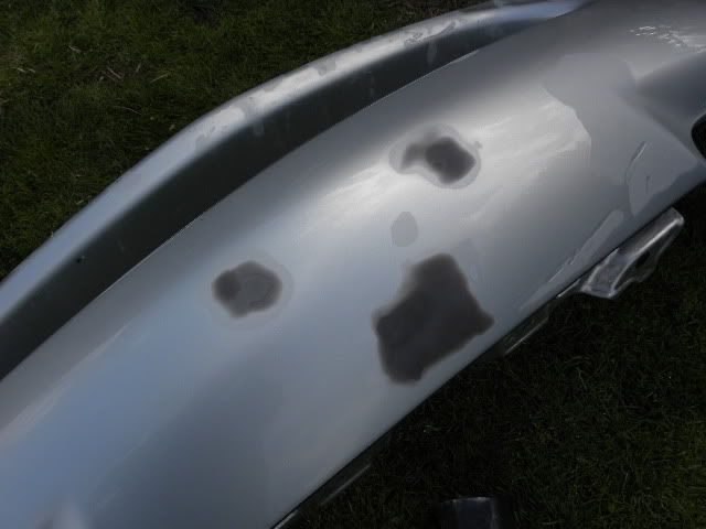

the bages left 2 holes either side of the rear number plate location

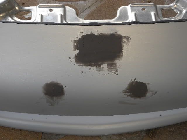

using 120 wet/rub sandpaper i created a rough surface for the filler to set
filler area completely rubbed out and cleaned thoroughly with grease/wax remover
the mix is a 2 parts. theres a filler and hardener. to mix a stip of filler the add small amount of hardener. takes about 20 minutes to dry. it was the wet sanded with 320grit

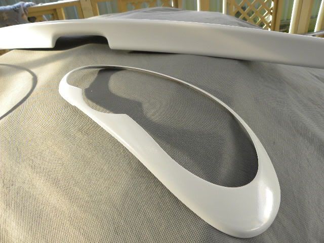

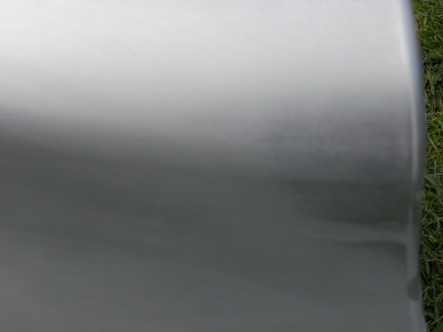

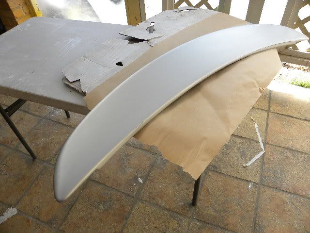

too cold to go further on the rear bar repair so instead i wet sanded the rear spoiler and coated it with plastic primer. that's it for today

rear bar badge are filled and sanded

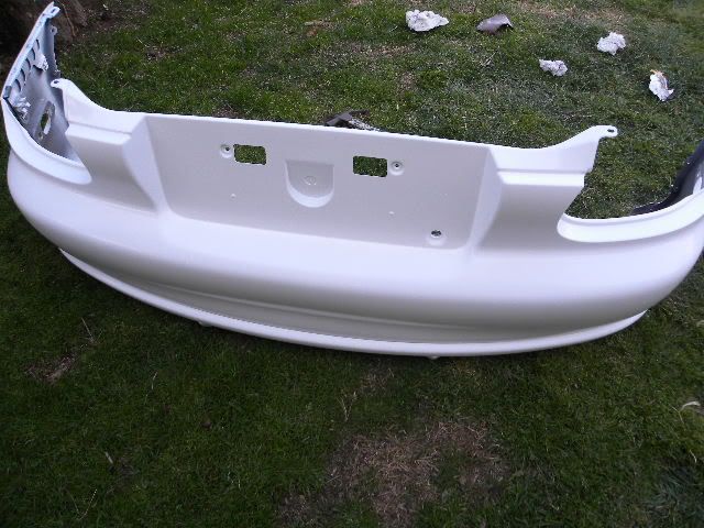

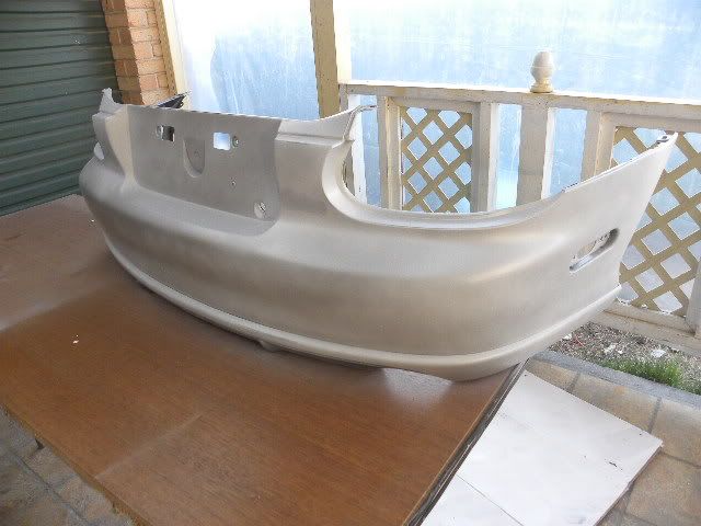

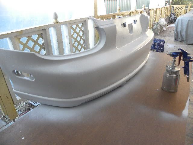

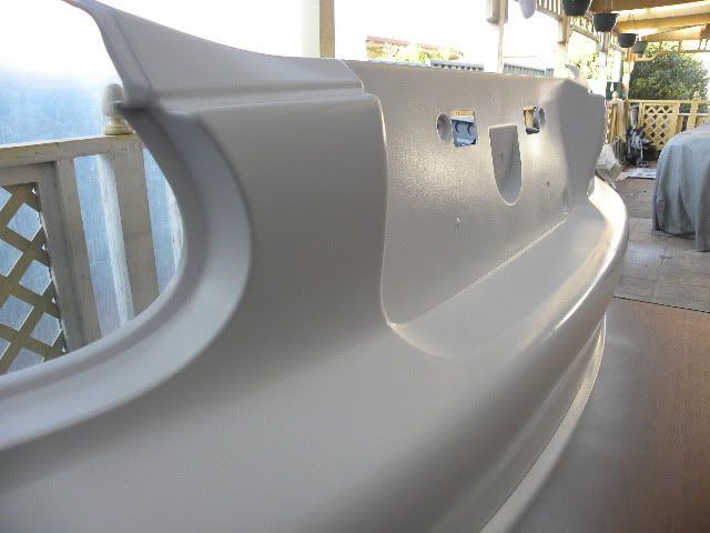

rear bar - first up wet rubbed with 320 grit sandpaper. then cleaned thoroughly with grease/wax remover. several light coats over a one hour period with plastic ptimer. two hourly dry period then 1st of 3 top coats applied

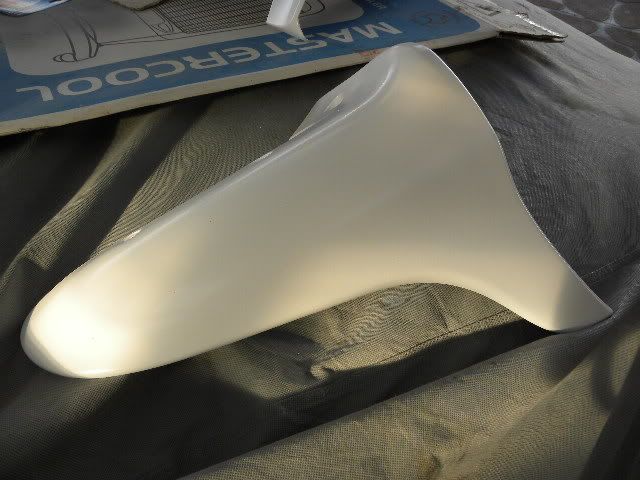

followed on by the large rear mud flaps. as above
next up was the rear headlight covers and spoiler
pretty close to final top coat

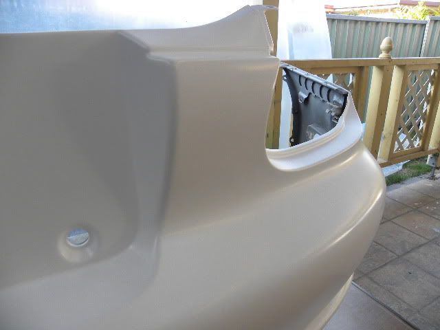

left and right repair areas where the badges once sat
rear bar completely sprayed -less top clear coat

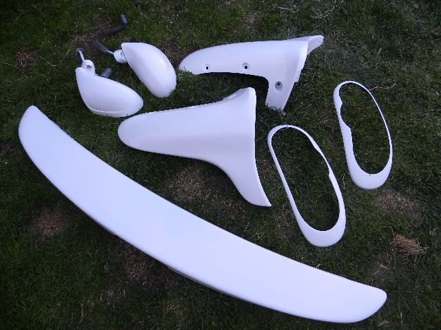

mirrors - tail light covers - mud flaps and spoiler
tomorrow it's the final clear coat and rain is in the area for a few days with lower temp. i plan to re-assemble car from the rear -foreward

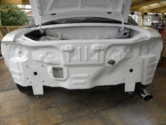

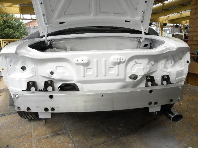

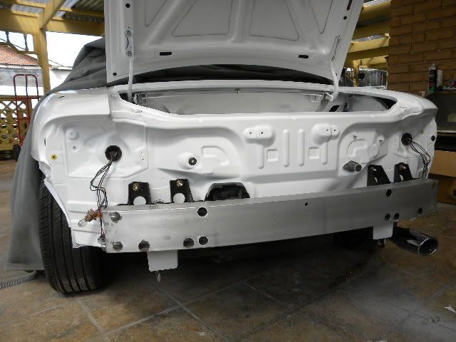

too cold to paint so it's re-assembly on the rear
rear impact bar bolted on
plugs and light fittings

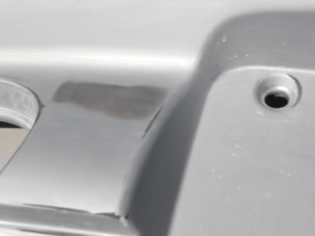

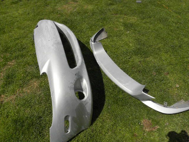

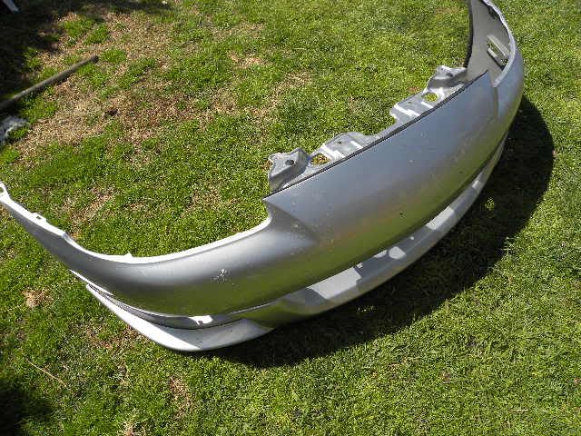

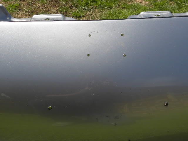

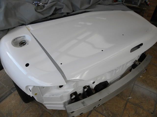

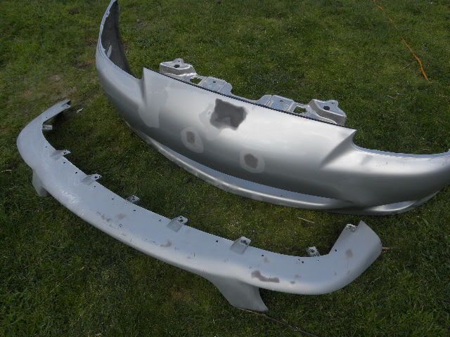

front bar removed from the car. bottom removed and both parts wet sanded with 320 grit sandpaper
even after 2 complete rub downs - you could clearly see an area of clear coat was completely missed. if you leave it on following a spray. it will be in this location your paint work will lift and all your hard work is history

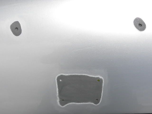

6 holes in total for the fill. 4 from the factory mazda badge and 2 from the dealer from the plates

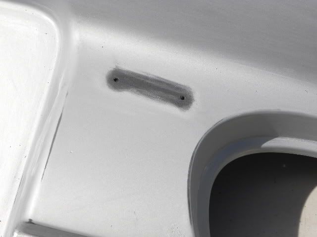

up top i decided to wet sand 120 grit 4 holes iinto 1 and below these number plate holes were left as they were
filler on
pretty hard to sand it off. i started with 220 wet and ended with 360
job completed and ready to clear coat
with a bit of luck weather wise - will clear and top coat tomorrow
filler on
