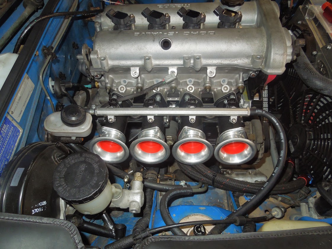

ITB shot, fuel rail done. Waiting for injector plugs and LB01 bracket. Fuel regulator (including pressure sensor for data logging) installed, final resting place to be determined. Airbox still to be determined Danny and Jason have some ideas so the Pipercross may not be used after all, however the coolant overflow will be relocated to the hot side of the engine bay. COPs installed.

Well not much of an update, however the airbox is being swapped out for an air dome style filter whilst a decision is made on brake booster delete/pedal pivot point change. The dome filter is 65mm high so it will fit and the top of the dome will be 25mm above the trumpets. It also means that I may be putting a NACA duct into the bonnet to get some cool air to the ITB's. However if the NACA duct goes into the bonnet the dome filter will become the permanent solution and a Pipercross airbox will be up for sale.
The ITB throttle bracket and injector bungs should be here tomorrow and since I'm not home again till 06/11/13 with luck it will be ready to be dríven (after I pay the bill) :)

They came from Competition Systems. The bungs plug the original injector holes in the head as they can no longer be used once the ITB's go on. Jason's plan is to tap these bungs and use them for idle air control. I should have ordered these in January when I ordered the ITB's.
