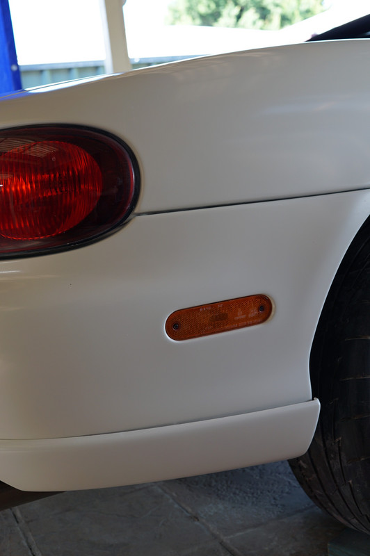

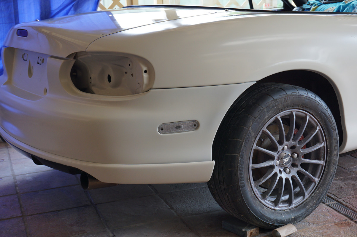

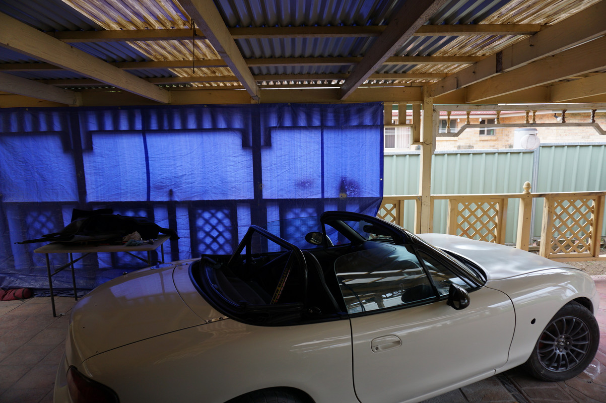

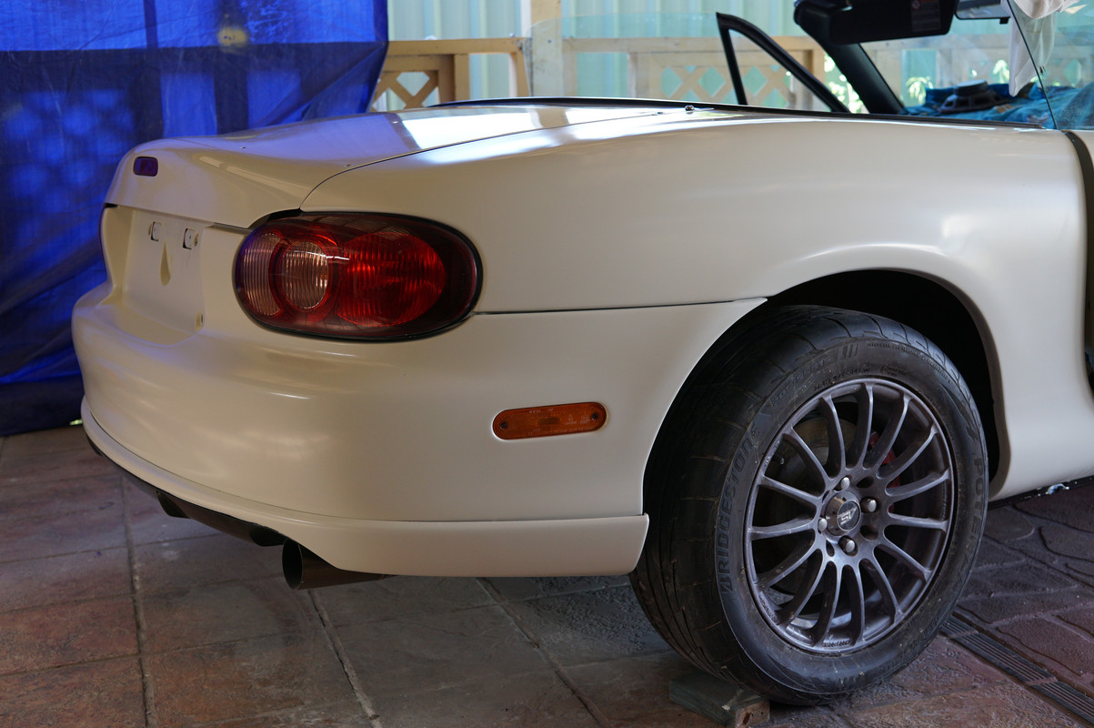

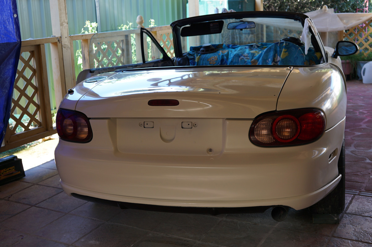

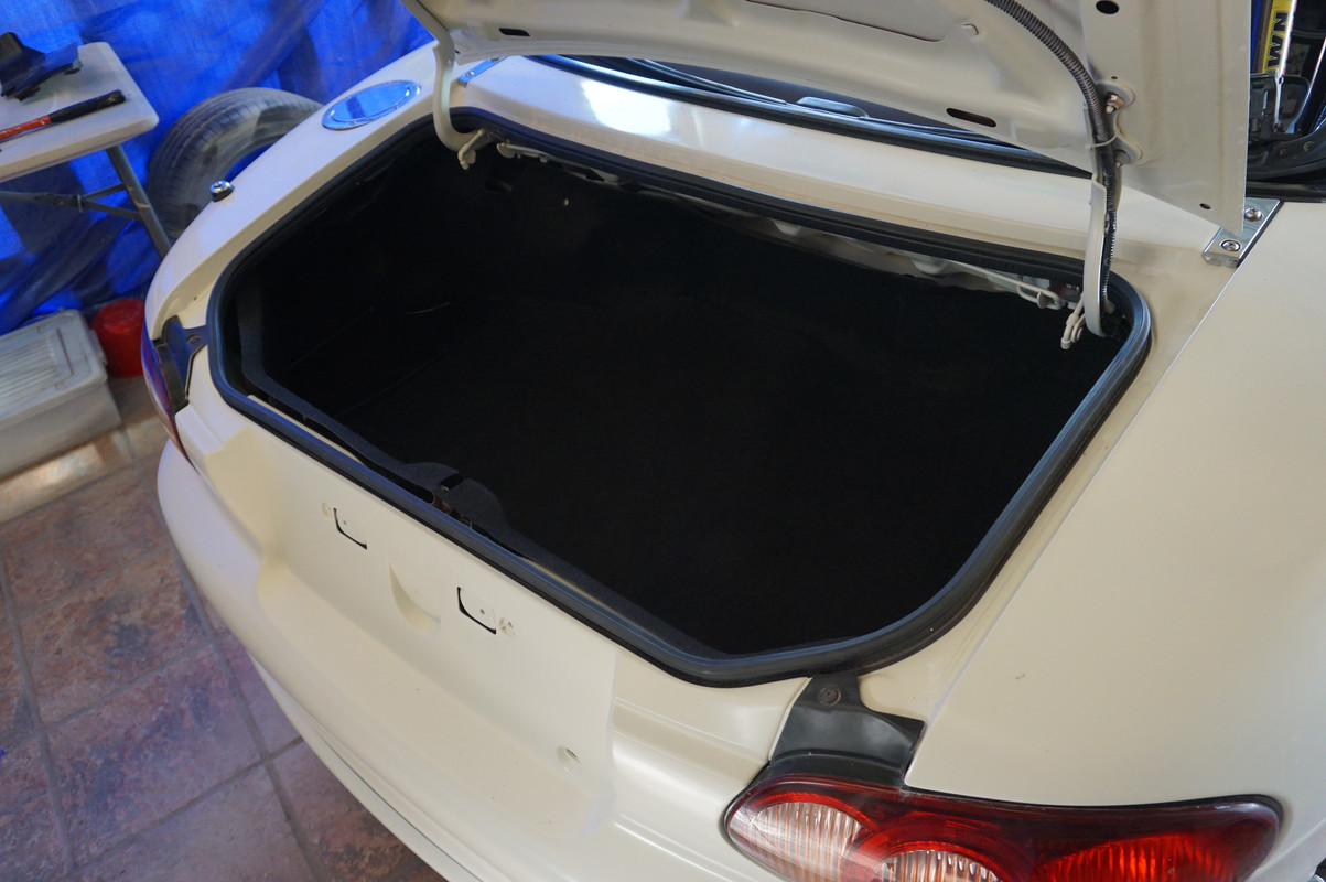

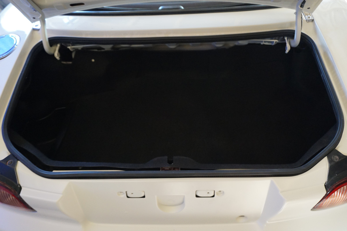

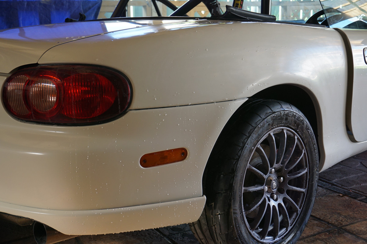

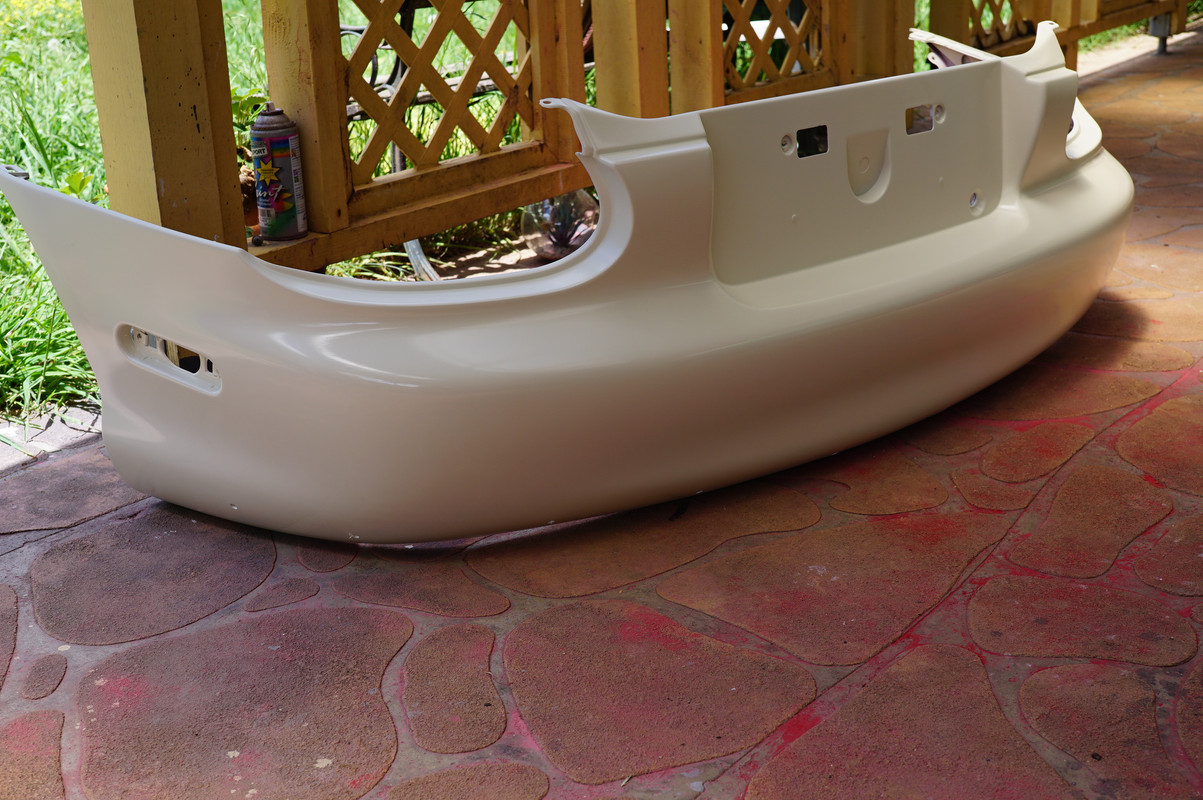

i knew i couldn't get away with this job so I pulled the rear bar off and got to work giving it a light wet sand with 800 and let dry. wiped it over with grease and wax remover and by then the temp was up to about 18C and perfect for spraying .
gave both sides a bit extra paint too :lol:
sat it aside to dry and afterwards i had to do a few slight repairs to the side brackets which clip the molding to the body. worked out fine
gave it about 3 hours to dry and then slapped it back on the car :lol: and while at it fitted the rear tail lights

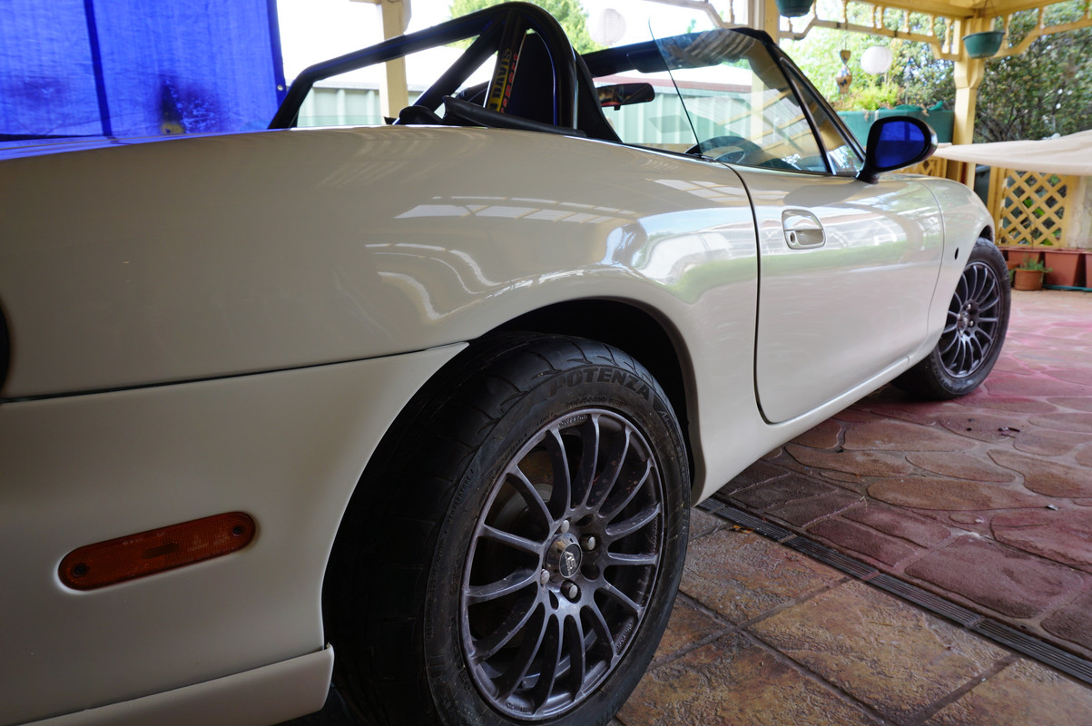

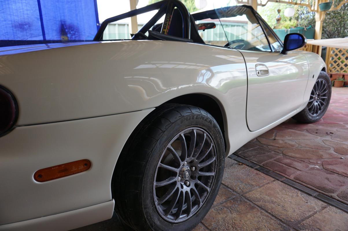

yesterday when i was spraying in 24K :lol: and was a bit tight with the paint

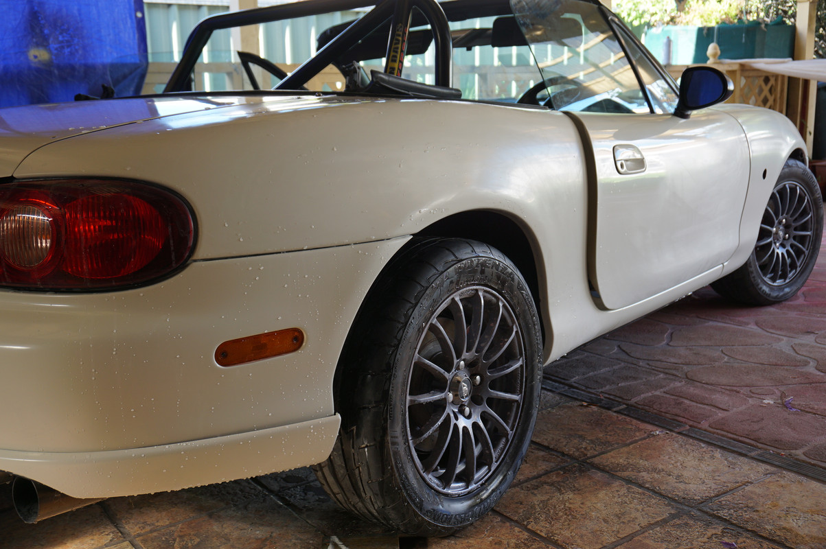

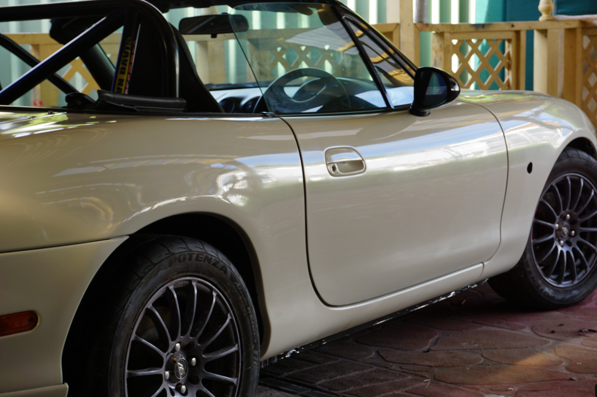

side shot
and today
so I think it was worth my time to go back in and do it properly and it wouldn't have happened if I had done it right in the first place :lol: although the wife did say it looked fine -how would she know :lol: but I knew :roll:

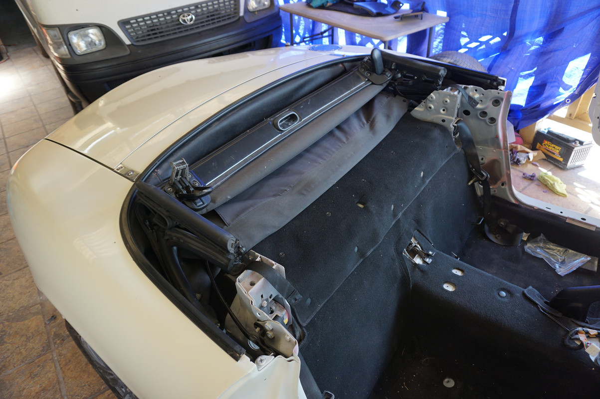

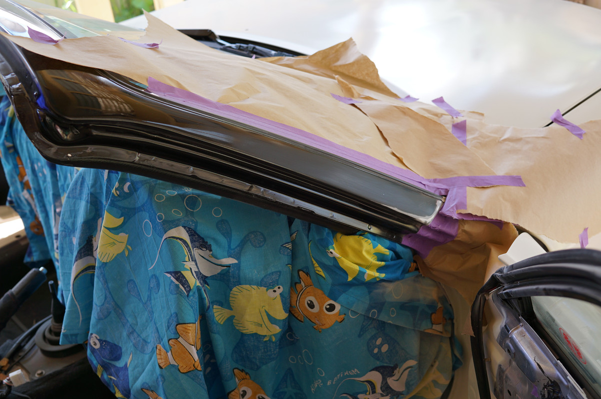

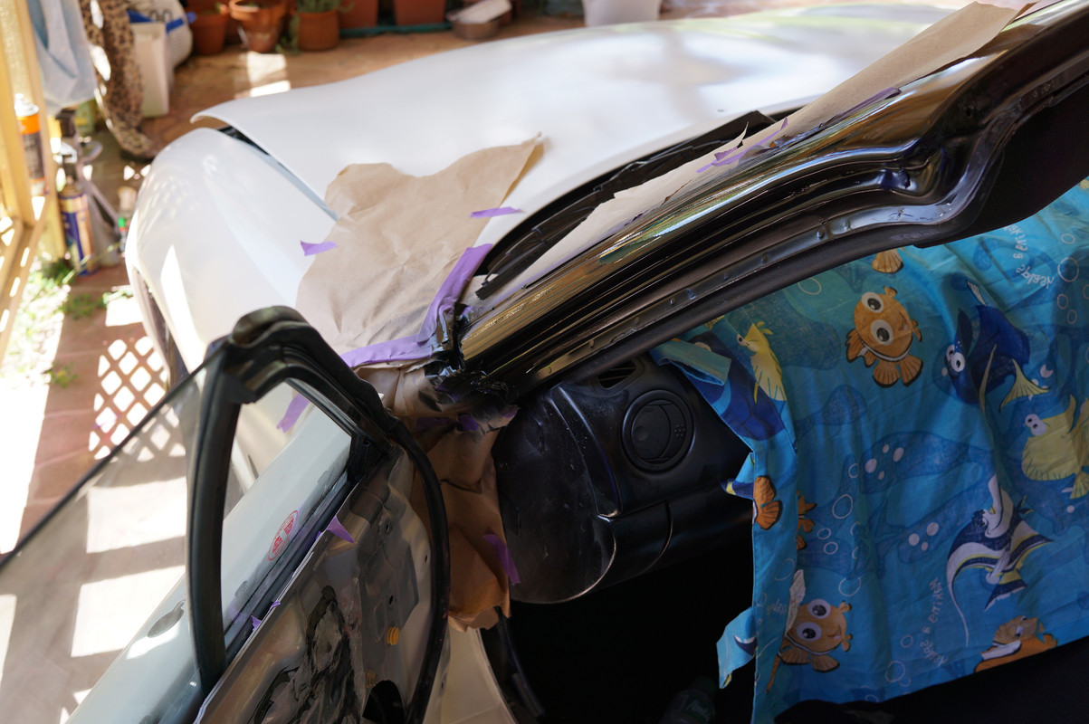

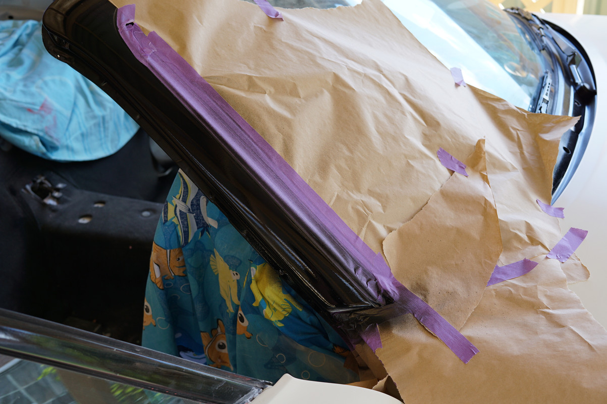

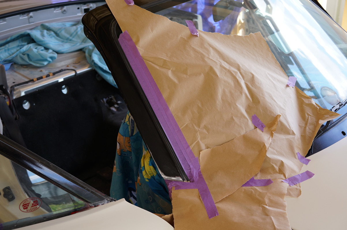

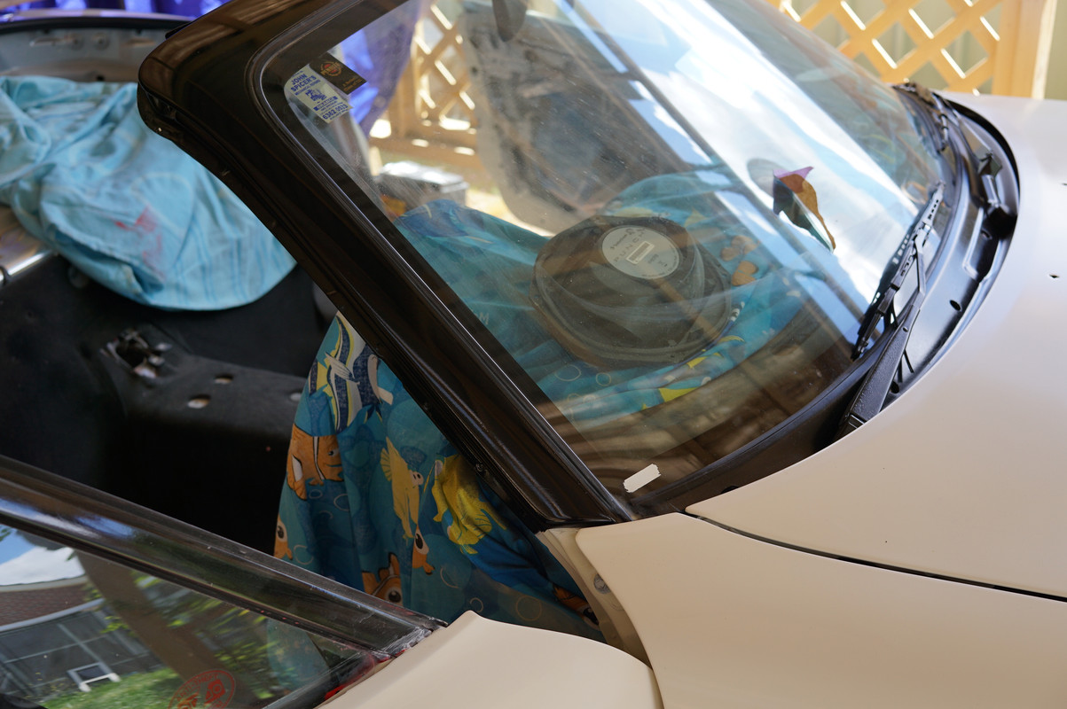

either side of the windscreen had suffered a bit from sandpaper scuffing so I rubbed both back with 800 and re done them - much neater now

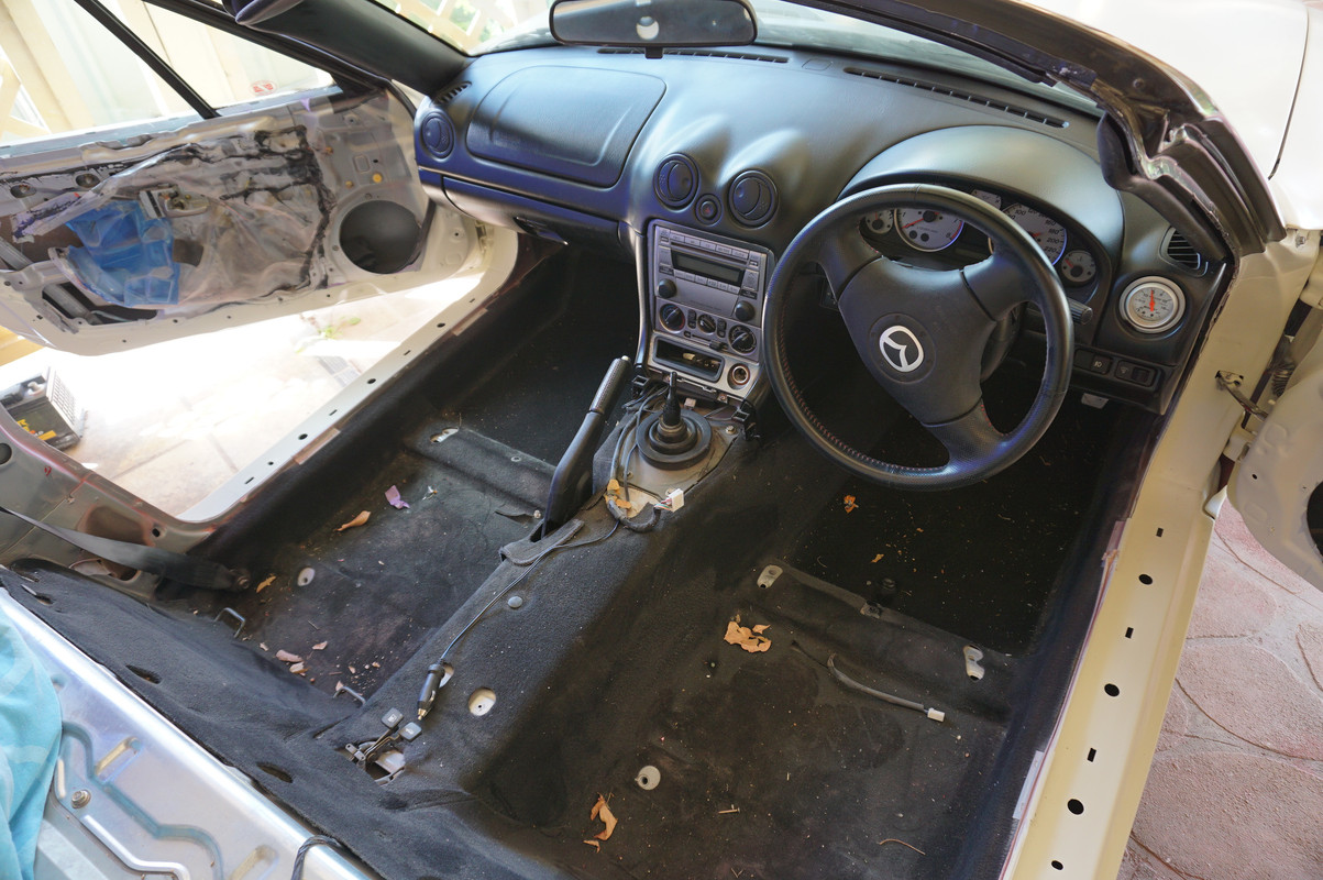

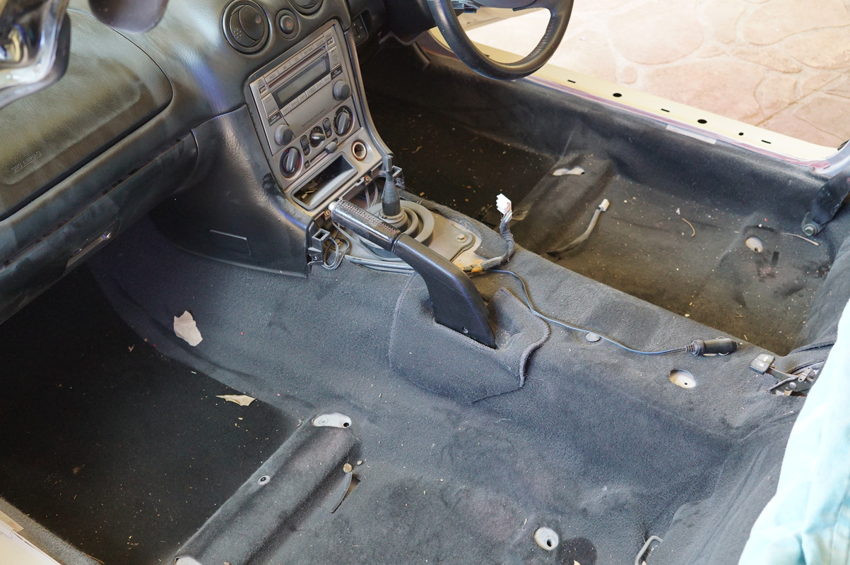

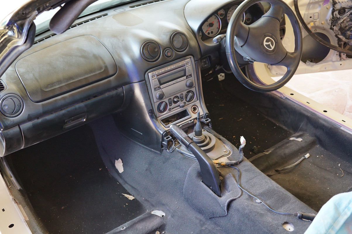

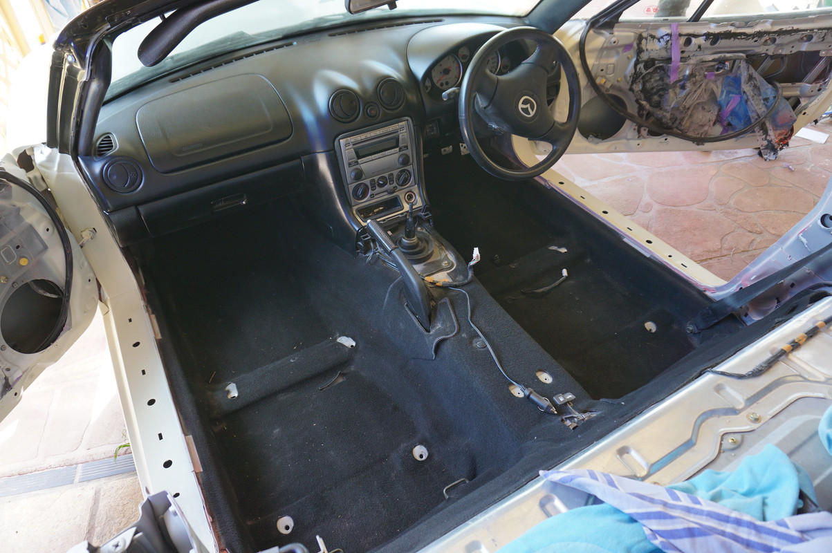

then decided to pull the covers off and the interior was a bit dusty
even picked up a few stray leaves :lol:
the vacuum cleaner tidied it up some

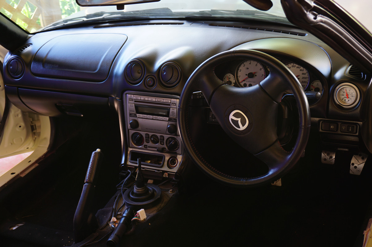

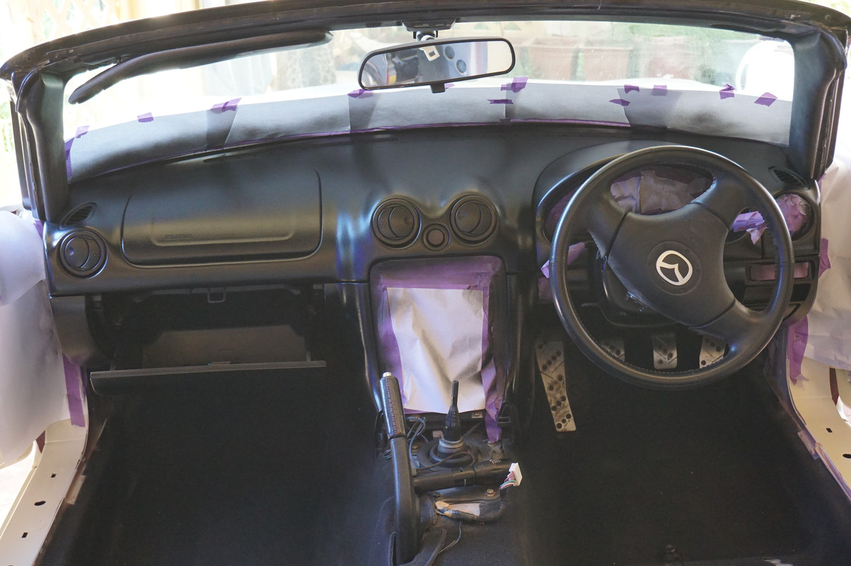

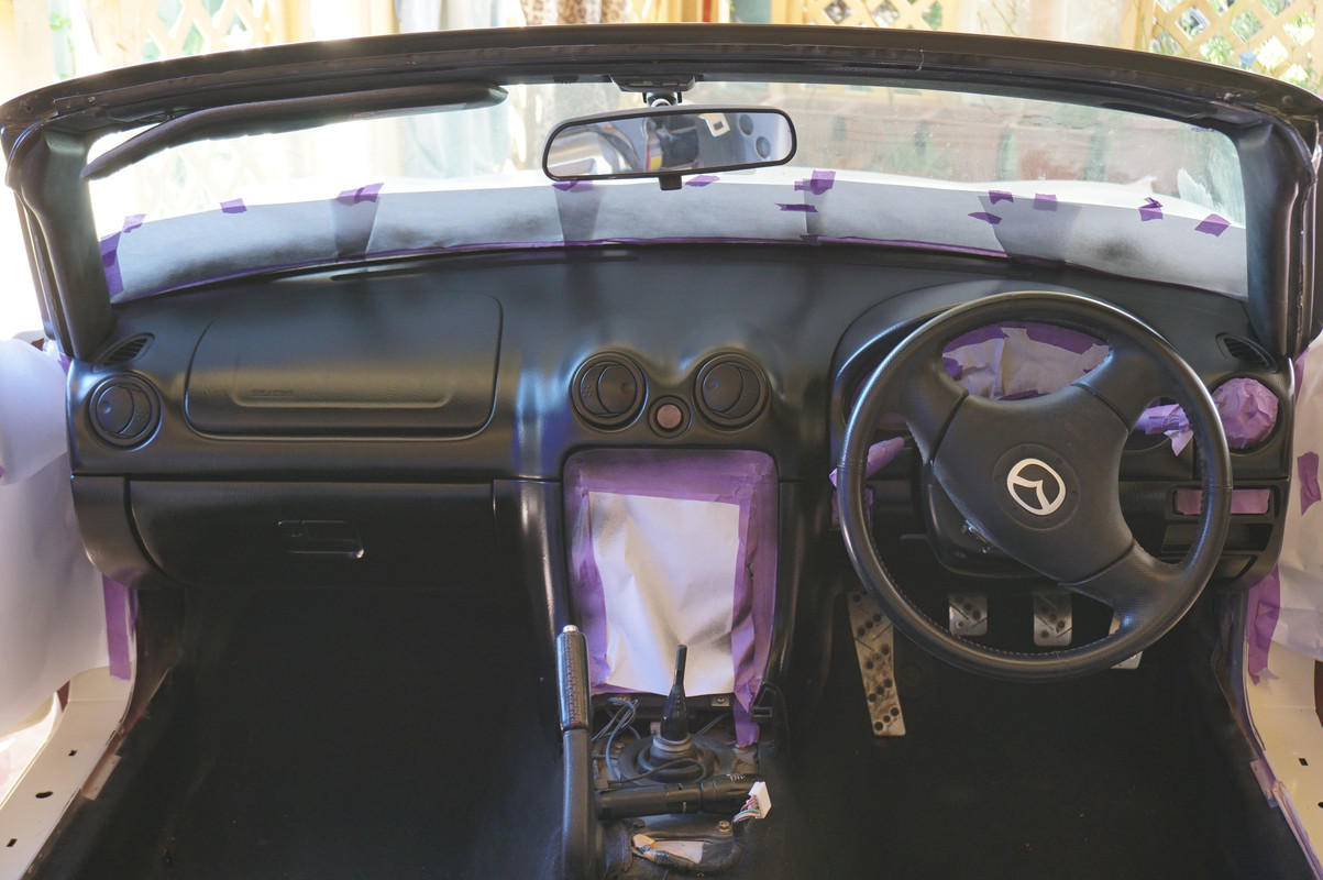

so I decided to mask it all up and go for a dash re-spray too - coat 1.
here's coat 2.
coat 3 and day over

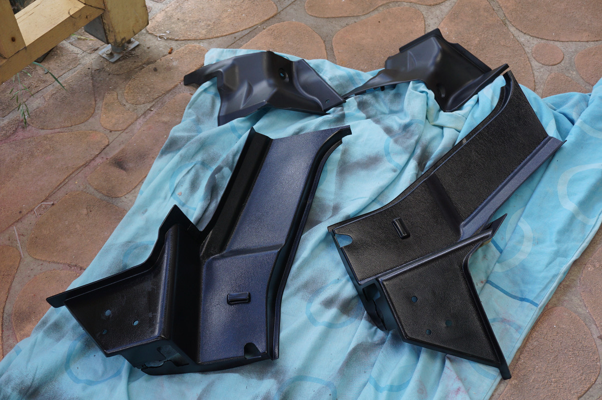

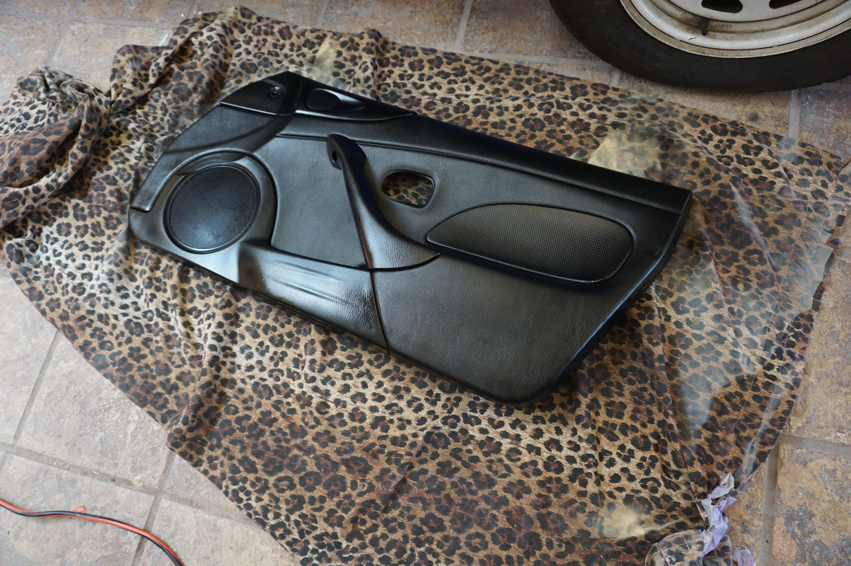

earlier I had re-painted the other plastic parts with vinyl dye
brown/davis roll bar back in
re-sprayed all the boot carpet with carpet dye

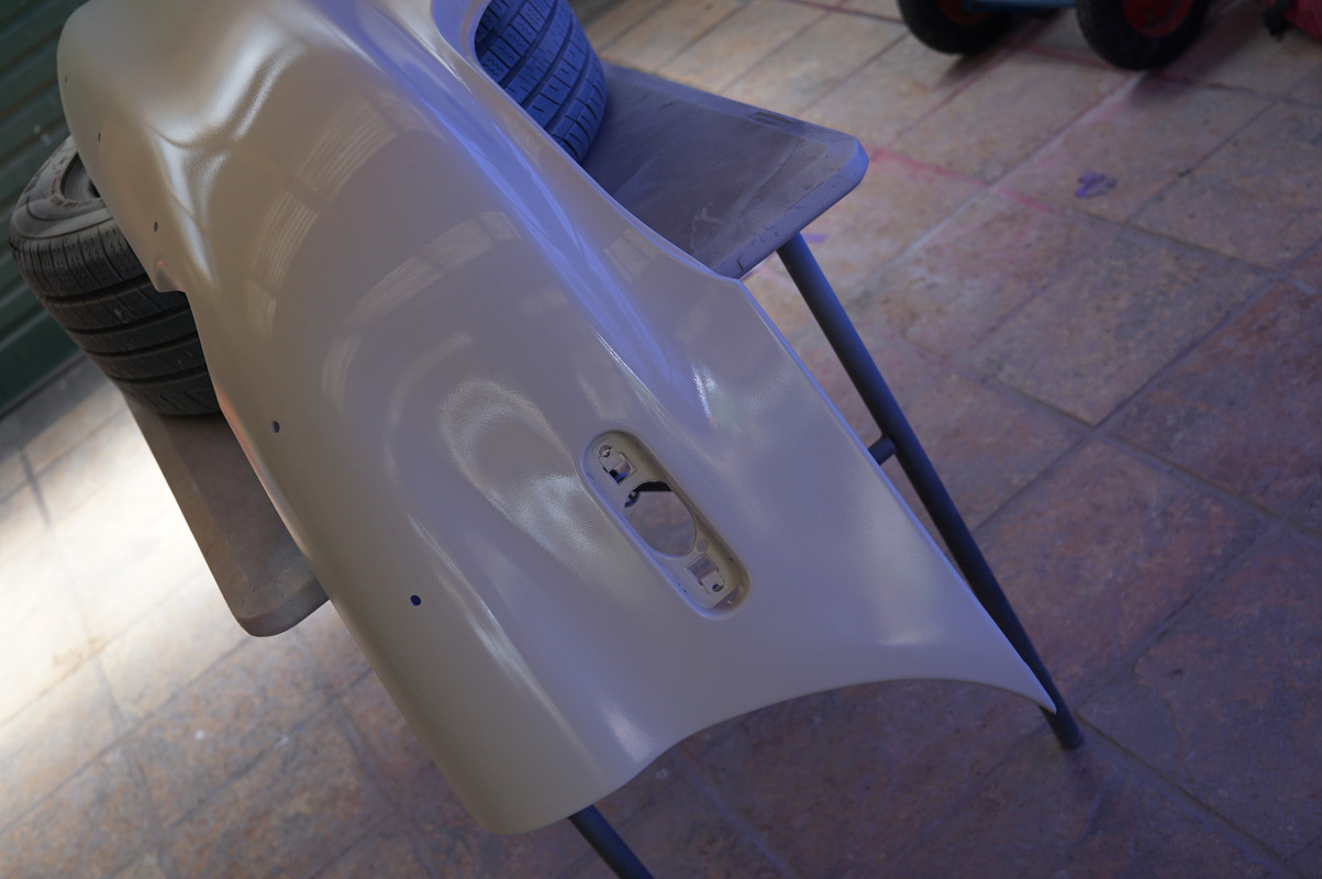

then I took a look at this panel

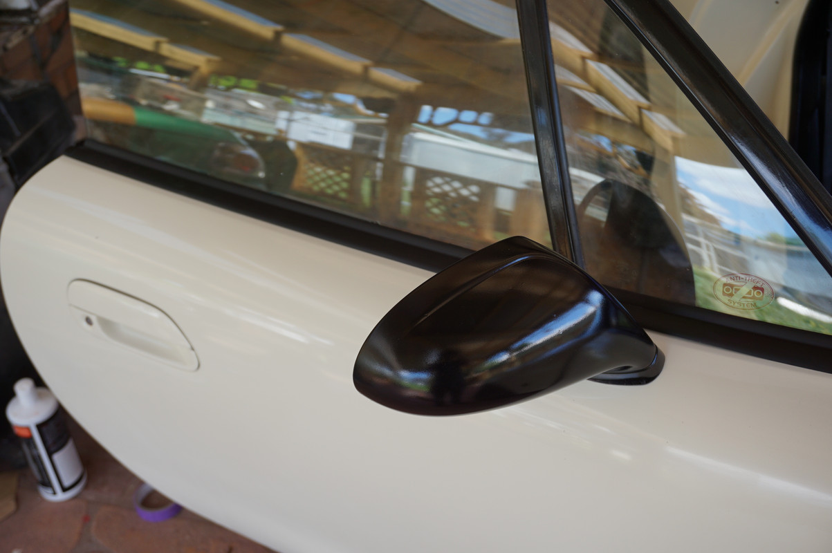

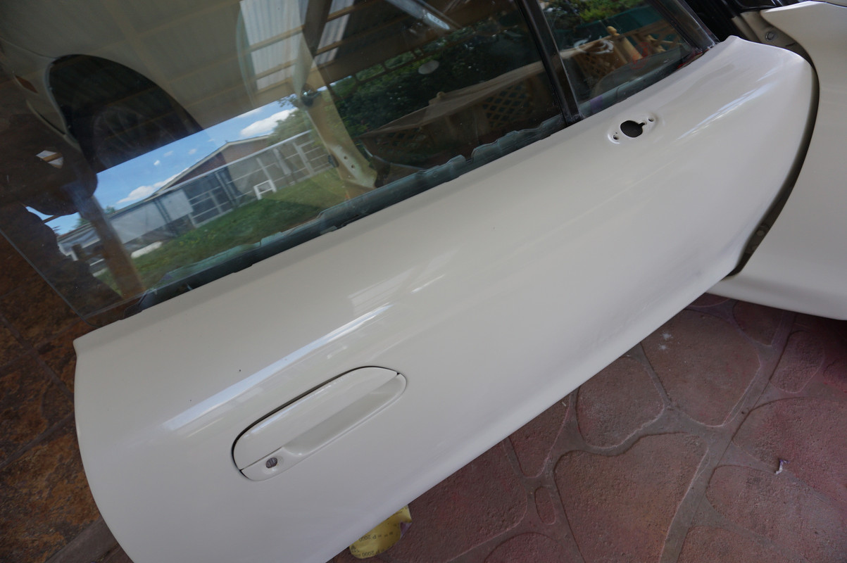

decided this time to rub it out with 2000 wet - rear bar not touched
then use the cutting compound via hand rub
this is going to look really nice when complete BUT too much work to waste on a mazda :lol:

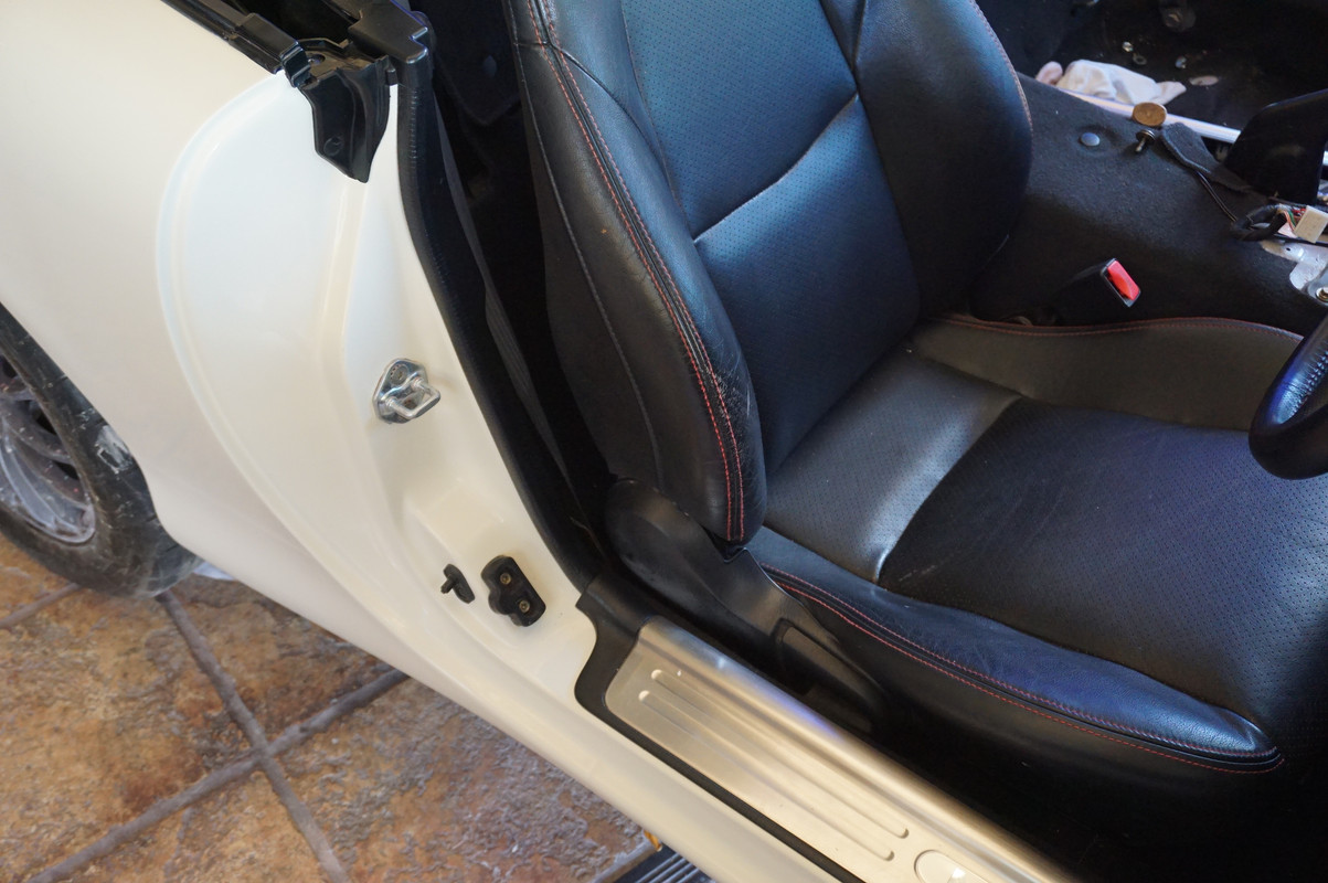

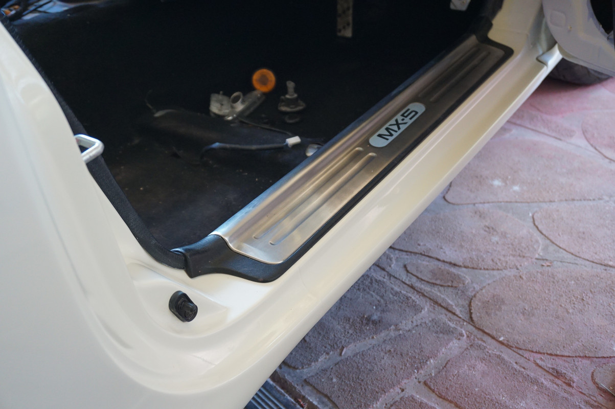

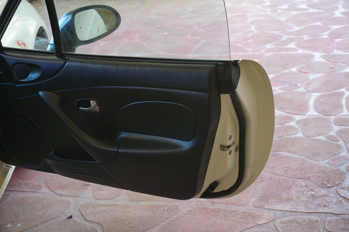

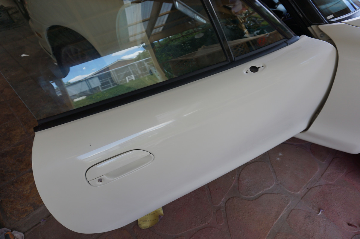

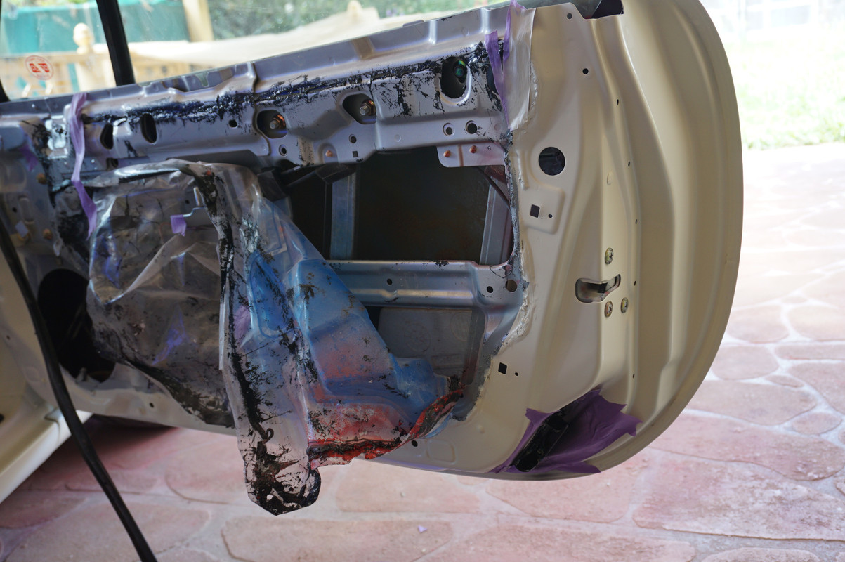

started on the drivers side door jam and hand cut the inner areas and fitted the scuff plate
painted the striker plate black and fitted the stereo speaker plus hand cut the inner door area
re- dyed the drivers side door trim

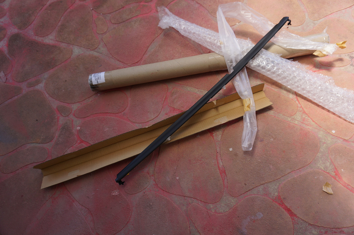

new door to window seal arrived
prior to the fit
fitted
rubber seal fitted and door trim on
drivers seat back in and air bag lead connected. then ignition on to check right side speaker is working ok - all good

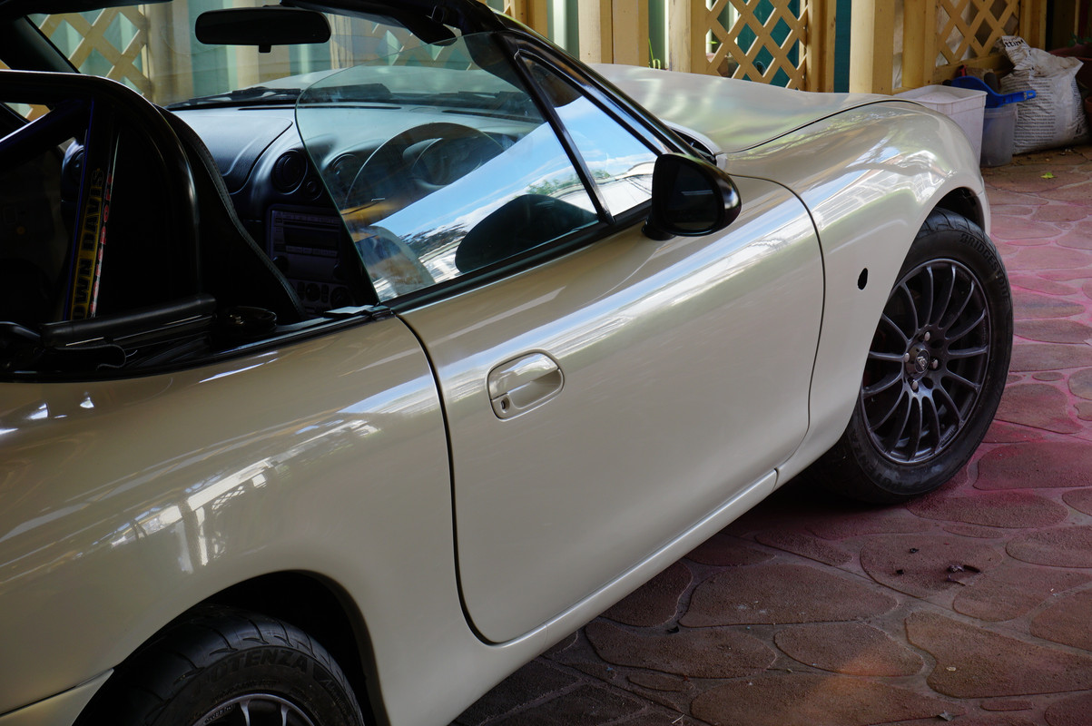

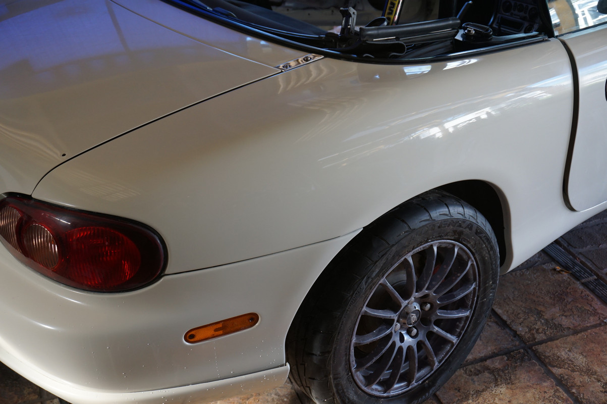

right side of car rubbed down with 2000 wet
all good and day over
Postby billybunter » Tue Oct 24, 2017 5:48 pm

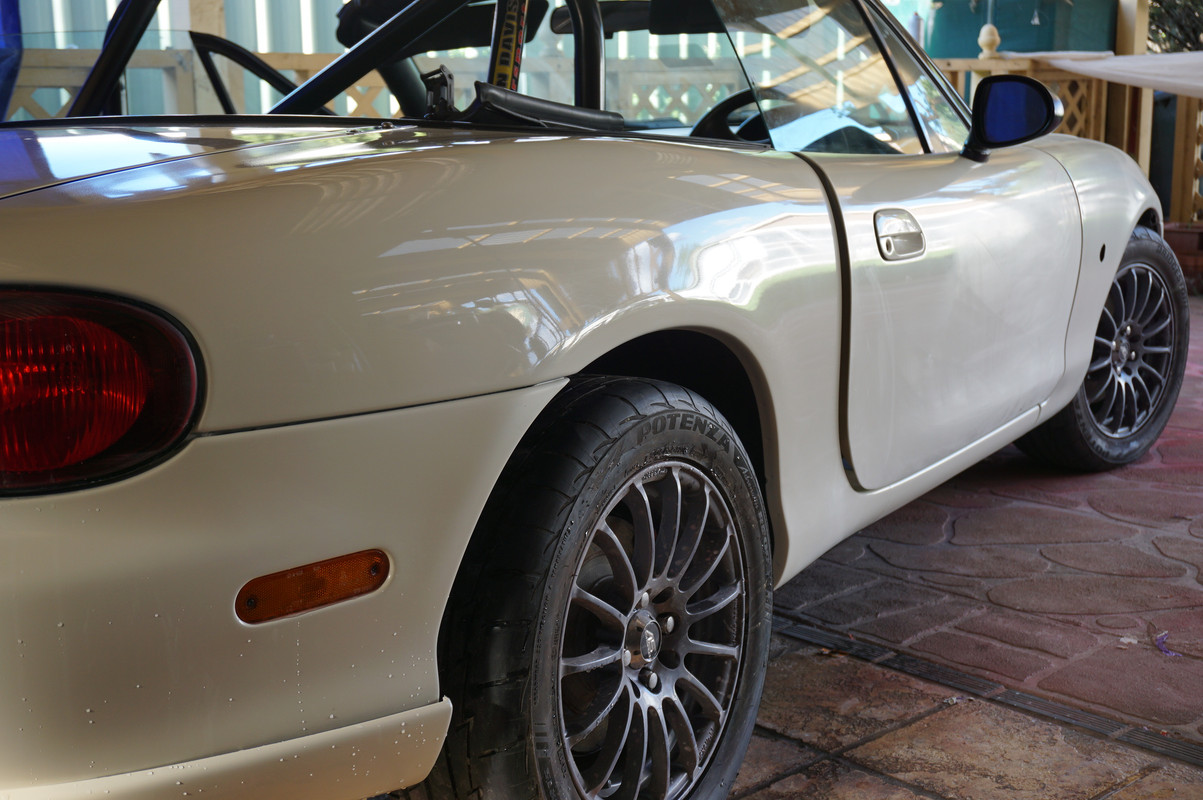

a couple of closer shots of the cut polish on the car and remember its only been hand cut but not polished yet, i'm really impressed with the results considering I've been clear coating everything for 15 or 20 years
my opinion would be now -the clear is a long way behind it

Postby rascal » Wed Oct 25, 2017 1:12 pm
Can't wait for some shots of the car in sunlight.
The current shots under the verandah make it look like its painted beige... :shock:
Postby billybunter » Wed Oct 25, 2017 5:56 pm
yeah ... I know :lol: it's suppose to be polar white. I think its from reflections from the verandah. looks a bit whiter straight out the door
