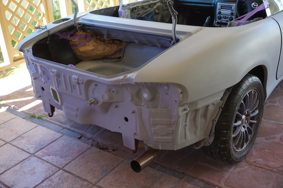

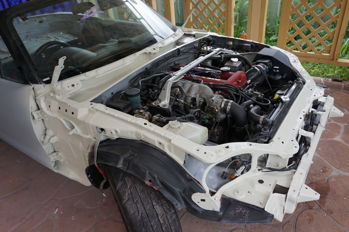

DAY 15

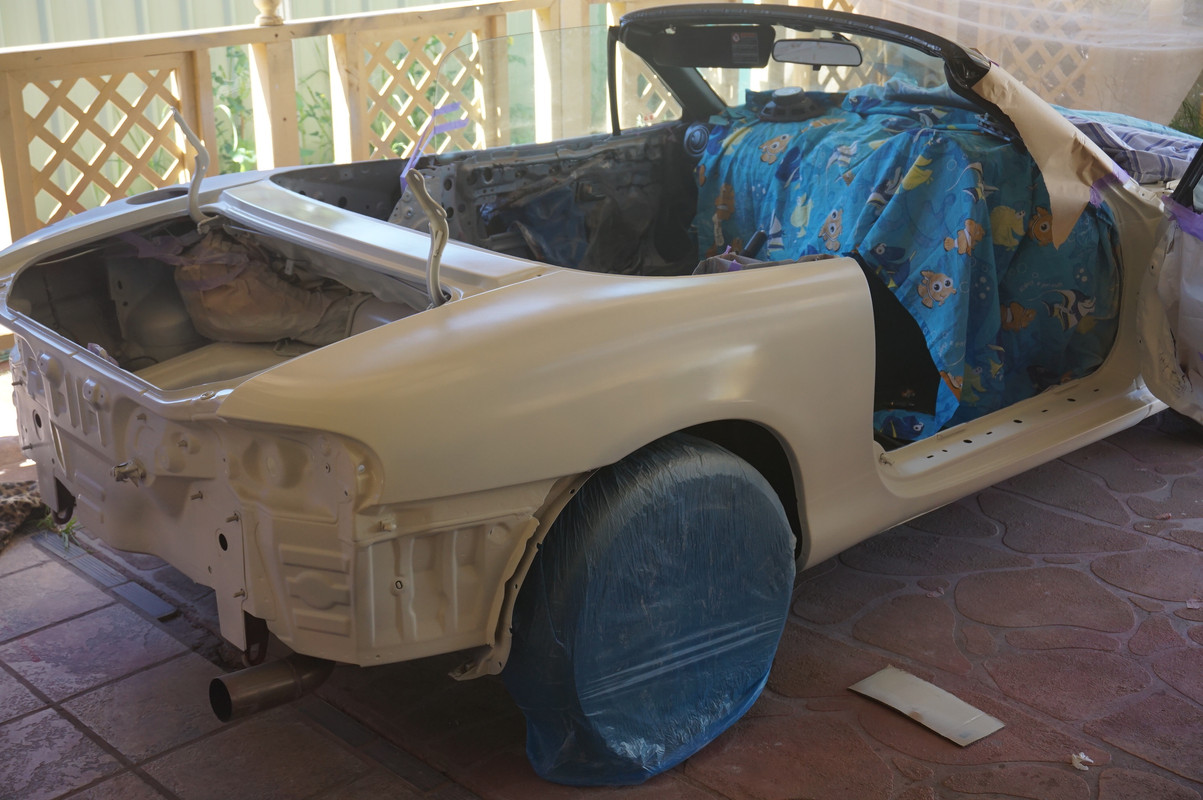

put about 3 hours in today...so clocked in an hours overtime :lol: this rolling tub is now completely primed. I will be heading in the direction of both front guards/boot lid and bonnet and then the plastics ..front and rear bars
as usual removed the door clips and broke one. I will be chasing a plastic door trim support
pretty tight area to work at the best of times

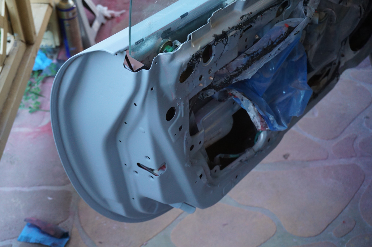

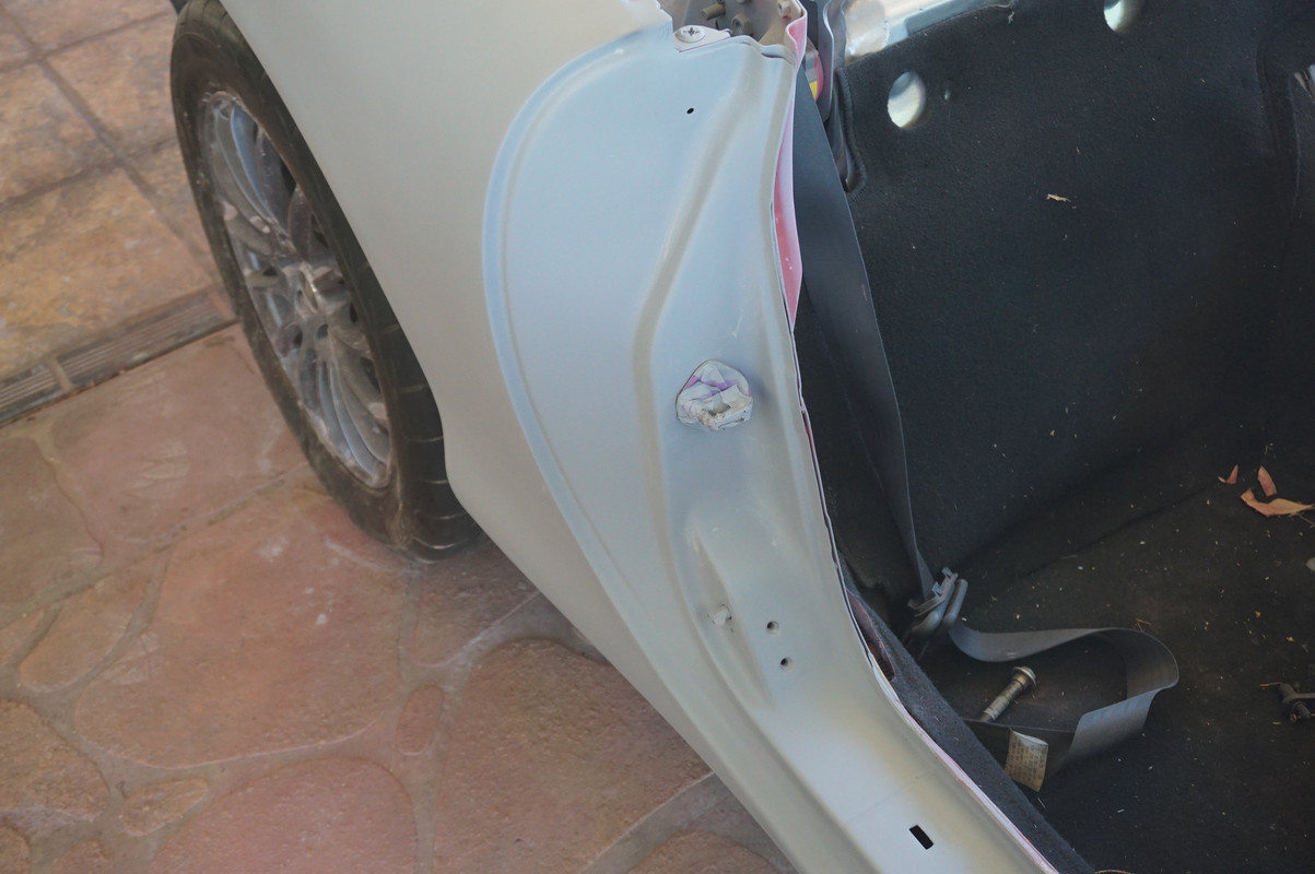

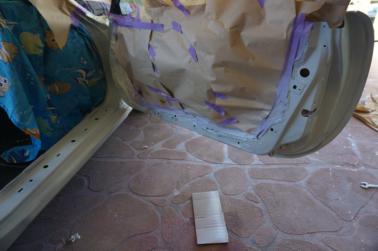

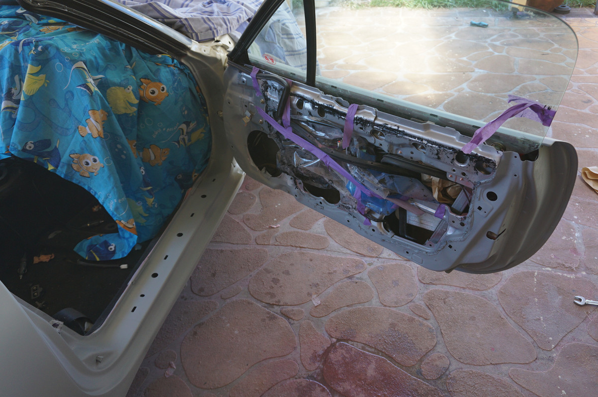

had to completely wet rub out this door
then the masking up
door primed

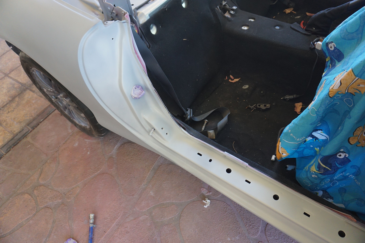

exterior door
body sill
day over

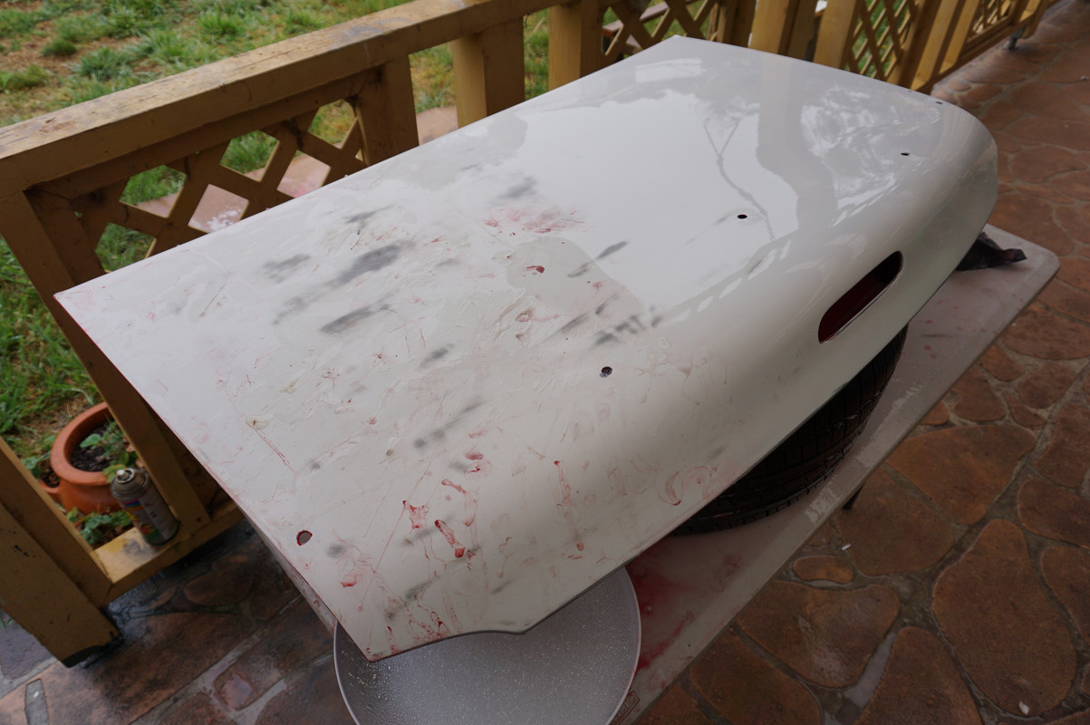

Postby billybunter » Sun Oct 08, 2017 4:59 pm
DAY 16

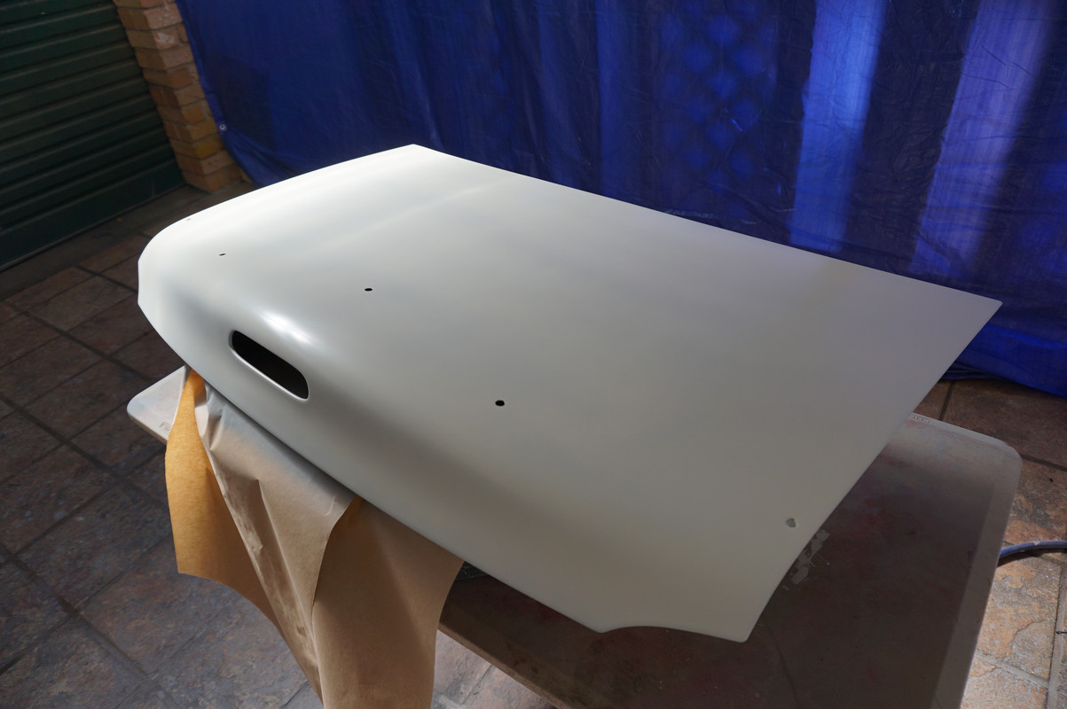

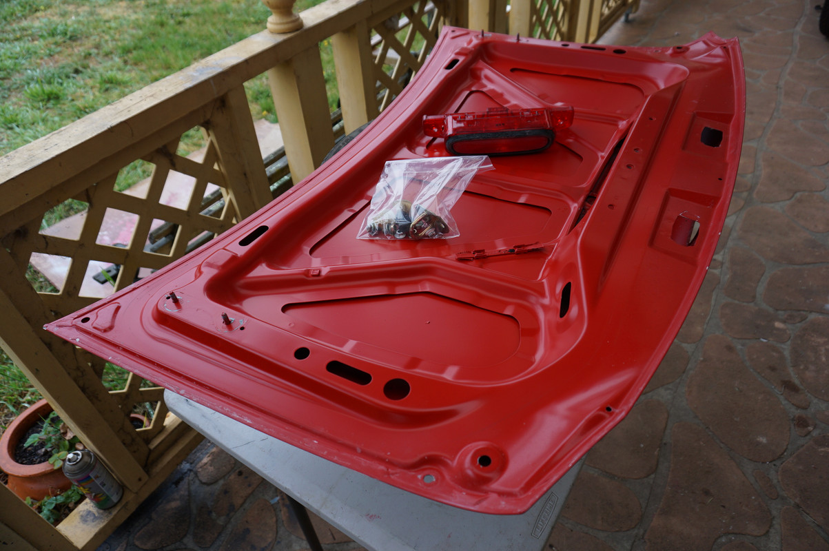

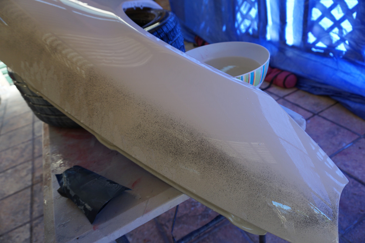

boot lid. pulled all the hardware off and bagged it

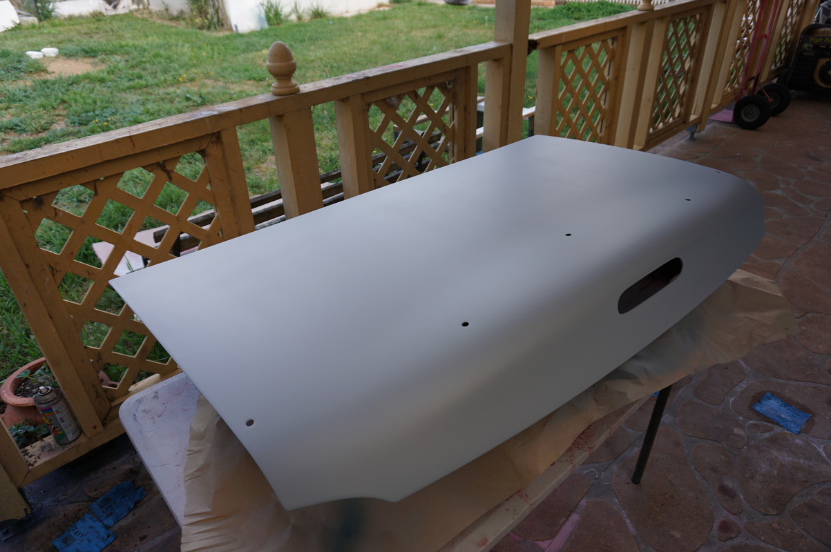

then rubbed it all out with the 400, best of all no clearcoat involved
top of the lid was still show a bit of scaring from the 120 cut sand
here I cut the boot with 240 and then down to 400
that's about it for today-boot finished and its raining so no priming today

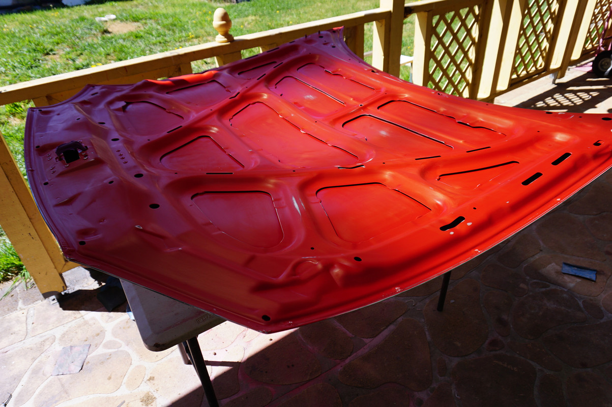

Postby billybunter » Mon Oct 09, 2017 4:56 pm
DAY 17 probably 3 hours work today
weather was good so I got straight into it and prepared the boot and primed it and its now complete

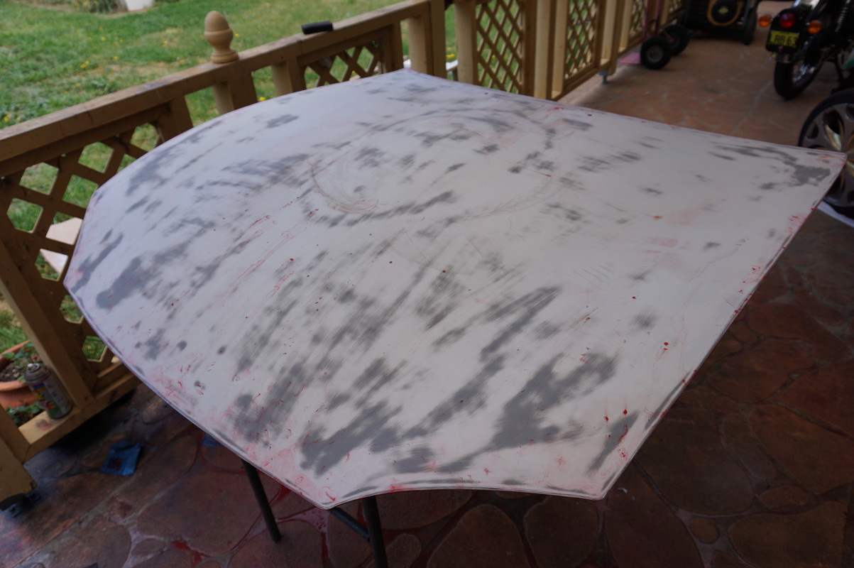

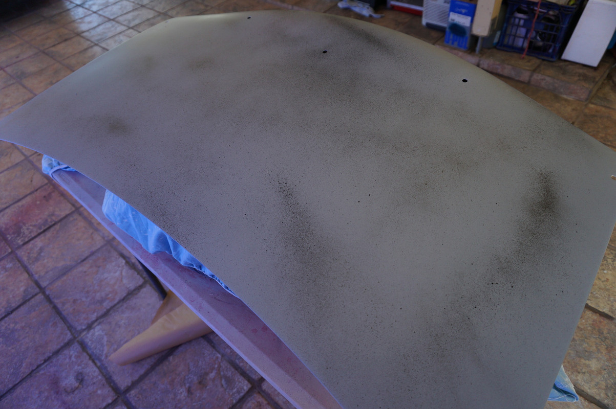

so I then decided to give the bonnet a bit of a going over
wet rubbed a fair bit of colour off the underside of it :lol:
flicked it back over and ran over the rough spots with 240 wet first
then finished off with 400 wet
day over

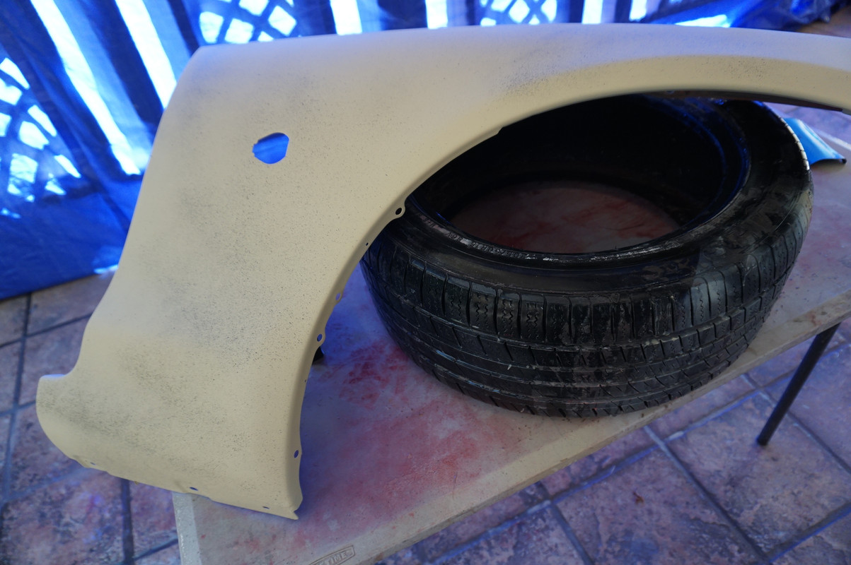

Postby billybunter » Tue Oct 10, 2017 3:20 pm

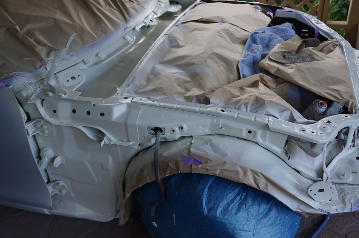

DAY 18 -about 3 hours

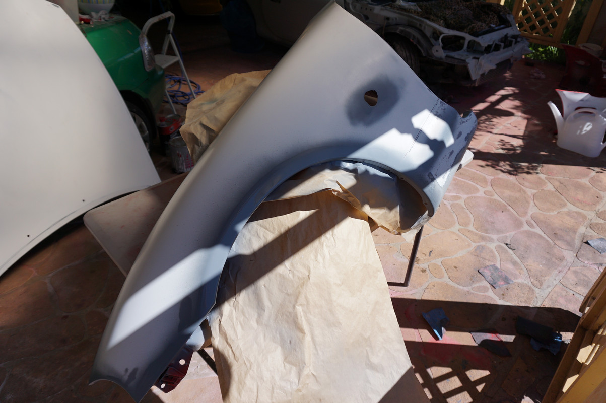

etch primed both front guards and then waited about 30 minutes and primed both
guards now complete

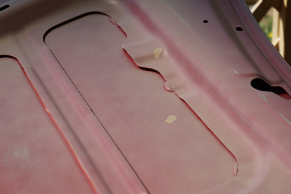

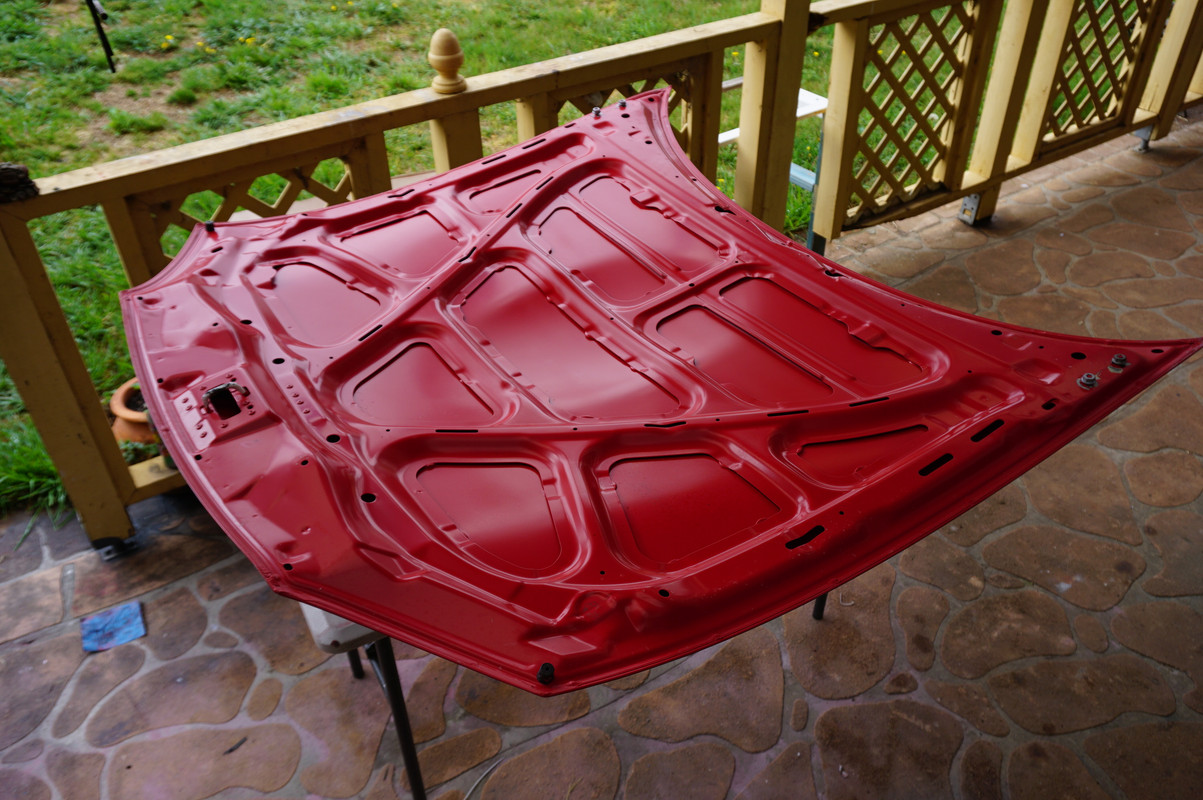

started priming underside of the bonnet
paint pot not on tight enough and tossed out a few drips or spirts of paint. had to stop work wait 15 minutes rub it out and go again
meanwhile I removed the pot-drained the paint-cleaned it out and tighten it down. could have save a bit of work if I had kept an eye on it
then continued on with the underside spraying
flipped the bonnet and etch primed the edges
wait 30 minutes for it to dry and primed
day over

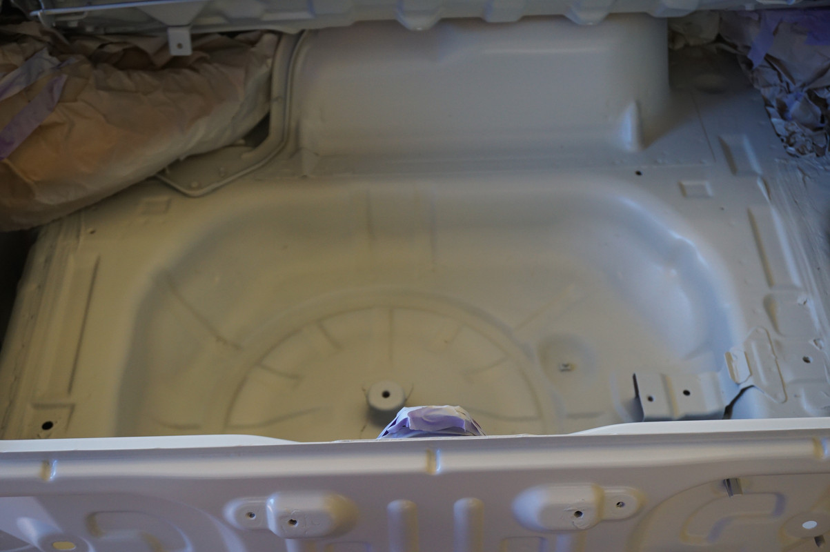

Postby billybunter » Wed Oct 11, 2017 6:01 pm
DAY 19 - 4 hours

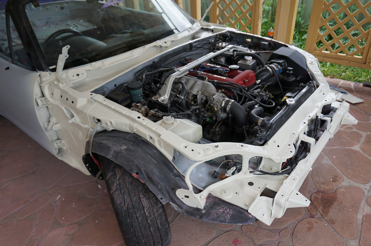

started the day with a heavy mask off of the front end
then primed then hit the underside of the boot with the new colour "POLAR WHITE" from the 68 XT GT FALCON ERA

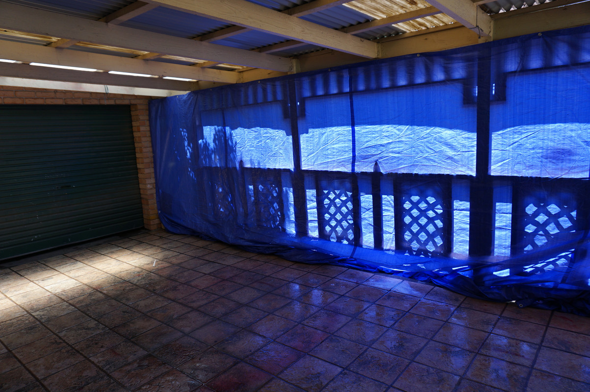

I then decided to hose down and set up the tarp under the verandah

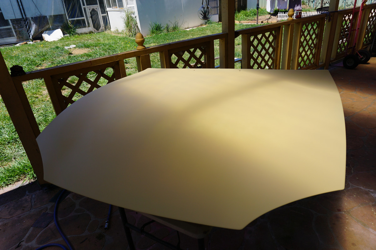

I put a couple of the top coats on prior to a rub down with 800 wet
I wouldn't say I was 100% happy with the polar white and it didn't look the same as I recalled 50 years ago :lol: and I was down $320 on the paint. so I bought another litre of paint and added it to the mix. I thought not another re-paint and I've only just started :lol:
so it appeared to lighten the colour a bit so time will tell

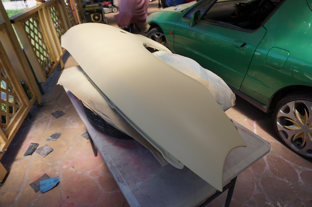

DAY 20 4 hours
after working on a few areas I decided late today to go straight out and lay several coats of paint on the boot and let it dry overnight and tomorrow I will cut it back with 1500 wet and polish it out and see exactly if I have the Westinghouse or kelvinator colour or if I don't like the colour at all - I will abort! :lol: so today went something like this but not in sequence
guide coat on boot for the rub out
rubbed out
top coated

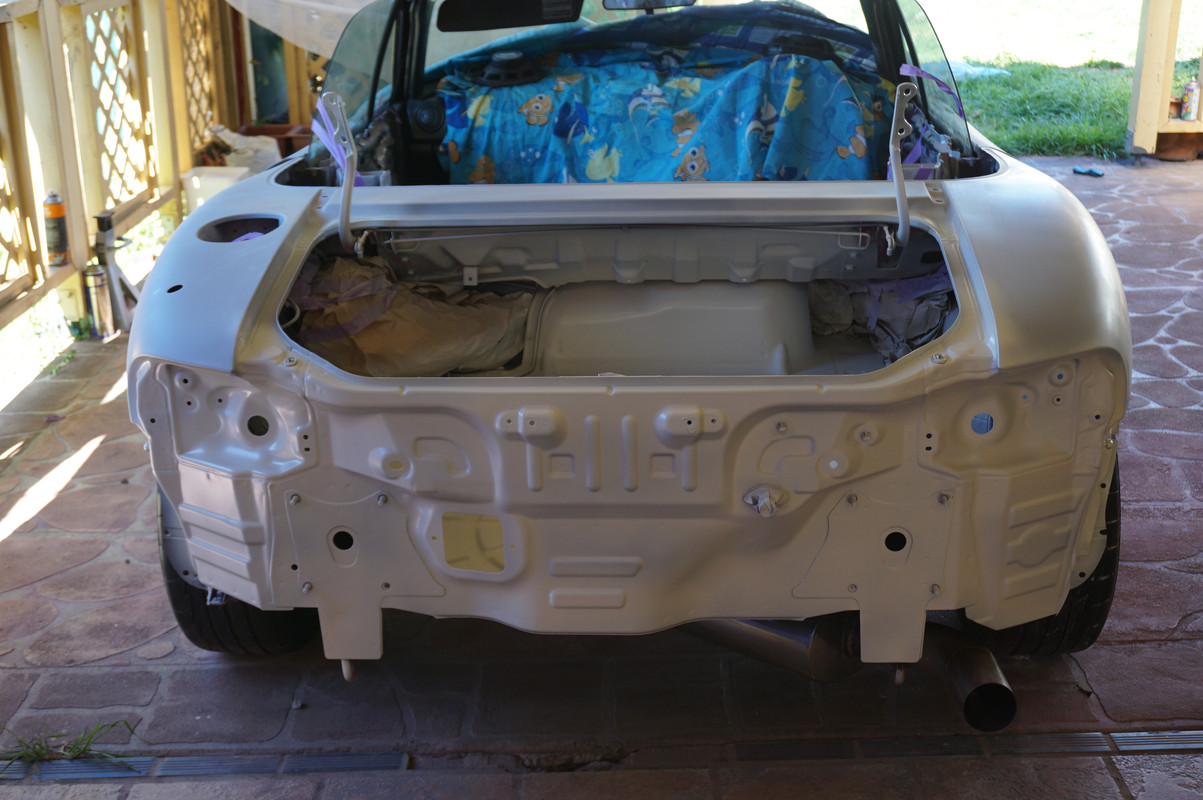

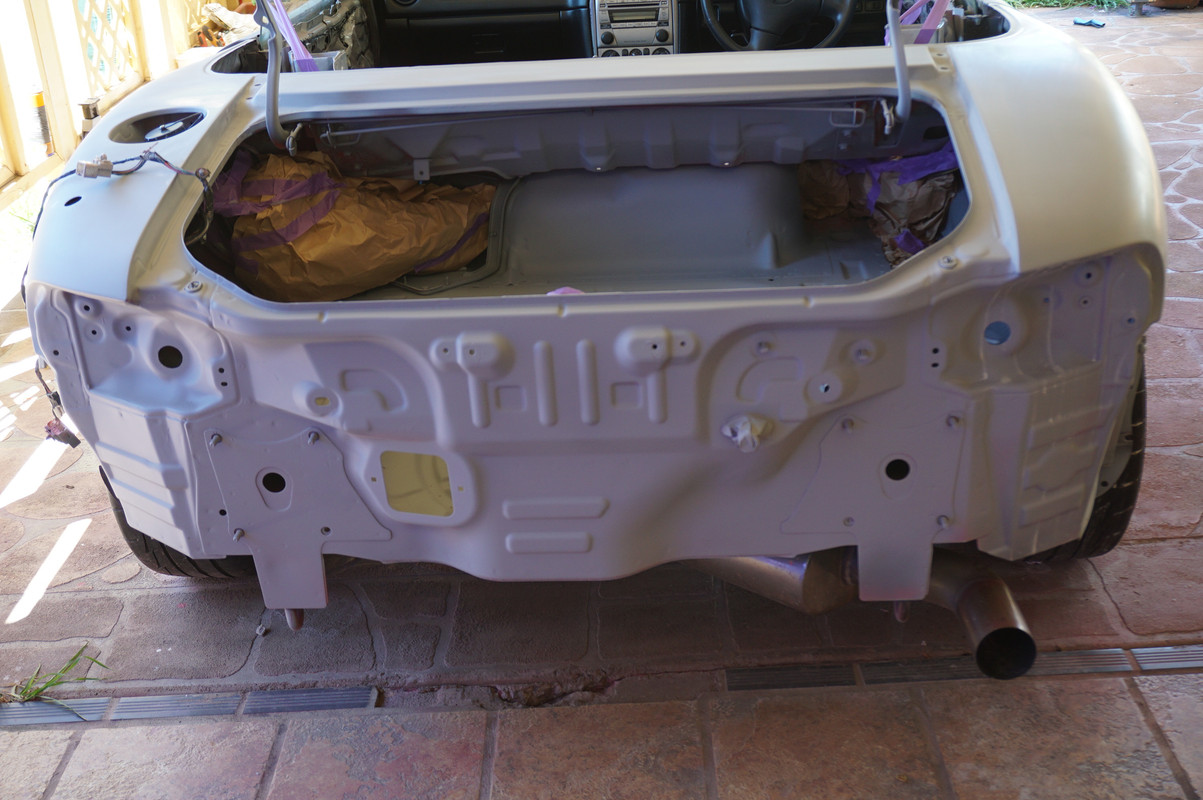

rear end
pained
both front guards
guide coat prior to the 800 wet rub
completed
same with other guard
day over so if the colour doesn't come up to expectations its a lot easier now to jump ship cut my losses on the paint and try again :lol: before a complete spray.

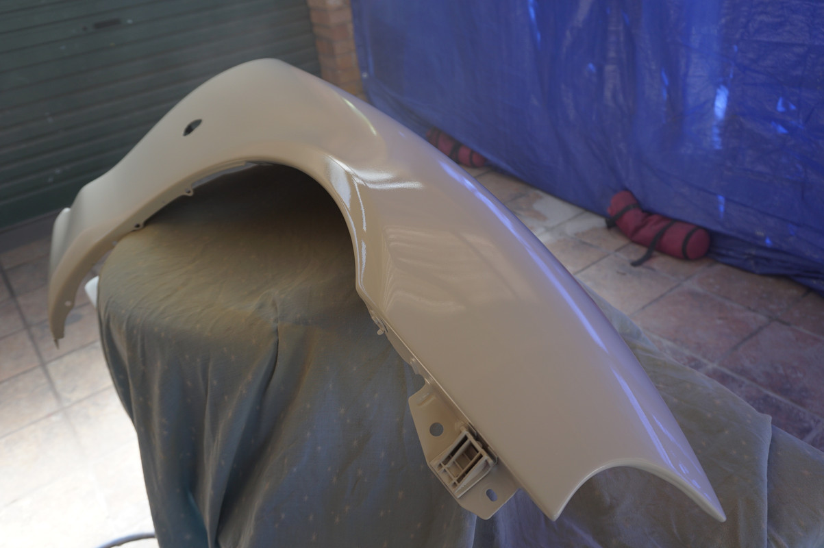

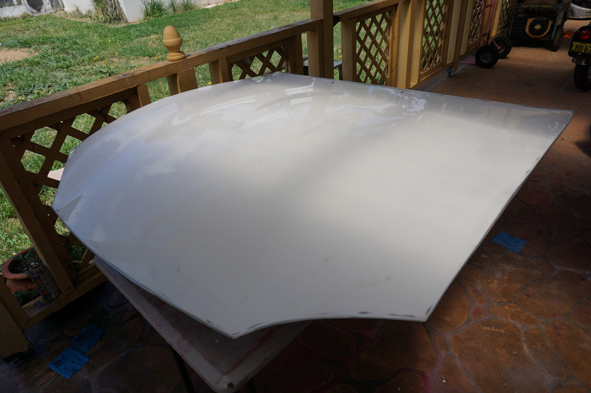

Postby billybunter » Fri Oct 13, 2017 4:45 pm
DAY 21 - 5 hours

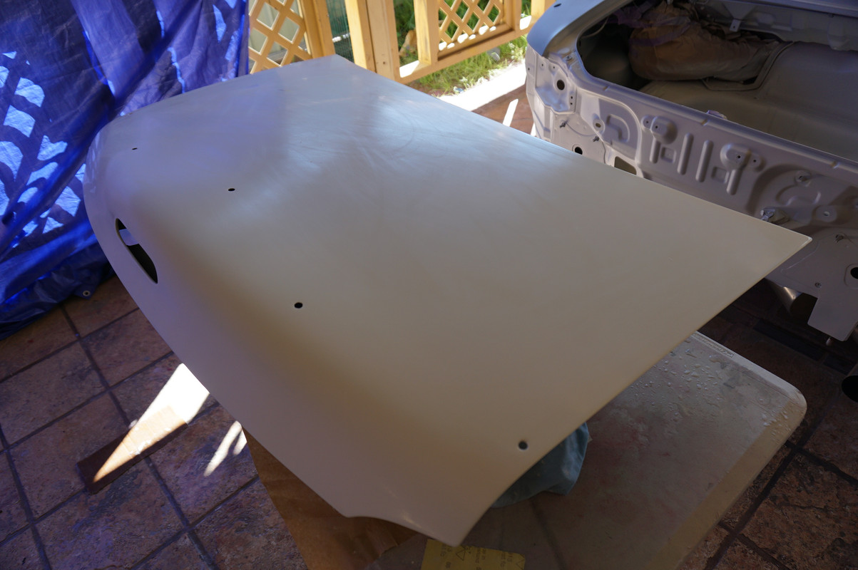

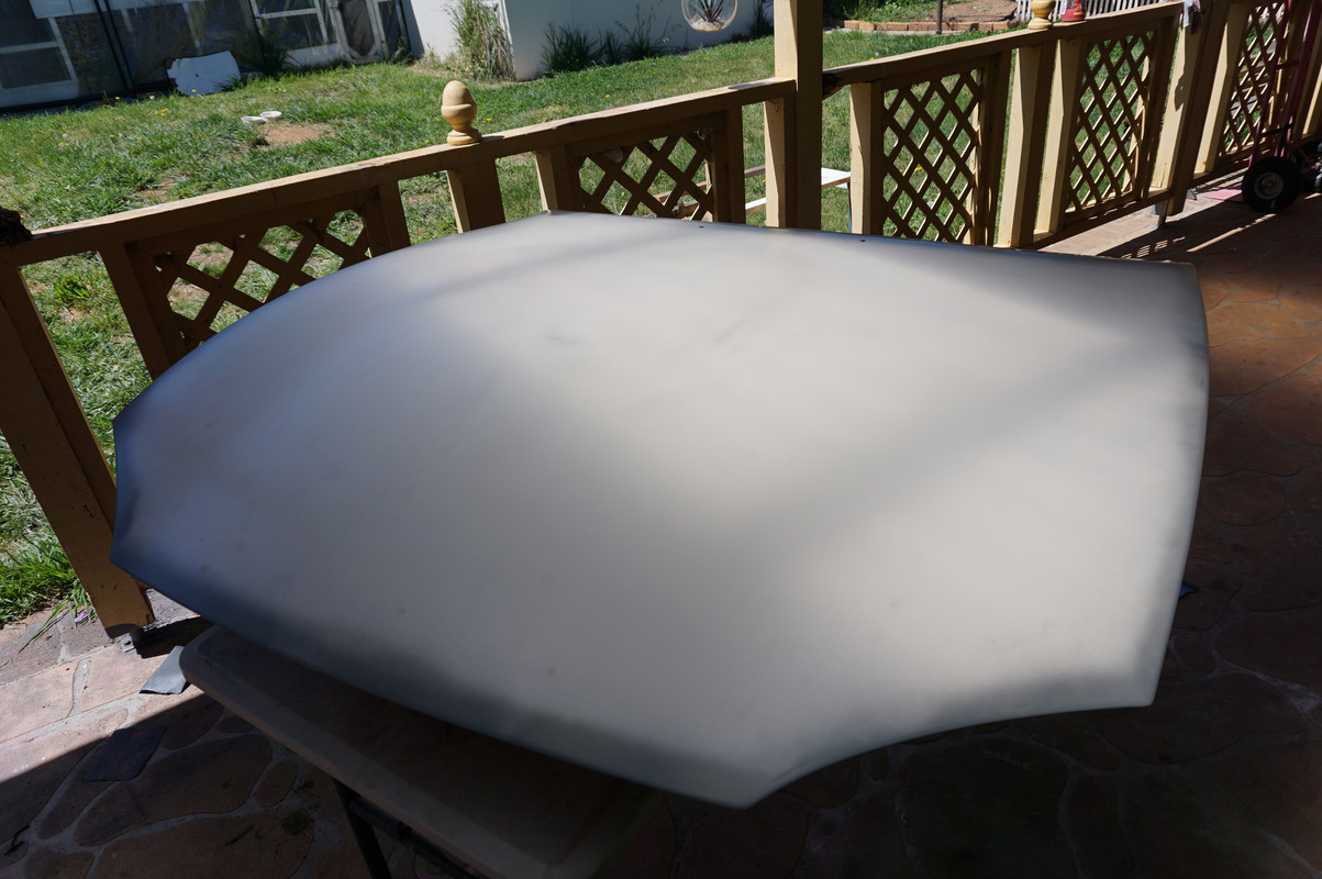

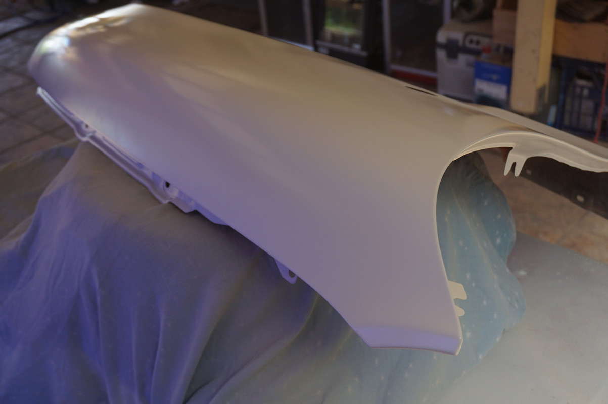

wet rubbed the boot lid with 800 and after that hit it with cutting compound and it looked fine to me so work on
after the wet rub
and the hand cut

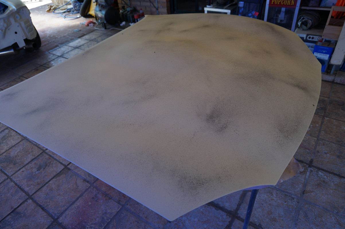

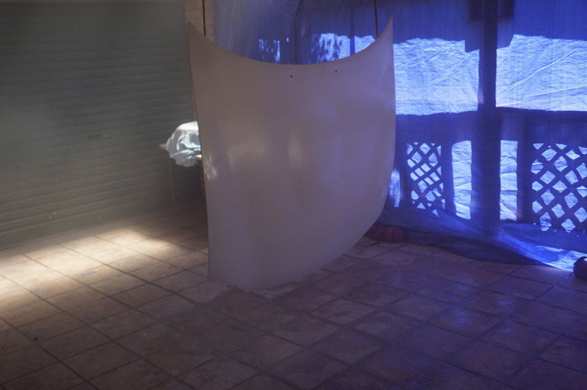

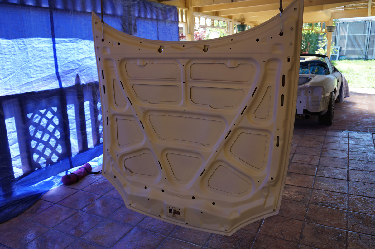

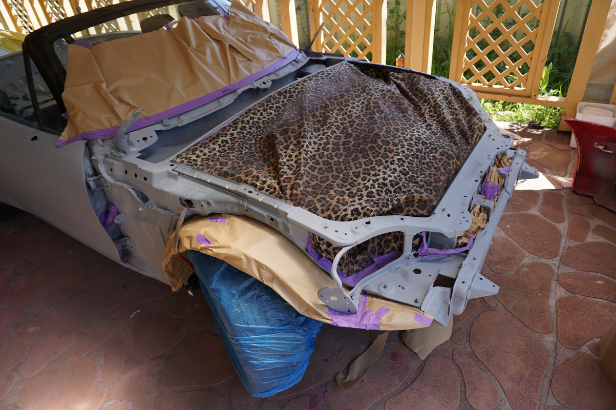

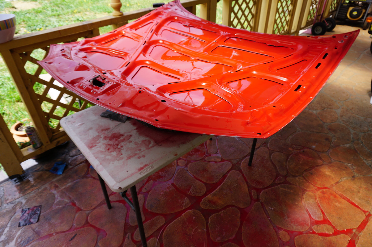

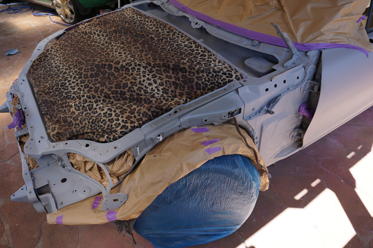

guide coat over the bonnet
after it was rubbed out I required somewhere to hang it so made up this. bit risky but.... :lol:
can be hard to see at times when the spray is flying. better the spray than the bonnet. wife later told me it was Friday the 13th. if I had known that earlier I may not had risks the bonnet move :lol:
it actually turned out pretty good too. the reason for the hanging -just in case I got spurts or drips over the bonnet from a faulty gun

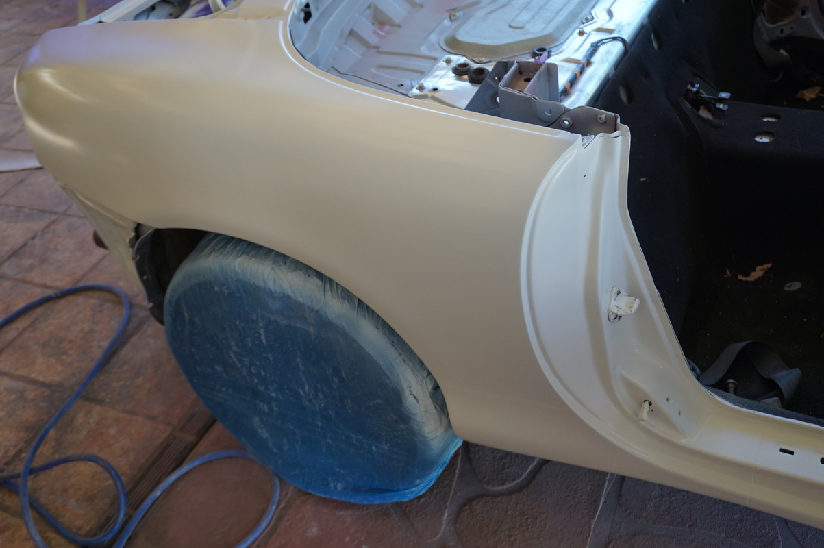

I then did the top coat or part of it on both front guards and they too came out pretty good :wink:

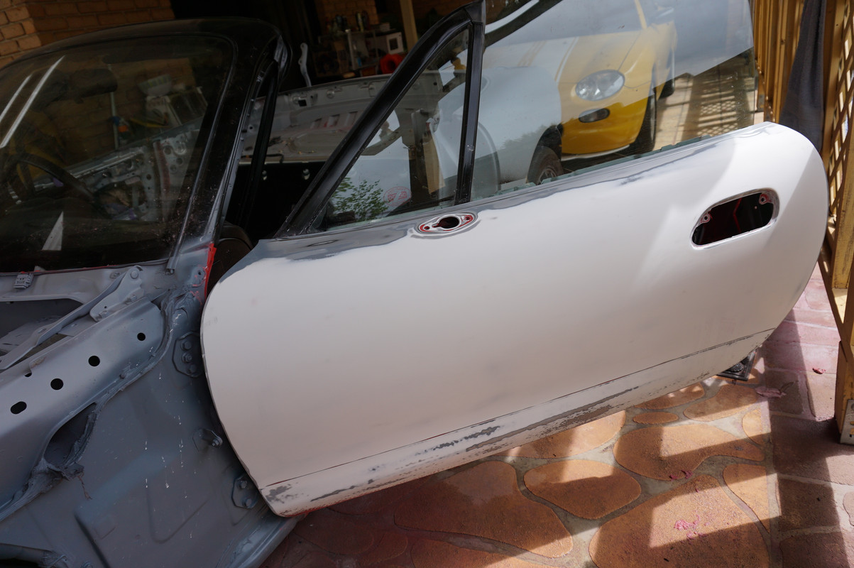

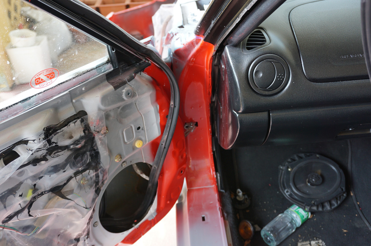

I then decided to clean up the drivers side door area with a wipe down with 800 grit followed by grease and wax remover
masked up the door then decided -stuff it I will spray this area too :lol:
meanwhile the neighbor arrived home and decided to put out her washing - half way through this exercise. I thought stuff it I gotta carry on which I did :lol: and completed the side
I really don't know why these people just can't stay at work :lol: anyway there is always tomorrow so rather than spray a load over her washing - I ceased work :lol:
now if your reading this text -this colour is hard to call it looks fawn in the top photo and this one straight after different angle -white
day over
