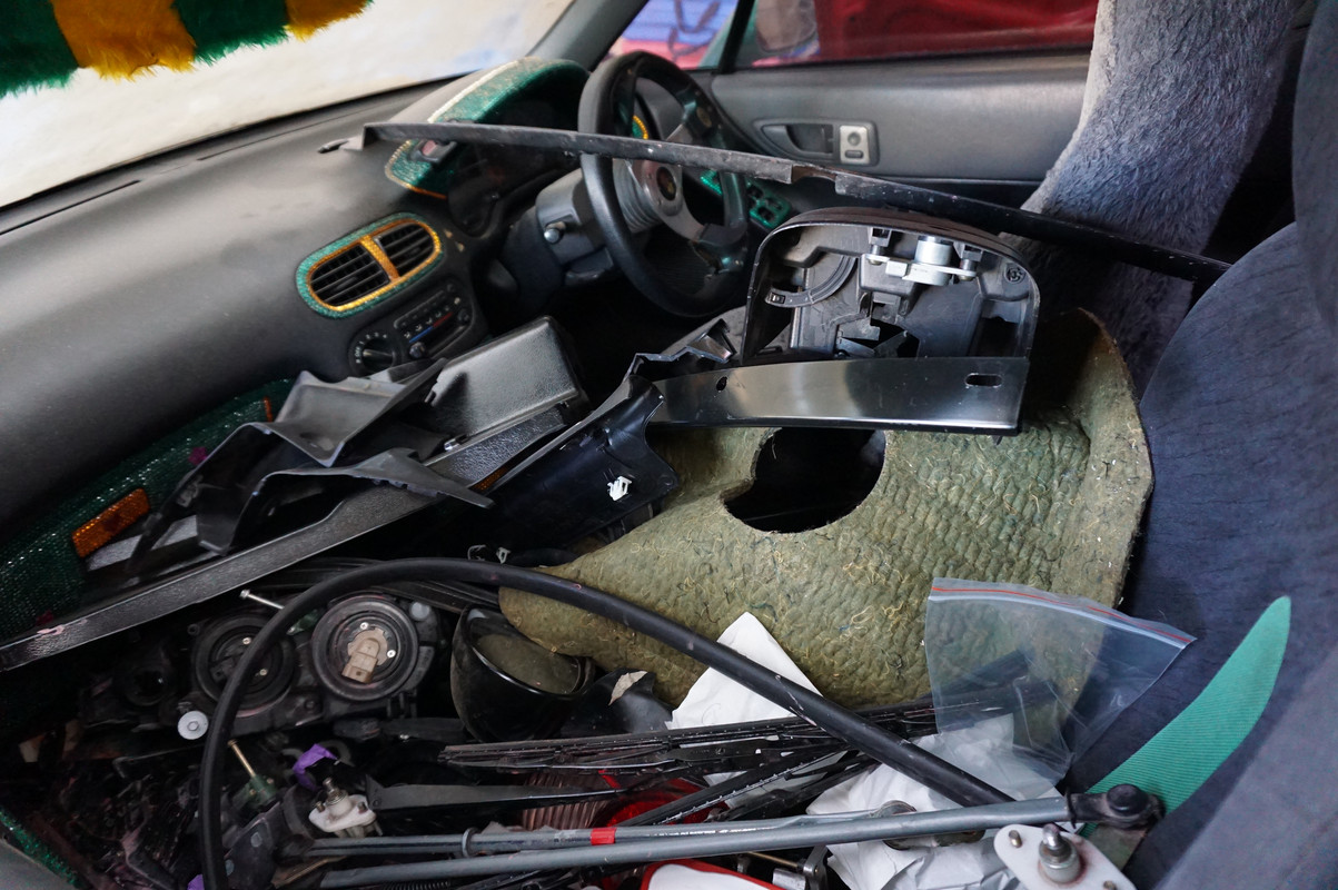

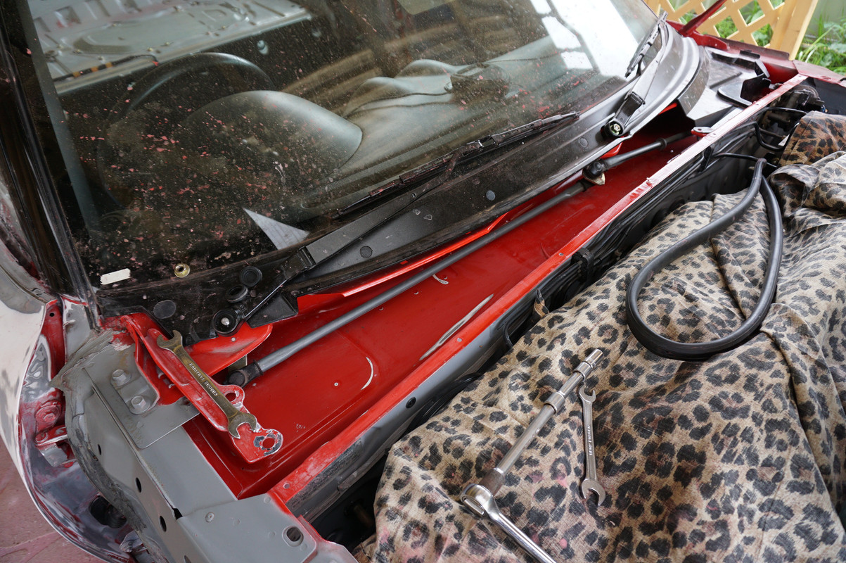

not much on today-actually had to go out and do a bit of work :lol: but I did manage to put an hour in. removed the windscreen wipers and plastic sill surrounds and then over to the front left rear guard to do a bit more sanding. prior to that I use the daughters Honda delsol to dump all my spare parts in :lol:
at the moment she is thinking seriously about buying the new release type r civic so I don't think this delsol will go anywhere either :lol:
lot easier to rub back and do the painting once you remove all the fiddly bits
delsol fully loaded

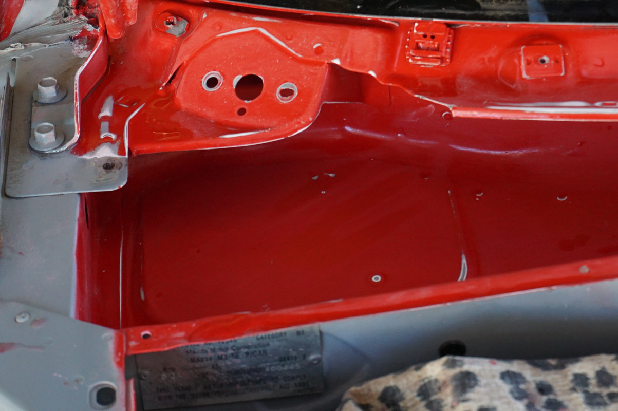

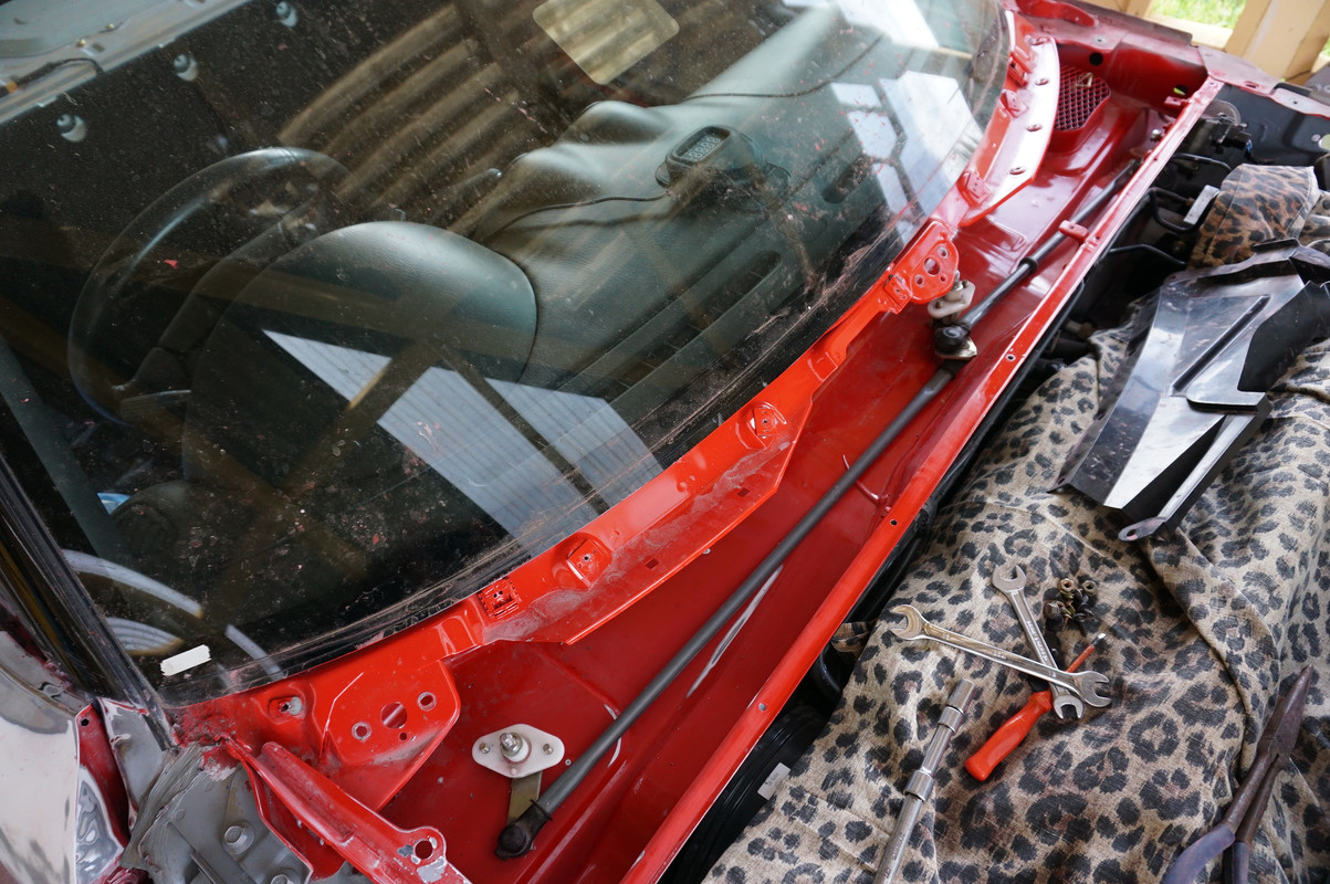

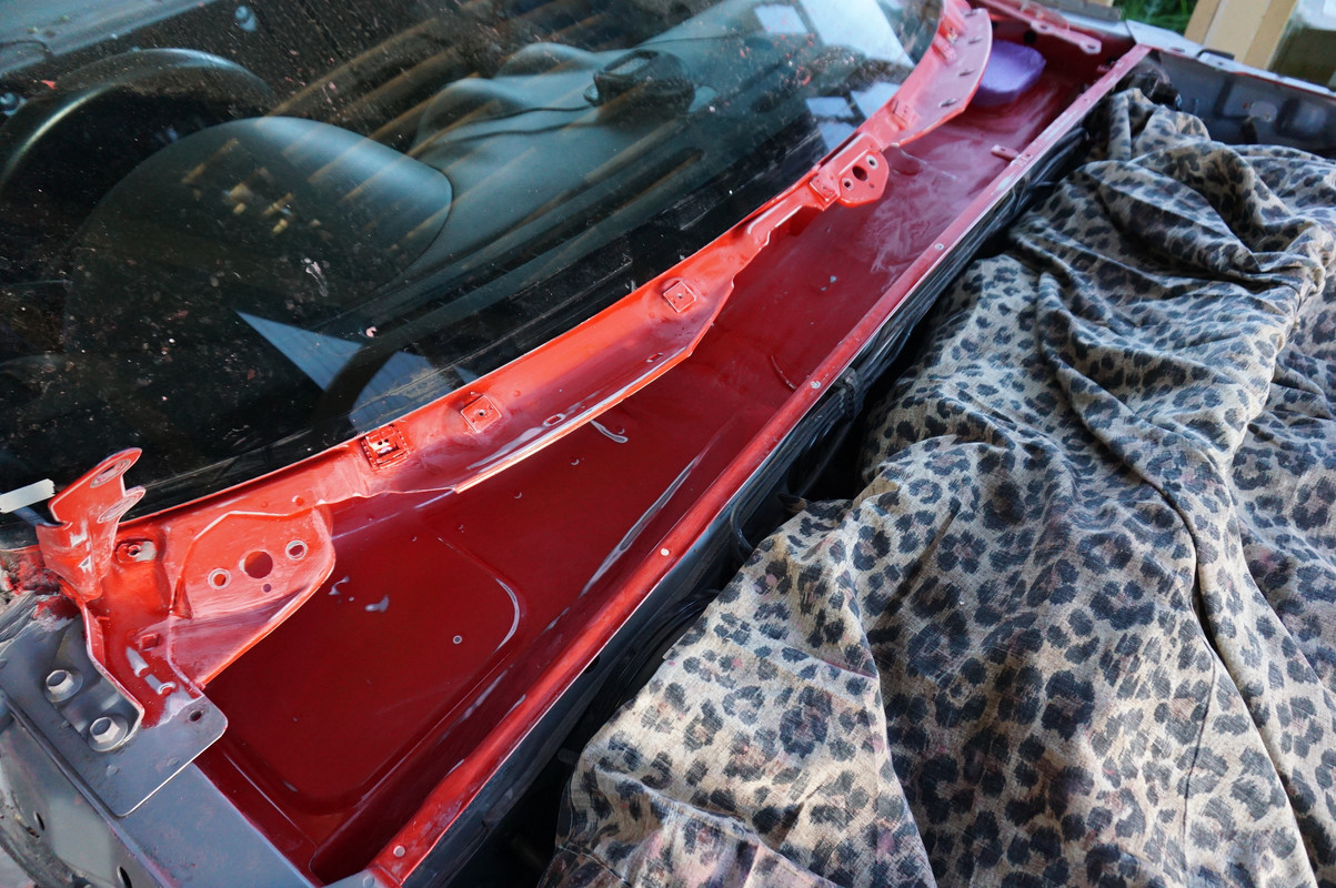

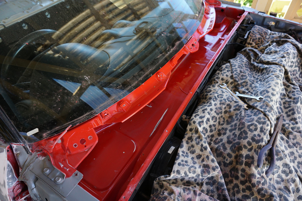

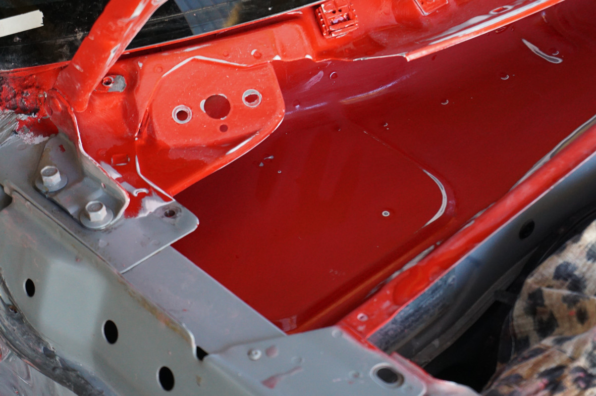

I decided to just put in an hour today on the wiper cowling area. might sound like a waste of time doing it but if you just go into these areas and wipe them out it makes the other areas pretty easy going
pretty tight area to work but in places you can still use a foam block using the 400 sandpaper -either flat or on its edge. after a while you don't really need the foam block at all its really all about pressure on the work area

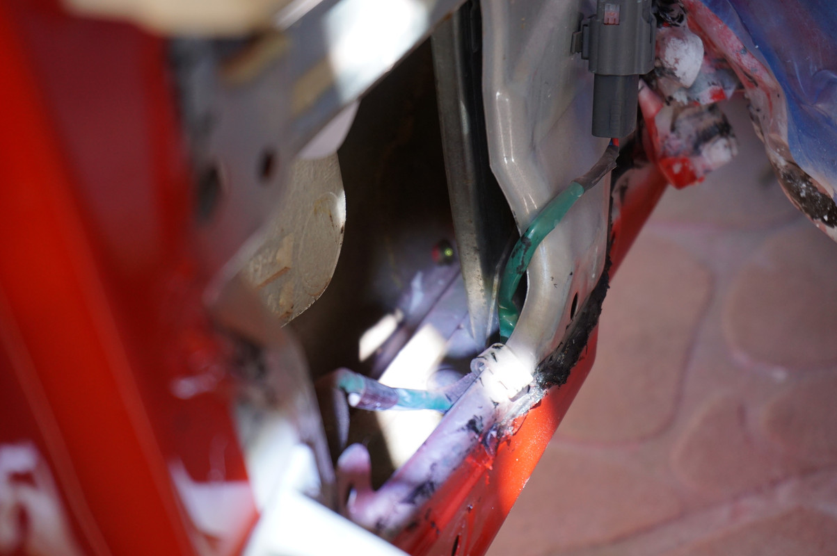

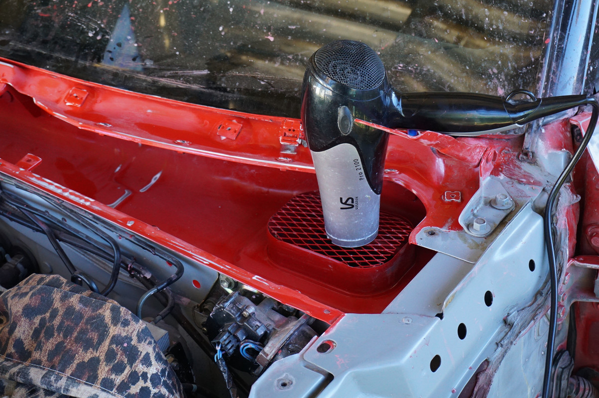

slight error here. never closed the entrance to the vent and a bit of water sprayed in. too much would not be good for the ecu lurking below. shone the torch down and just a bit so out with the wife's hairdryer and so got rid of the H20 in no time at all
not to get caught again I immediately taped it up :lol: you can get side tracked easily and this is not the place to get caught with a new ecu and tune :lol:

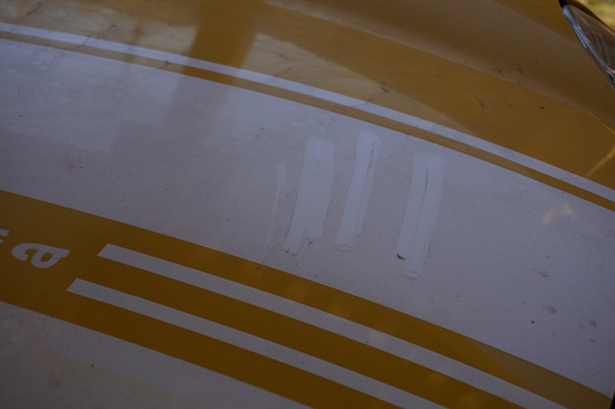

check this out! harder rub 400 paper over the clear coat. no foam block and you can see my finger outline embedded in the clear and almost into the colour. demo purpose only :lol: if you can't see it- near those 3 dots centre of screen shots in the panel. that's how the trouble starts
now I've wrapped the 400 sandpaper in a foam block to try and rub out the damage. its working but I will have to take it right past the clear-which I would have to anyway and onto the colour. this is where using fingers or hand rubbing can have you back to metal very quick with aggressive one spot sanding.
wet sanding isn't hard. just use a foam block, plenty of water clean sandpaper and keep it moving over the work area.....well that's what I think :lol:

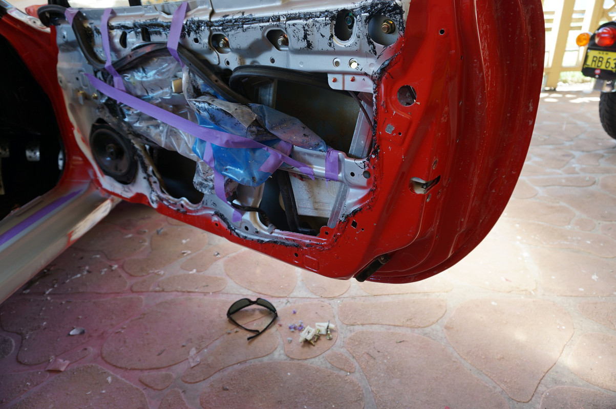

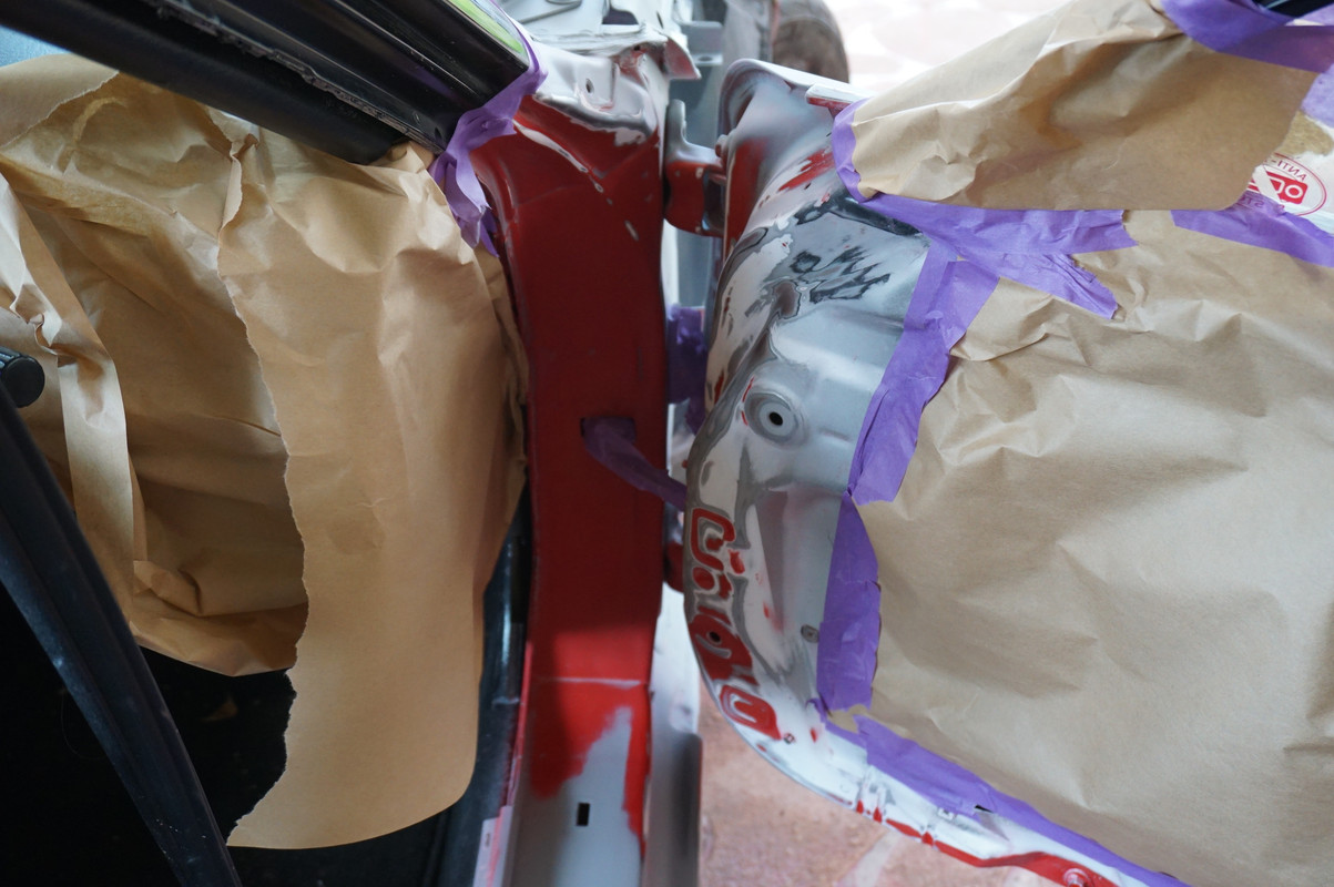

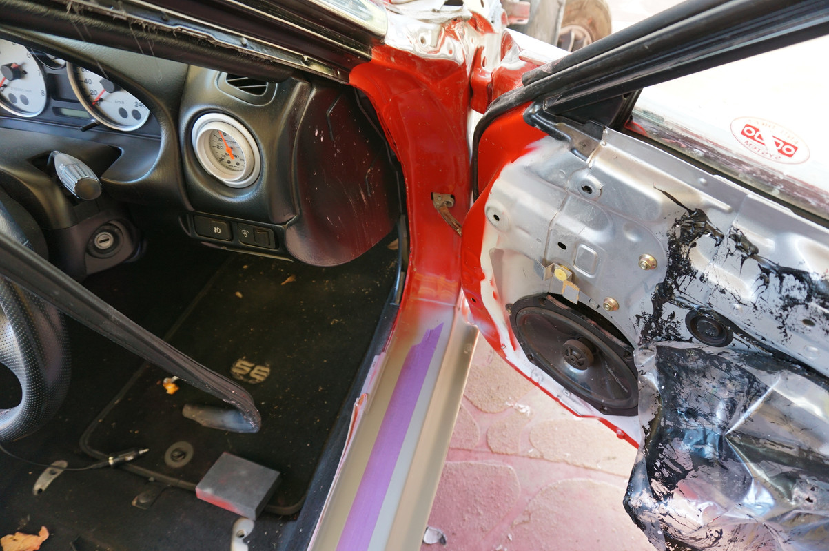

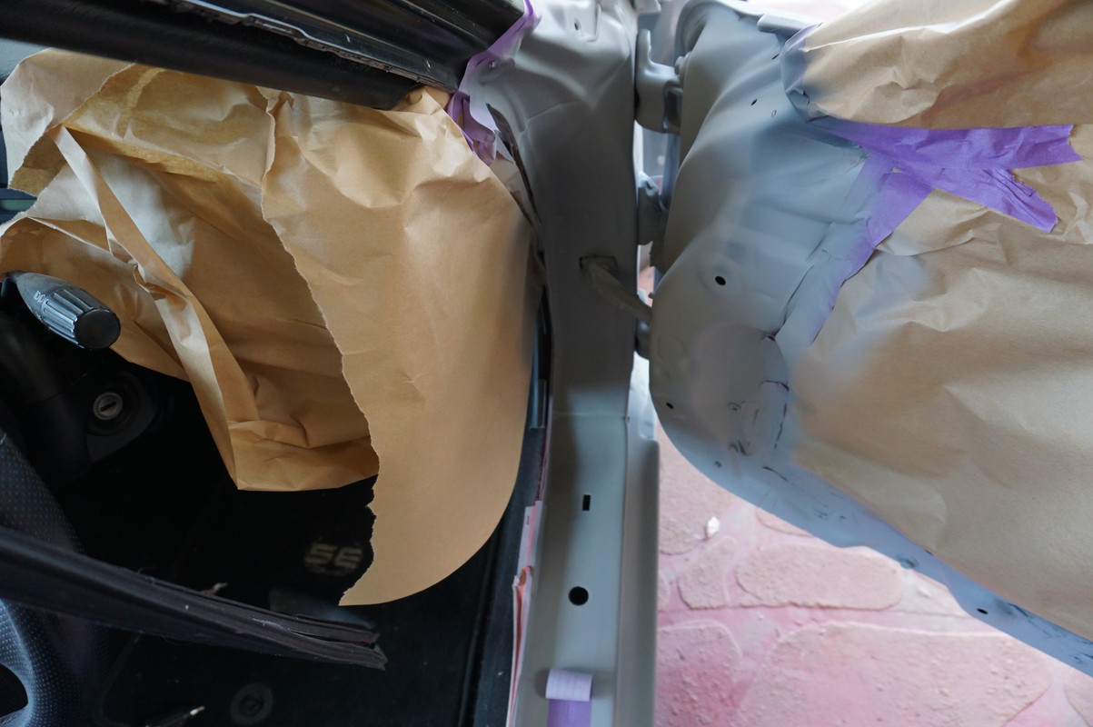

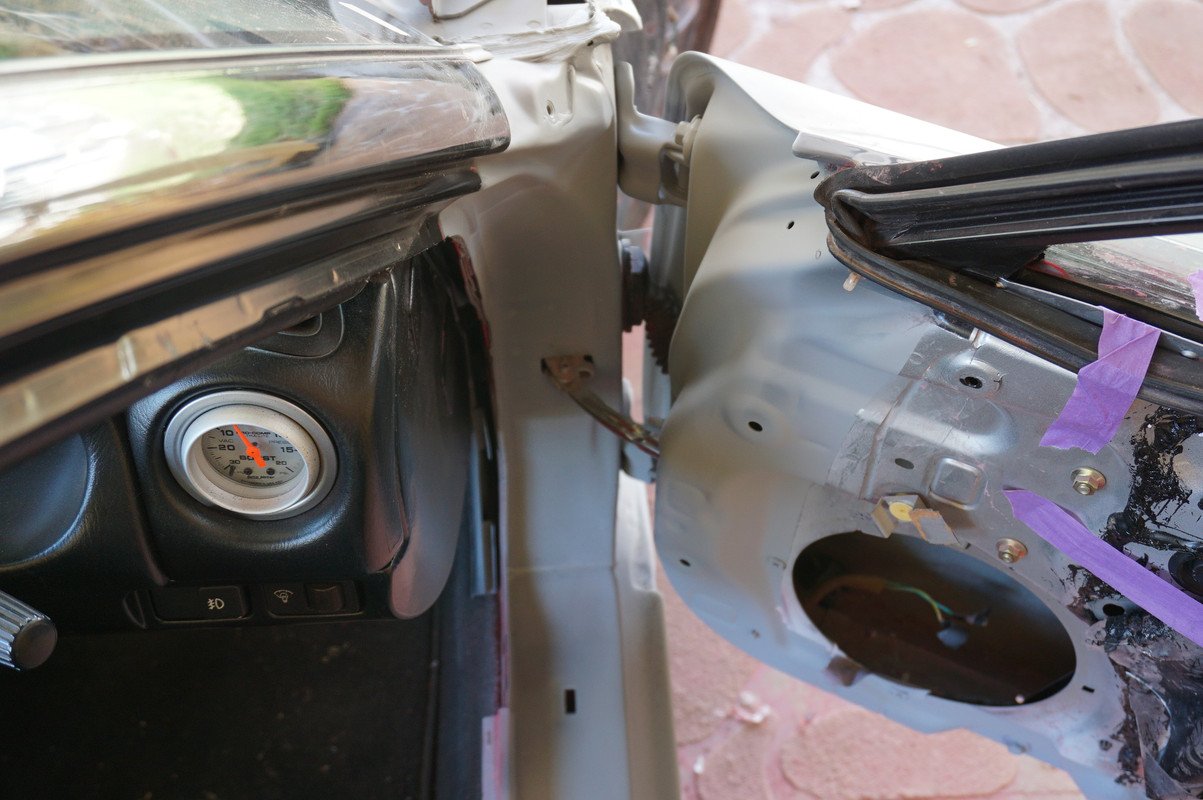

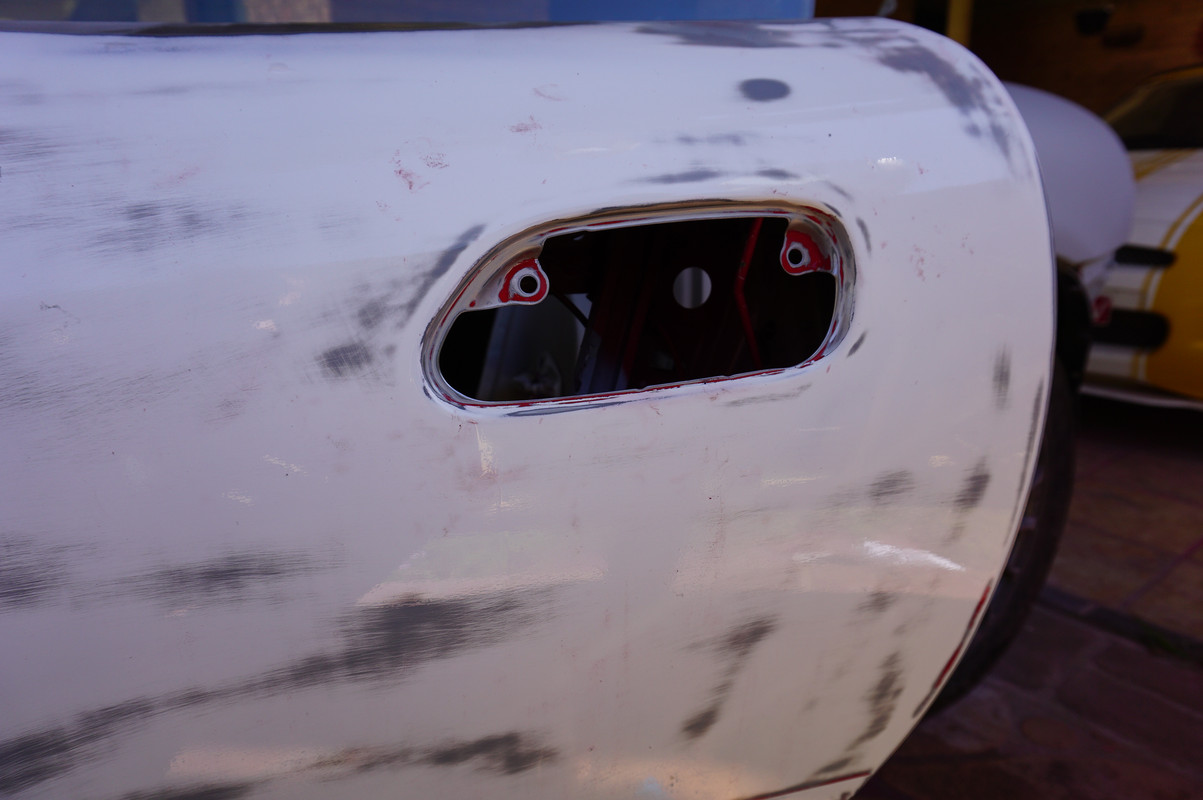

after I removed the weather strip this is the door area I decided to clean up a bit today. I was going to show what I used to remove the strip but decided not too :lol:
while at it I also removed the passenger side door handle. an A4 inside to catch the nut or try to and it worked again ..or sort of. even found a socket on one of the door nuts from last years paint job :lol:
and the nut now at the bottom of the door sill but much easier to get

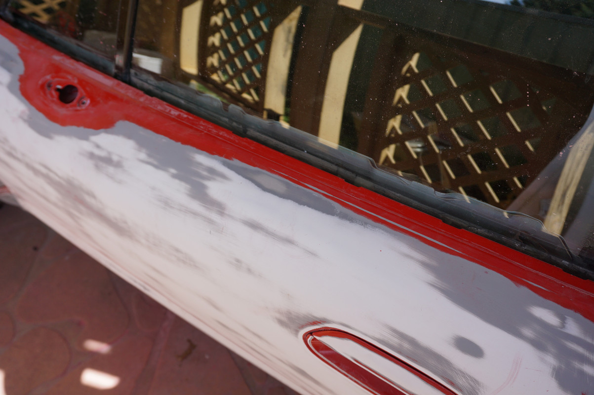

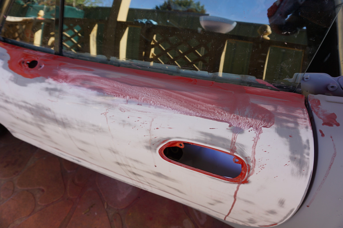

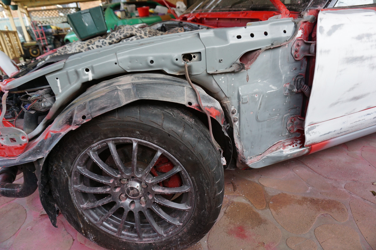

if you recall I painted the rear end of the mazda and never moved the mgf.it picked up a bit of drift spray but you can see from where I ran my fingers through it -no harm to the paint. if I was worried -i'd have moved it :lol:

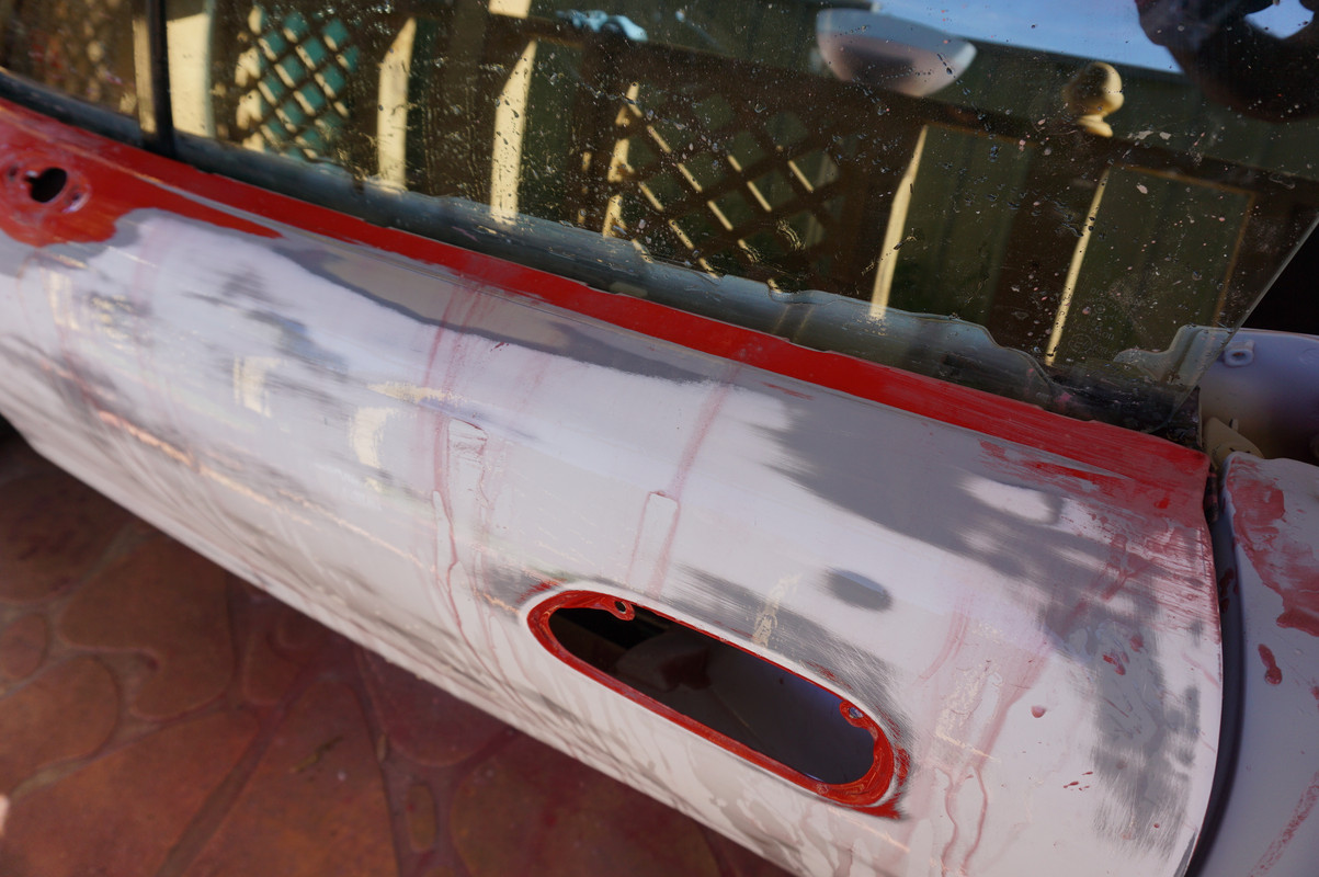

so I first hit these doors in the RED with 180 wet and then went to 400. reson for the 180 a bit quicker to bit into it
my advise would be to any-one. take along the bottom of your windows first before you start playing with the sandpaper as it will scratch your windows. you have to be careful. I usually don't but I think you should :lol:
then it was over to the door handle where I spent more time there than in the other area
day over or about an hour in today. but later on I will get serious :lol:

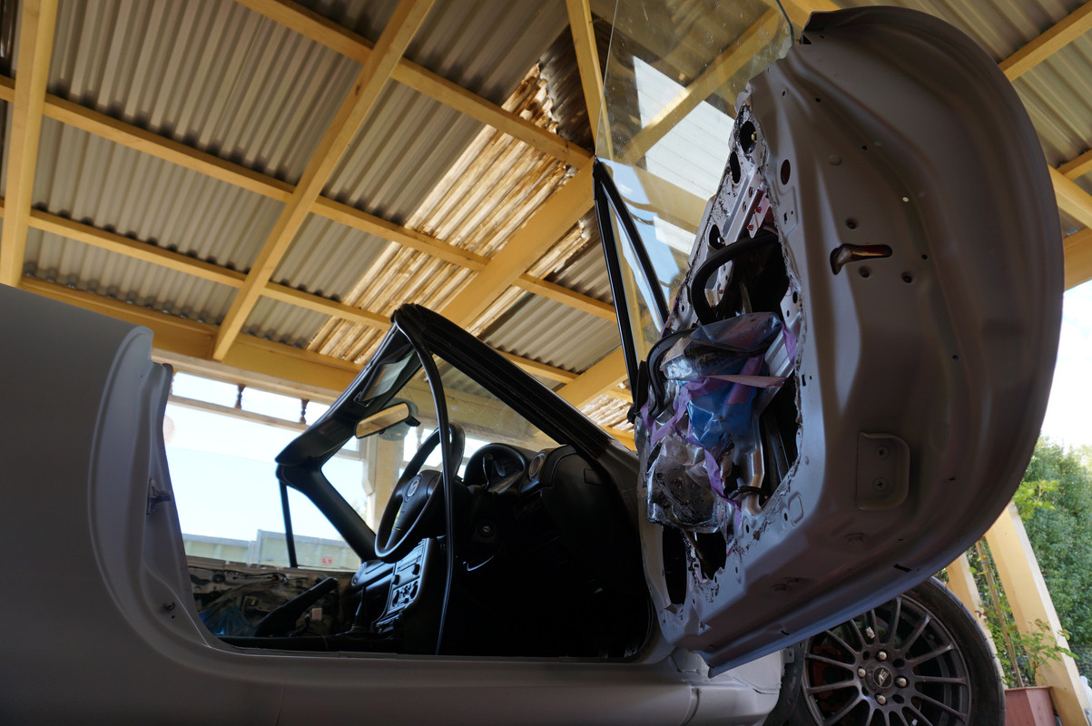

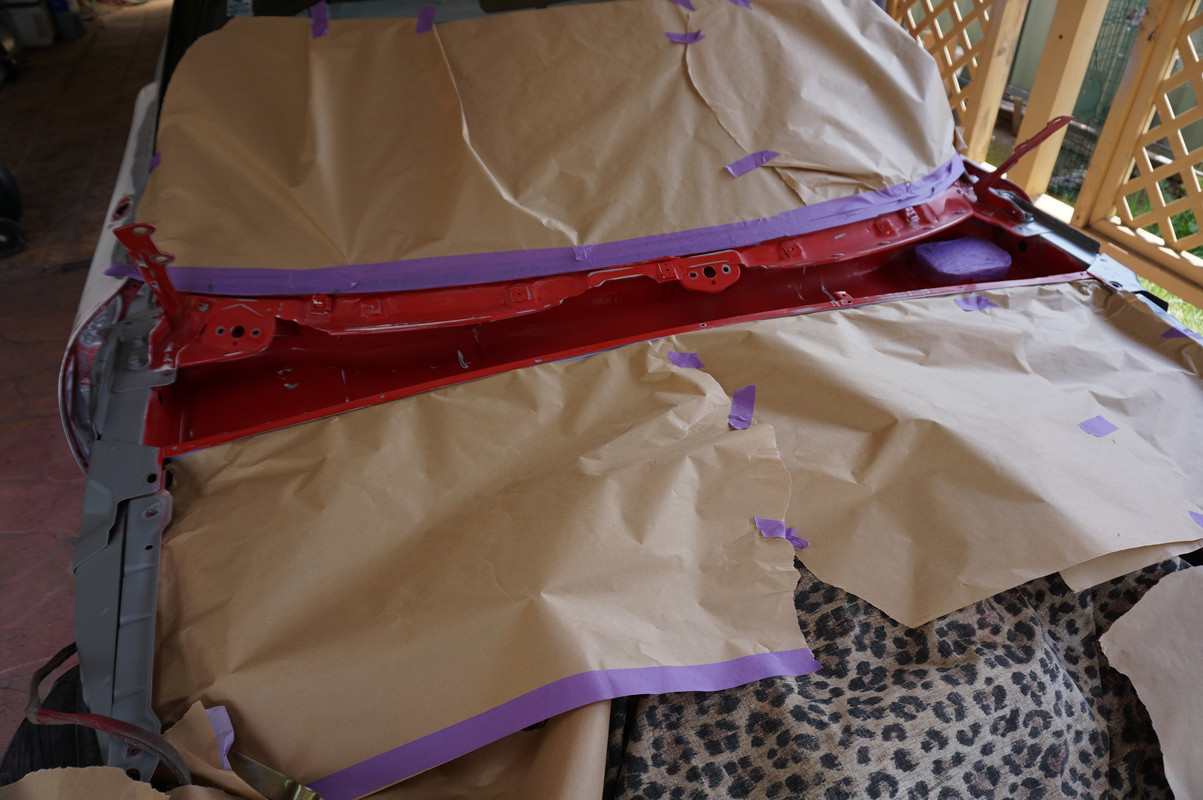

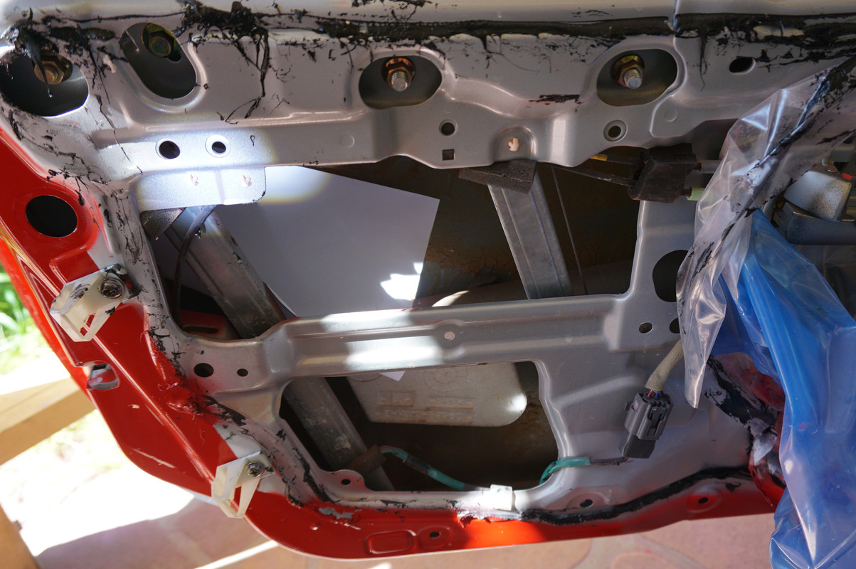

started off with removing some of the drivers side door hardware

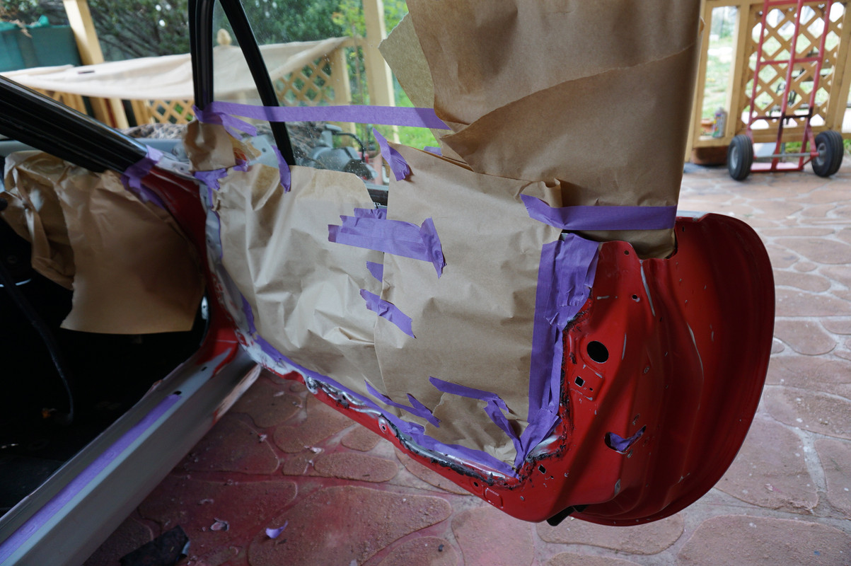

taped up the sill so water from the rubbing does not go inside the bottom door sill

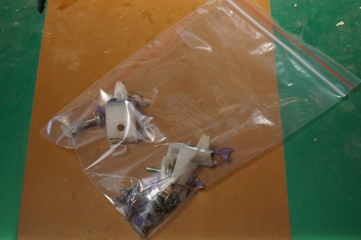

this time rather than use an envelope I placed all the hardware inside a see through plastic ziplock seal bag

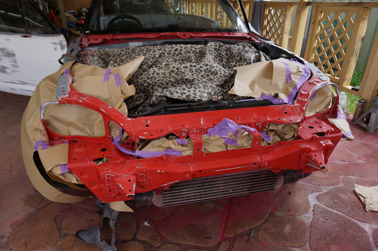

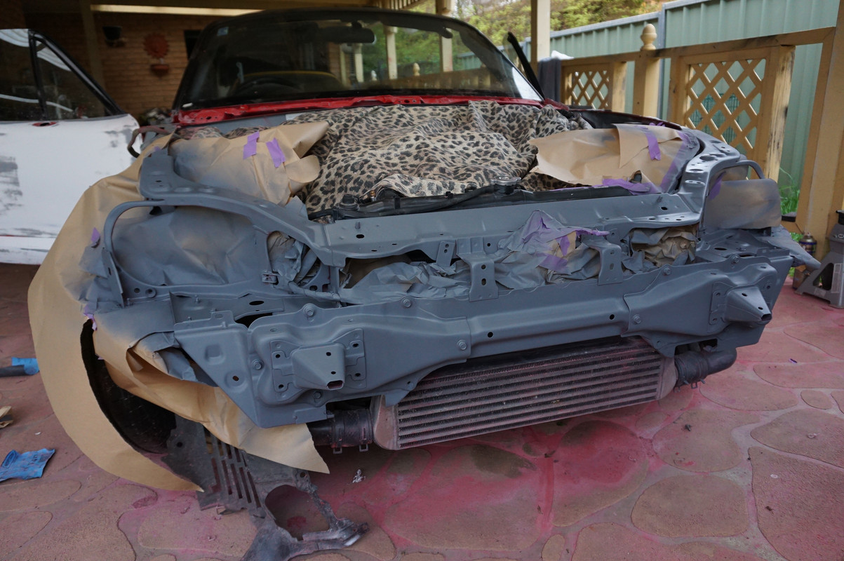

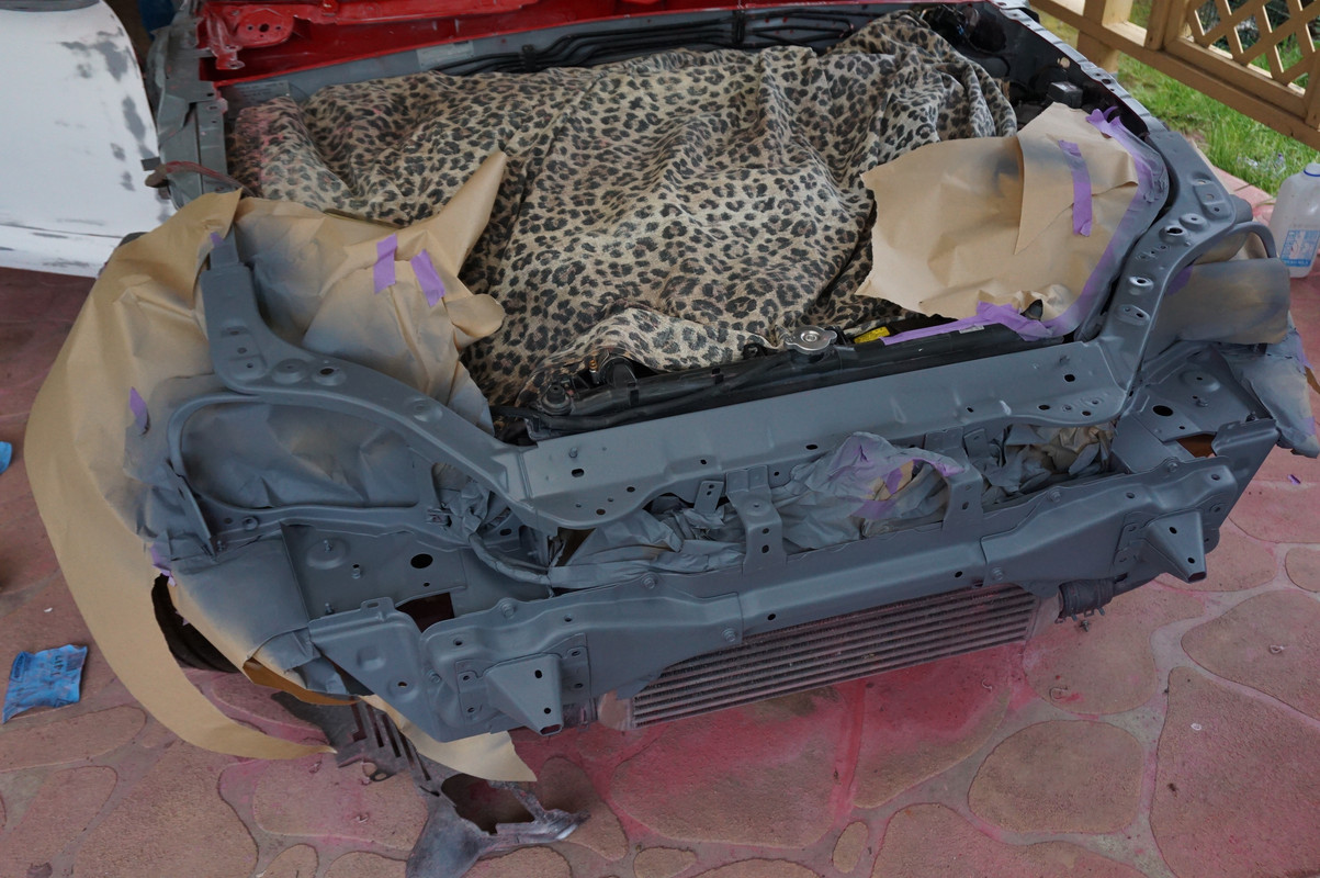

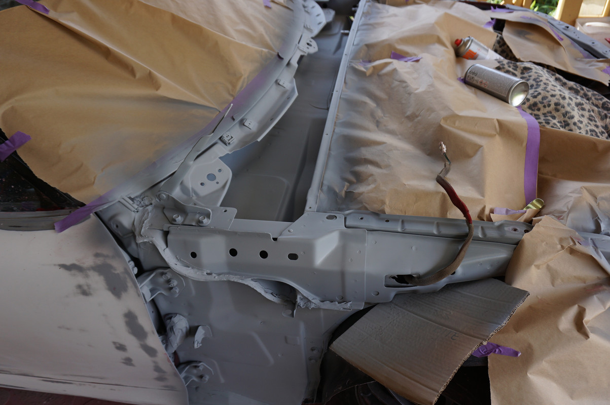

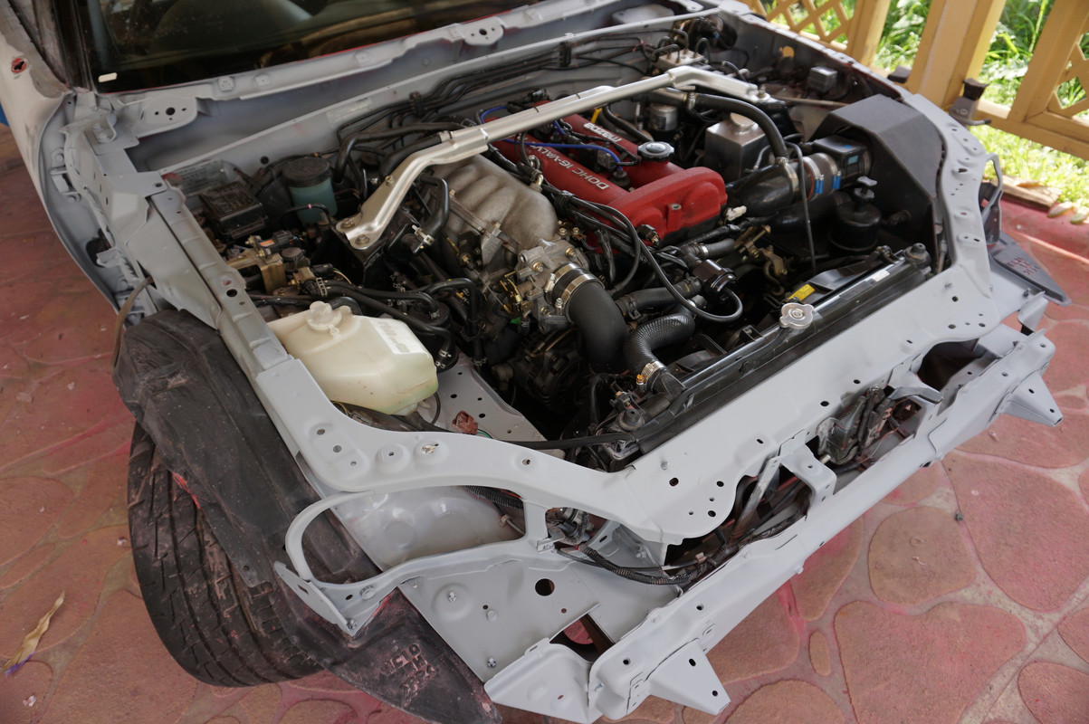

then over to the front of the car to do a quick mask up

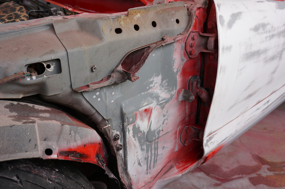

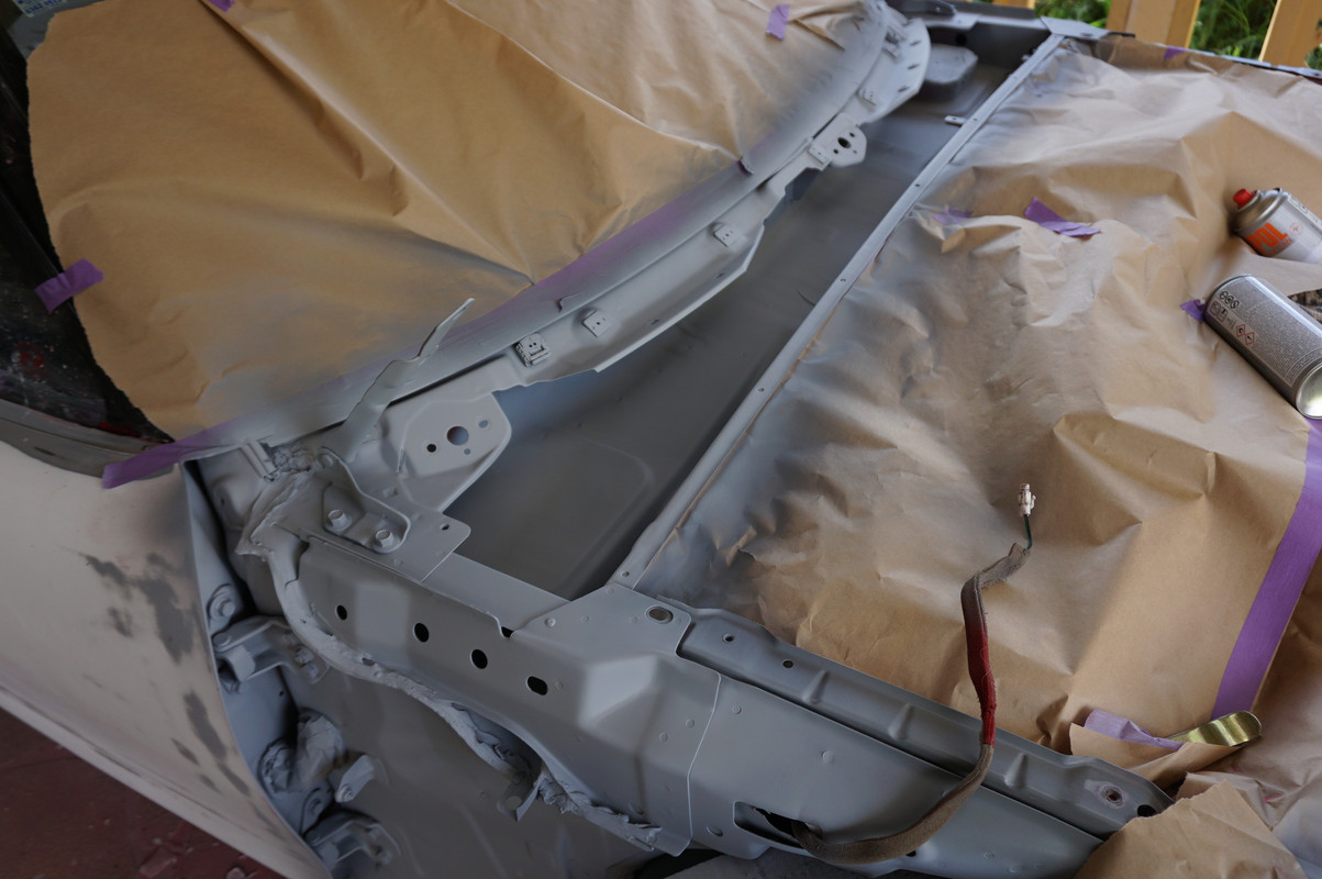

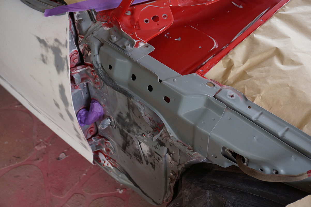

followed by an etch prime as I had quite a few bare metal areas on show
Postby billybunter » Wed Oct 04, 2017 6:42 pm
DAY 12

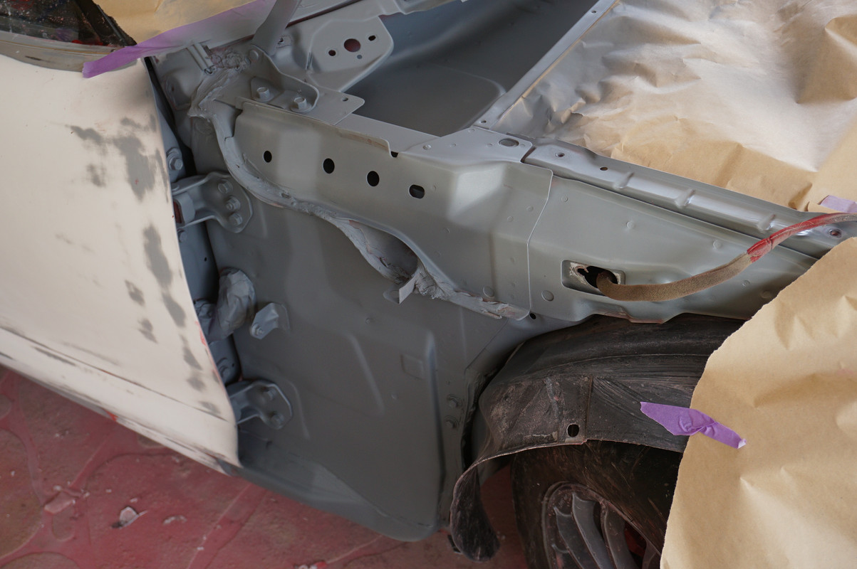

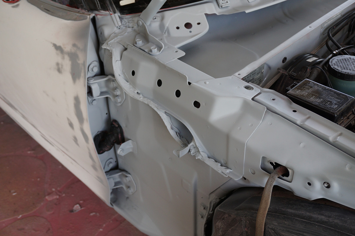

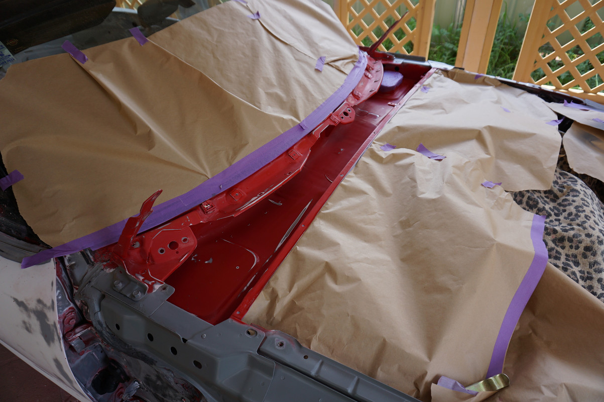

a few traces of missed clear coat showed up so it was back with the sandpaper for a re-rub and prime

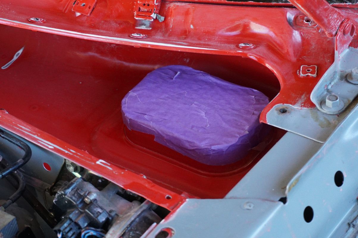

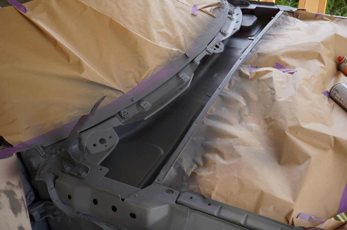

wiper area was then masked up for etch priming
this area clean up with grease and wax remover and masked near the door
etch primed
so too the wiper bay

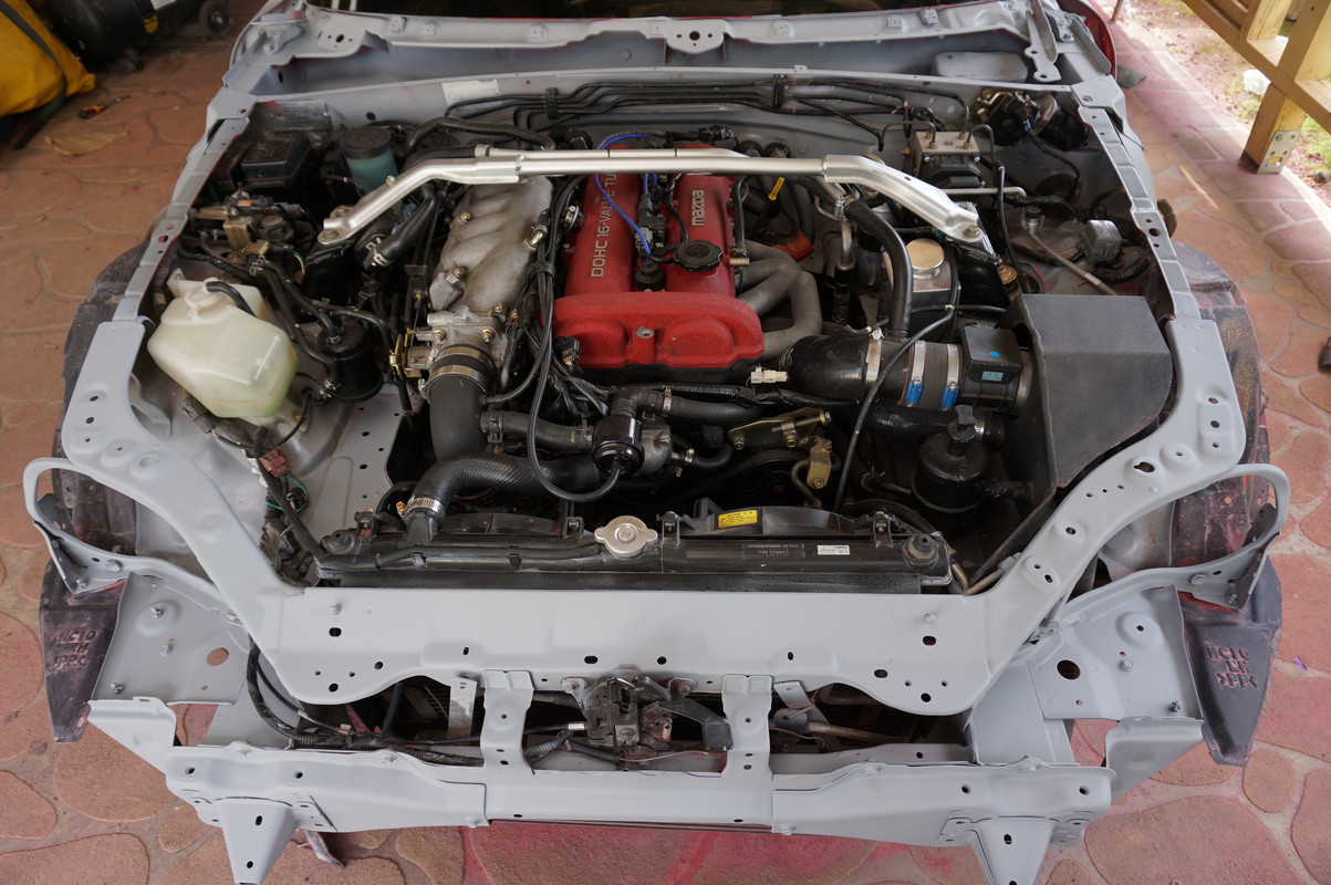

then went for a 90 minute run on the motor bike and once back hit it with the primer/filler
final coats and these are complete
overall the front end look pretty good now. now a show motor but a fast motor... :lol:

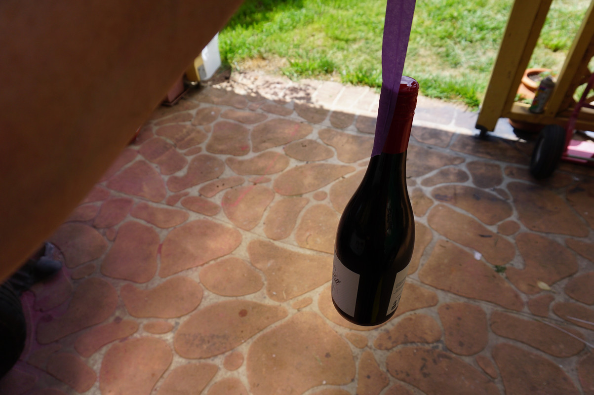

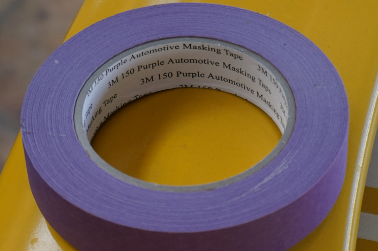

you might be wondering why a full bottle of wine is dangling a metre or so above the cement and hanging from a bit of strip of masking tape? well that's how much confidence I have in this new masking tape I am using on the job.
unlike the crap I've been using on and off. you know, the stuff you pull out and it tears in all directions and you have to pick at it and then tear it straight across to even it up- pull it out a bit and it stuffs up again.
you get it on the mask up job and once the pressure from the gun hits it the adhesion is poor and it lifts -the masking paper flips over your new spray and .............expression of words follow. this tape sticks like it use too - 10 or 15 years back
now if your wondering what if I had dropped the wine. well I get it for free and I don't drink the stuff or beer or smoke or eat or do anything else :lol: so I usually give the sh*t away so I guess I would have to clean up the mess with all the other mess.... :lol:
this tape is about $5 a roll. made by 3m and called purple automotive masking tape. if you read this thread and paint. just looking at this has saved you more heartache than you can imagine...believe me :lol: as you have no idea how hard it is to get good friggin tape!

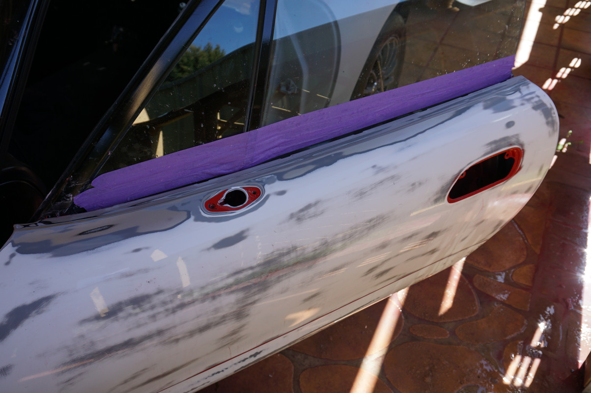

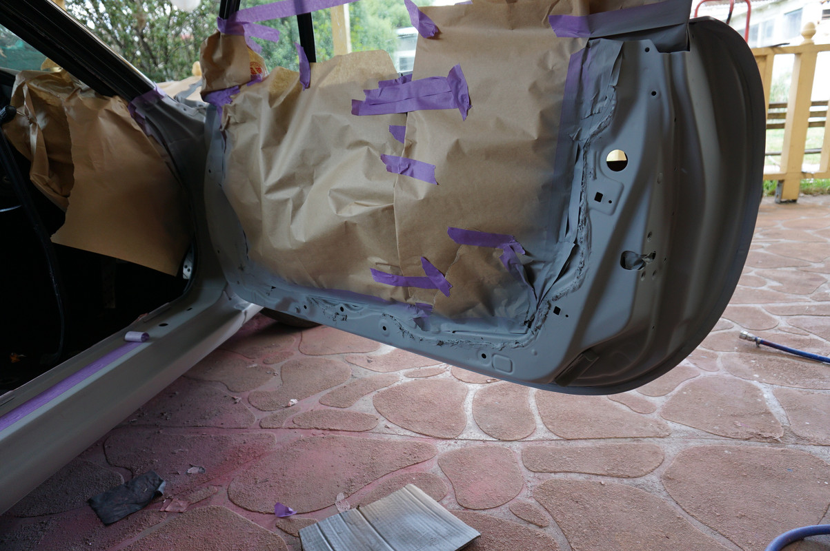

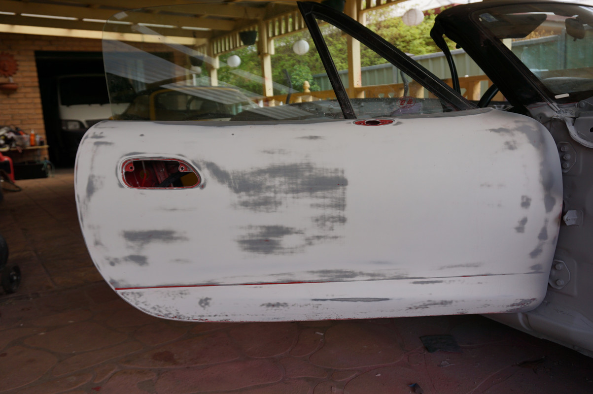

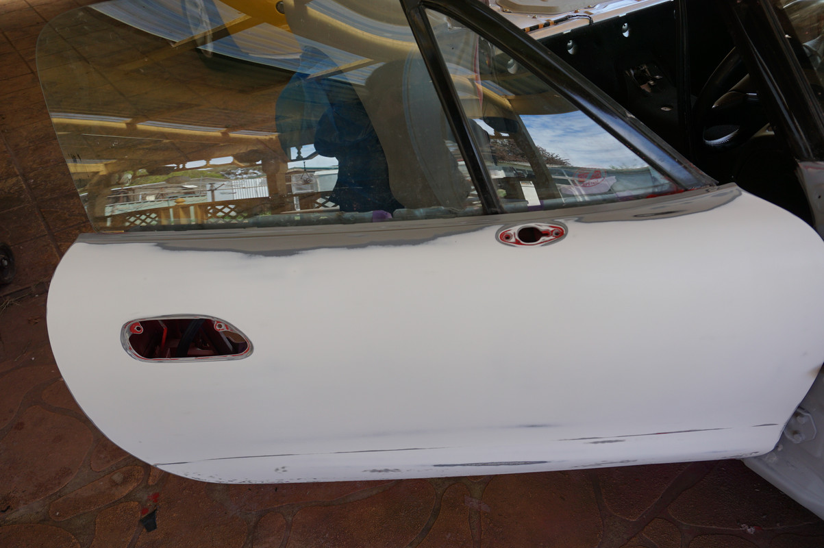

I rubbed back the drivers side door with the 400 and masked it all up. took a lot longer than you would think. lot of fiddly work involved. then I wiped the whole area over with grease and wax remover
first light coat primer
also ran it under the sill too
final coat primer and paper off
Day over

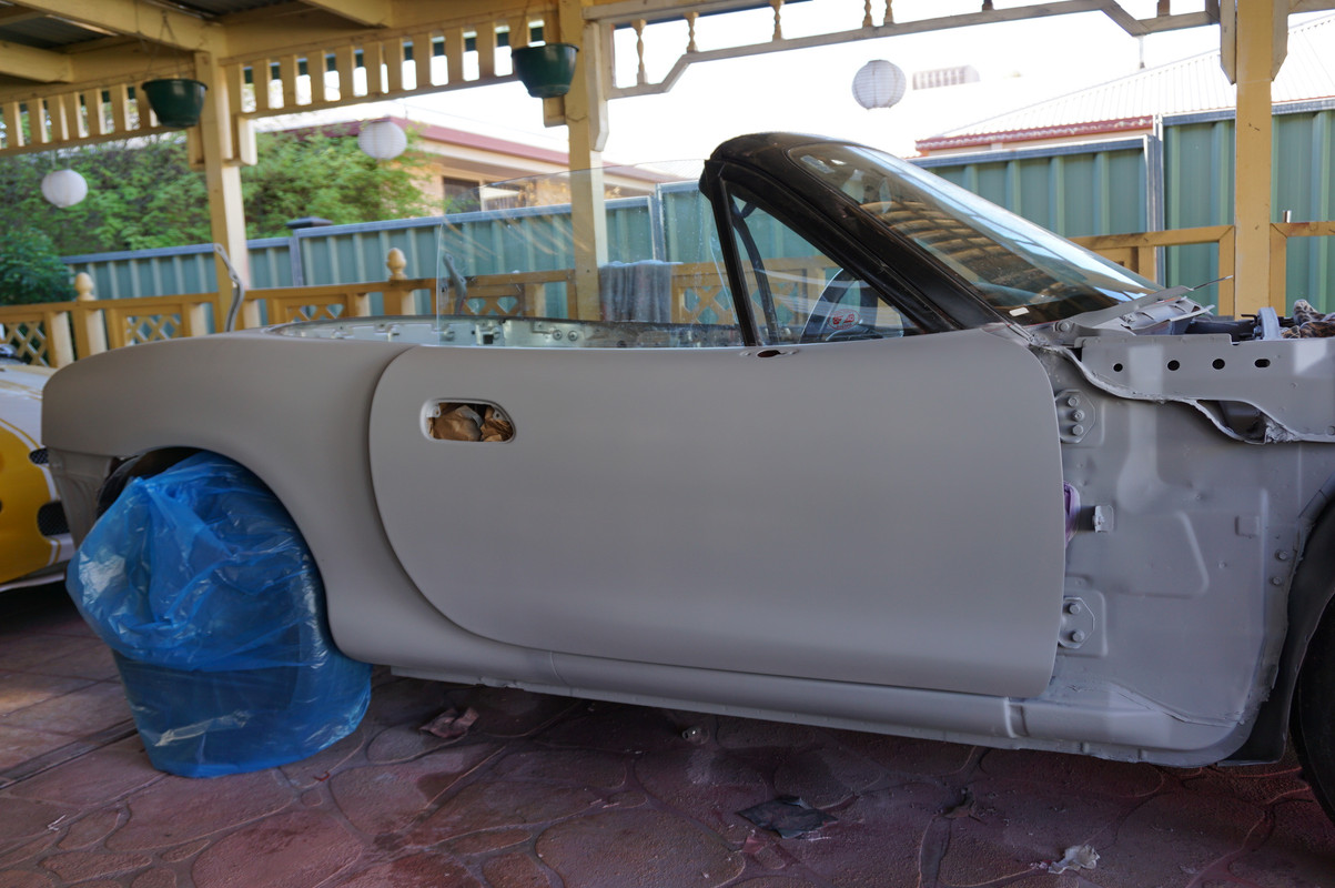

Postby billybunter » Fri Oct 06, 2017 5:54 pm
DAY 14

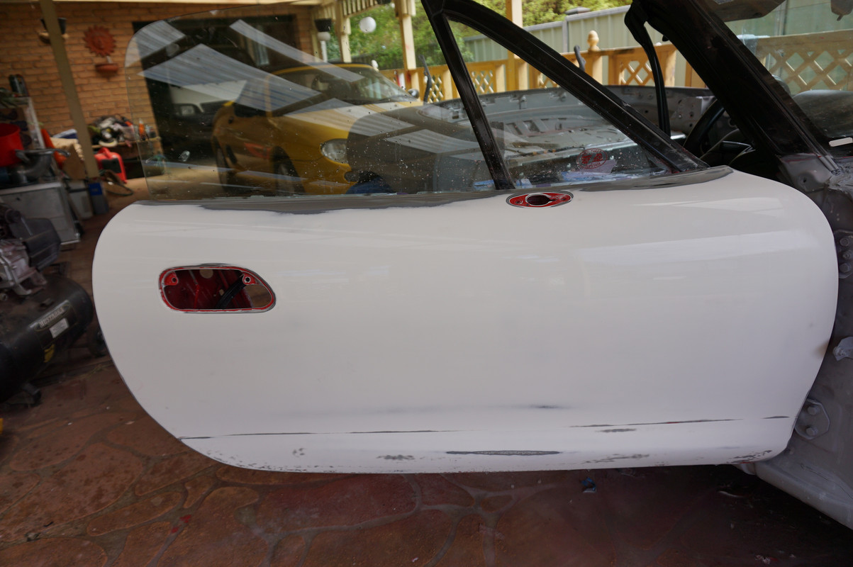

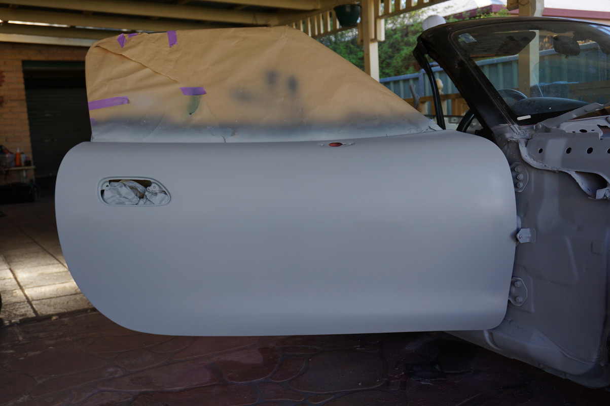

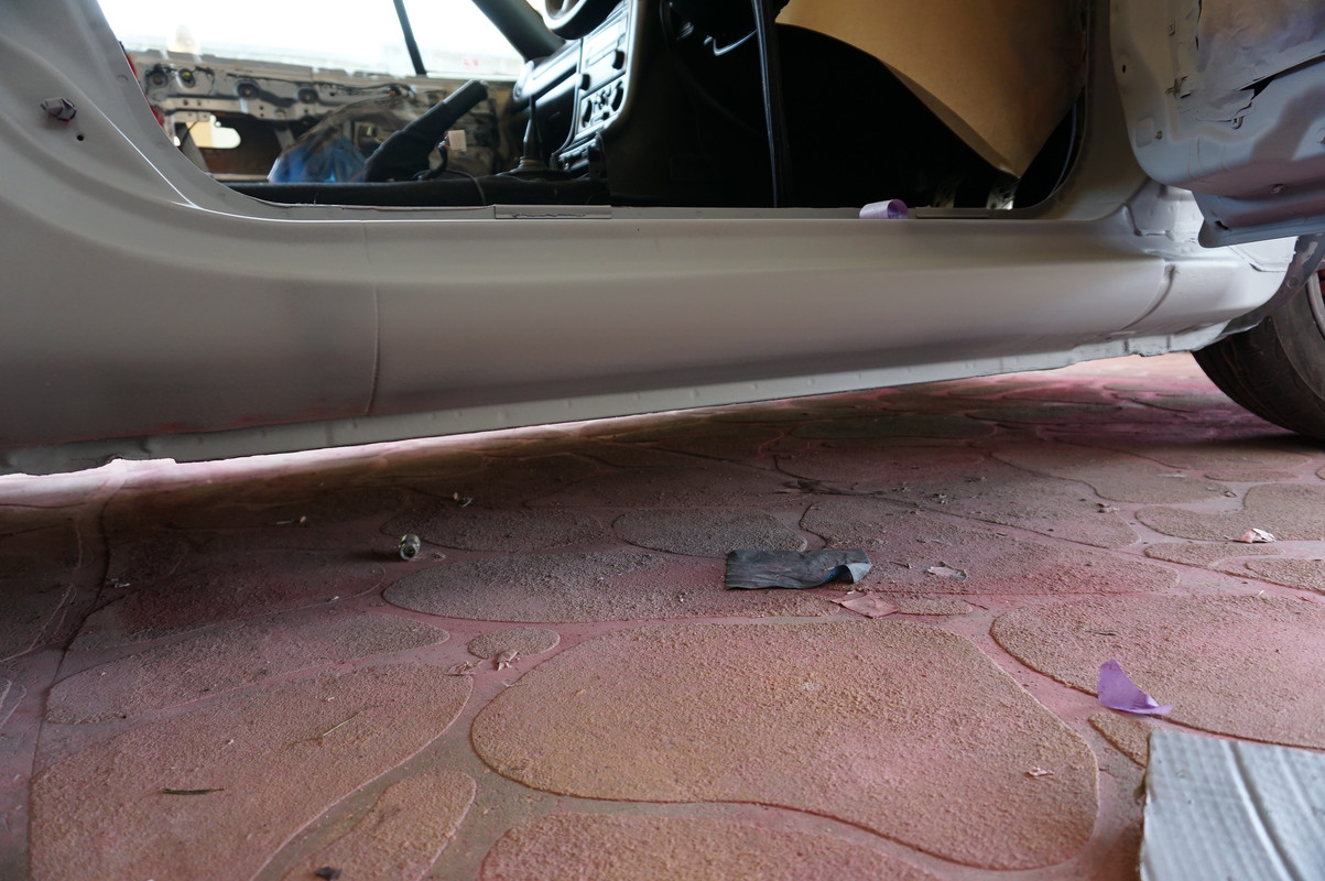

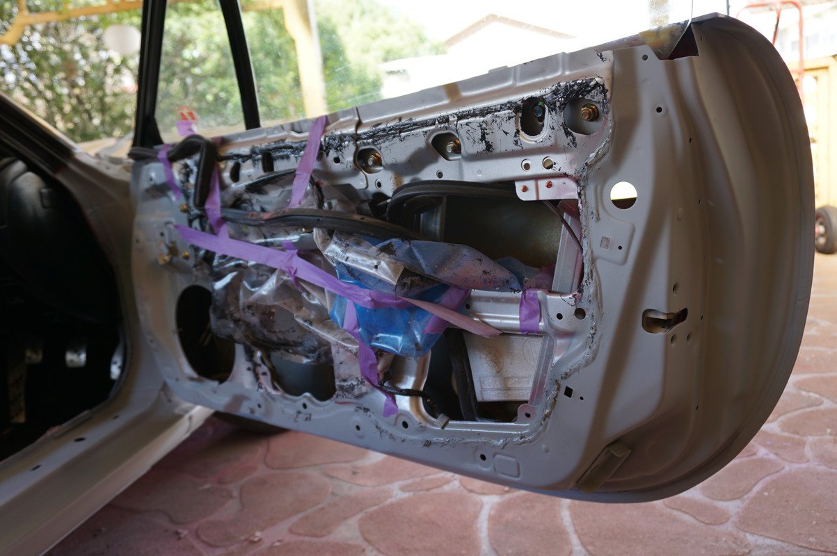

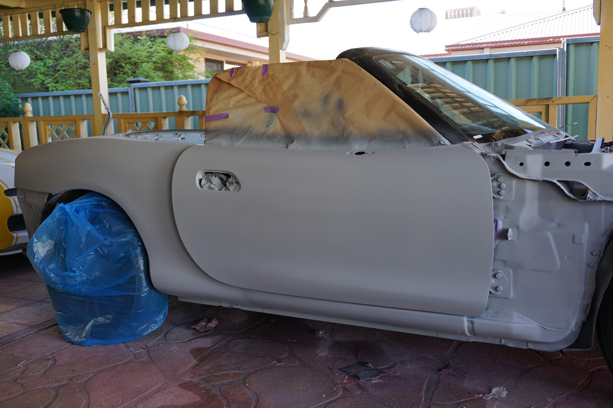

drivers side door prime which required a final rub down with 400 wet. plus clean out the door handle area and the body line 0 just in case any stray clear coat was still about
again took a while to do as its a bit hard to work door handle areas but if not done an area where paint could peel first!
first coat primer
final coat
masking paper out and this side completely primed
