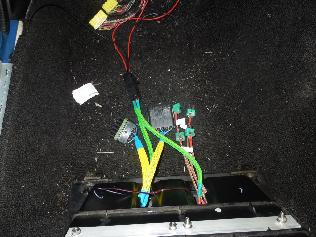

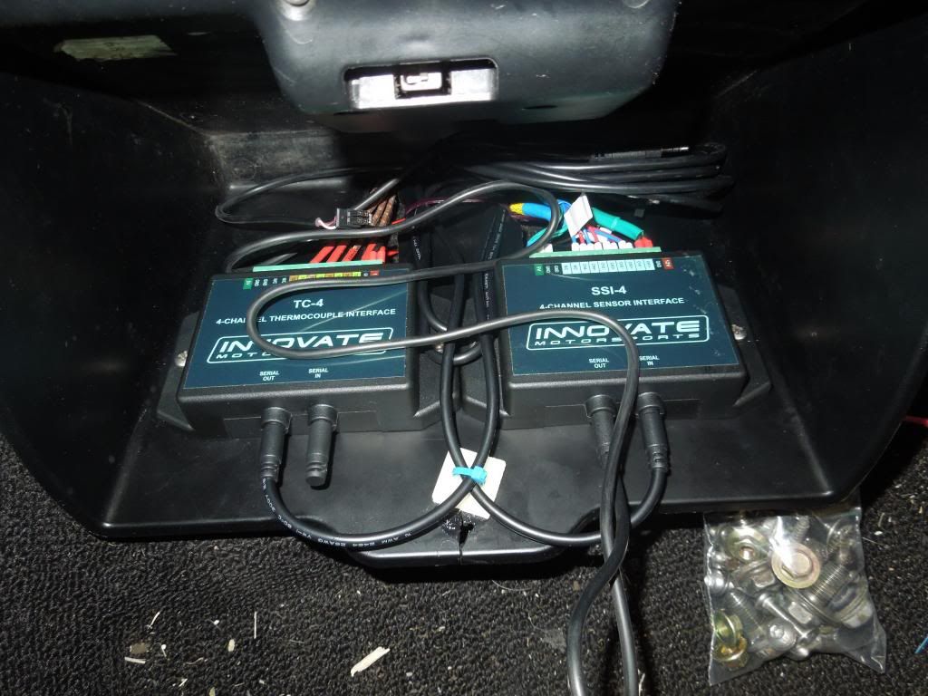

Glove box - TC-4 (exhaust gas temperature x 4) and SSI-4 (brake, fuel pressure ,TPS and 1 spare channel). Bootlace ferruels have been used to connect to the innovate stuff (with the exception of the Type K Thermocouple)
Back of the glove box (connectors)

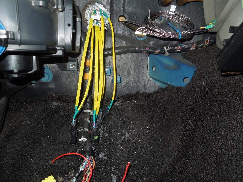

Firewall connector and the exhaust Thermocouples. Other hole is for the ECU wiring.

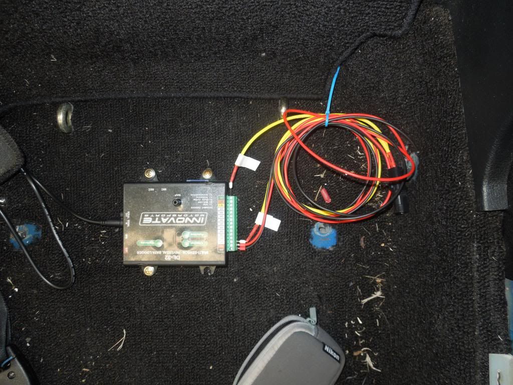

DL-32 (data logger, G forces and 3 spare channels) is now behind the passengers seat. It was under the drivers seat.

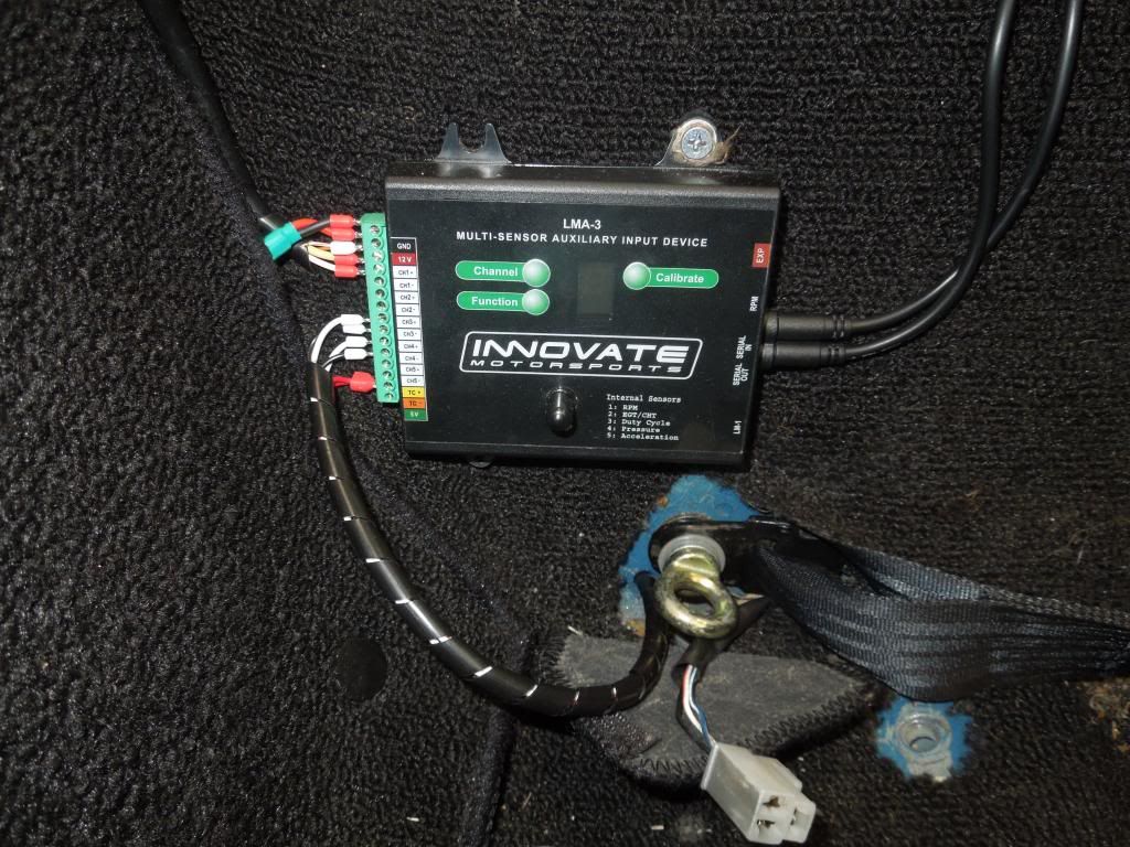

LMA-3 is on the gearbox tunnel drivers side (RPM, front/rear ride heights, speed, gearbox thermocouple).
