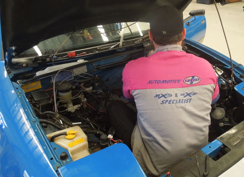

Postby Magpie » Sat Aug 24, 2013 12:50 pm
Whilst the engine bay is not completed yet there is signs that something is happening :)
