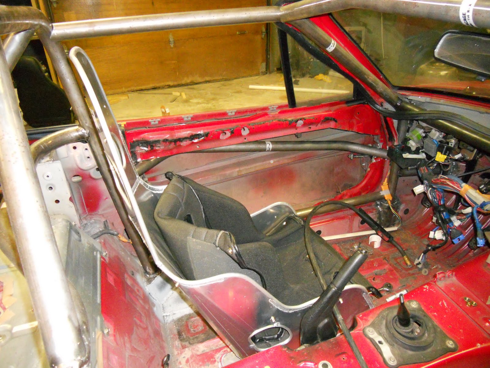

Now that is interesting... Time to check the rules. I cannot have a fully tubular construction or composite monocoques and I have to retain the original firewall. The key here could be 'FULLY' tubular, could be partial...
DSCN9885 by Eipeip, on Flickr
DSCN9887 by Eipeip, on Flickr
Found in the drain tubes
DSCN9880 by Eipeip, on Flickr
Yes a 5c piece
DSCN9881 by Eipeip, on Flickr
Could see some of the front brace being replaced/removed
DSCN9889 by Eipeip, on Flickr
All this can be removed to allow the cage to be fitted "Modifications can be made to the firewall for transmission clearance, wiring or roll cage"
DSCN9890 by Eipeip, on Flickr
Only need the hardtop mounts, rest can be removed to facilitate the cage
DSCN9897 by Eipeip, on Flickr

Keep the suggestions links coming. Have sent an email off to the rule makers to ask what cannot be done. Have started to ask for quotes for a CAMS cage. Suggestions appreciated as well.
DSCN9916 by Eipeip, on Flickr
DSCN9912 by Eipeip, on Flickr
This is what I am thinking for the doors. "To fit the cage and to make egress safer, the windows had to be removed to fit the cage. Hence why lexan windows were needed"
