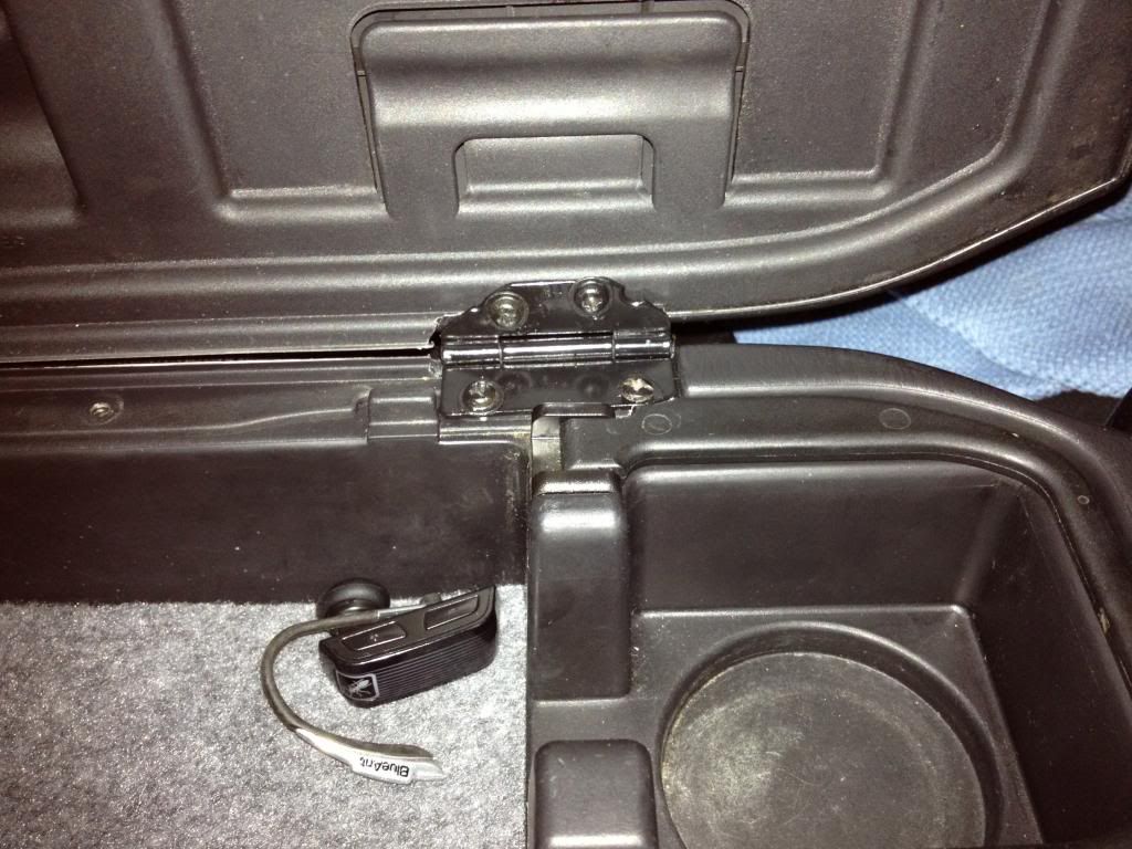

When I got the car I found the center console box had a broken plastic hinge that runs down the passenger side.
Looking around at options I found that a new lid was a $200 option or there are some 2nd hand pieces available but thought they would probably be close to failing also as they are a flexed plastic hinge.
So opted to do a little repair using a 50mm hinge.
This is the finished result.
I fixed a hinge on the inside with a little trimming. I needed to slot the hinge holes in the end to get the alignment correct.
