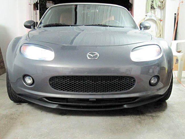

Eyelid
Got them from I.L.Motorsport. Depending on the position and angle, you make your MX-5 look extremely angry or extremely sleepy
I recommend sticking them to the headlights before sanding & polishing. This prevents you from bending the plastic (or cardboard?) which left these vertical lines in my finish.
Lighting
Philips BlueVision Ultra, along with complementary blue park lights. Will be putting them soon, I’d probably remove the air intake to get better access. Is anyone running these?

BBS RG-2
If all goes according to plan, I'll be getting the set of BBS from Dean after he finishes refurbishing his set of RS's. I'll be borrowing a guard roller and a heatgun from a friend shortly before going for a proper alignment at Spinning Wheels when they're fitted.
This is pretty sweet, don't you think?
NC Front Lip
Bought this lip http://www.ebay.com.au/itm/130750659160?ssPageName=STRK:MEWNX:IT&_trksid=p3984.m1439.l2649#ht_6286wt_1137 from Germany and still waiting. It will not be a direct fit but with some work, I'm sure I can make it fit. Will post progress pics when it's fitted.

mate you did a really fantastic job on the bumper! I've done a paint job before and know how time consuming and difficult it can be! I was also considering that lip once upon a time. Looks great for the price
Love the wheels! Any chance you could help me roll my guards too??

Credit to you to attack your panels with sand paper etc. You've definitely got cojone fortitude!
I think those gold calipers would look really nice with the gold detailing on ohlins

That is an excellent job with the front bumper.
Katzkins leather seats get a good rap in the US. Leather is softer and easy to fit (you are a classic DIY man). $600 a pair in the States?

Nice looking car!
How are the lights? I had the whiter ones and couldn't see very well in rainy weather. Changed to HID's recently and they're much brighter in the dark!
