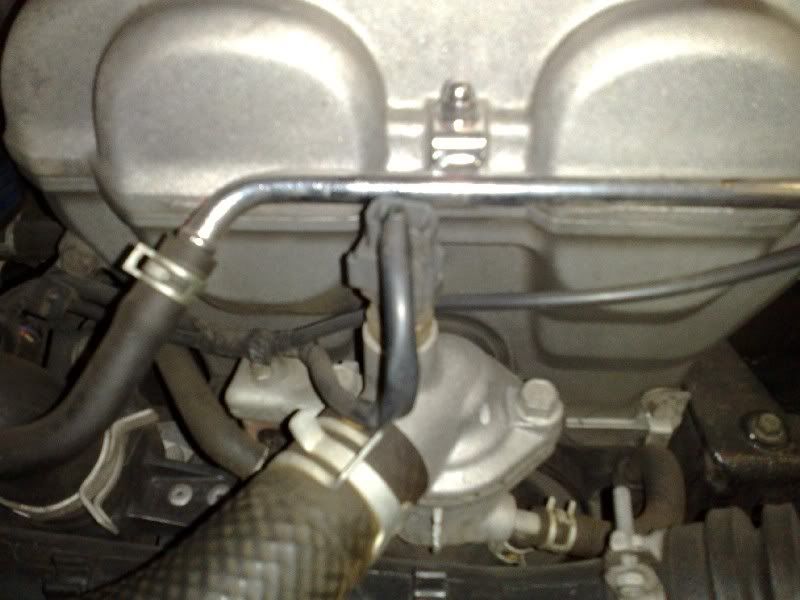

OK... another drama emerged this evening.
You may recall engine overheating I had experienced as a result of an old rubber seal that had created an oil leak.
Well this afternoon when I was driving out of the world square carpark... the temp gauge started rising past the regular temp. Here we go again...
I managed to get the car out of the carpark and pulled over on the nearest side road. I found myself on Dixon ST near the old Harbour Twin Cinemas and parked there for a while. Couldn't do anything but wait for the engine temperature to drop before I could check what was happening.
Took the opportunity to have dinner whilst the engine cooled and when I got back an hour later I started doing some checks.
Dip stick - Revealed that there was still oil in the engine (no signs of leaks as it was still full) - I had my car serviced at MX5 Mania 2 weeks ago so it's a good sign that the oil is still there and super clean too.
Radiator - Full of water and the overflow bottle is full of fluid too. No radiator leaks present.
Then I checked the Temp Sensor (may need to get the MX5 Gurus to verify this is the sensor)
When I opened it up:
I found condensation at the bottom of the sensor. There was close to 3-5mm of water at the base of that tube.
I find it strange that there was water in there... Could this be the culprit behind my wacky temperature readings?
One other thing I had noticed was a rattling tinny sound coming out of my engine bay when I cold start the car. Had this checked out and apparently the exhaust is loose. Mania didn't have a spare hoist at the time so I thought I'd get the rattling fixed up during my next service (but XXXX is it annoying). Could a loose exhaust also raise temps under the bonnet?

When I had the car inspected again, the culprit to the overheating is a faulty Thermo/temp switch.
The switch isn't turning on the radiator fan... so if I'm stuck in peak hour traffic or driving very slowly (eg in carparking stations) there isn't enough airflow going through the radiator to cool things down.
$50 later... I had resolved the heating issues... This was a few weeks ago when the whole drama was unfolding.
Last night, the engine bay gremlins struck again
Again during peak hour on the way home from work, my car started to show signs of overheating... I pulled over to this Motel on Victoria road in Ryde (near the putt putt place) and waited for my car to cool down. The radiator fan wasn't working again. I turned my AC to full blast, left the bonnet open and drove on... That helped stabalise the engine bay temps until I got home.
After another morning @ Mania, we discovered the fault this time was a busted motor within the radiator fan. Had that replaced (as well as the indicator flash can which was causing issues with my blinkers) and that should be all the issues addressed at this stage.
As much as I love this old girl... I'm finding it hard to stand the menopausal dramas associated with keeping her (hot flushes, tantrums, issues with peak hour traffic etc)
