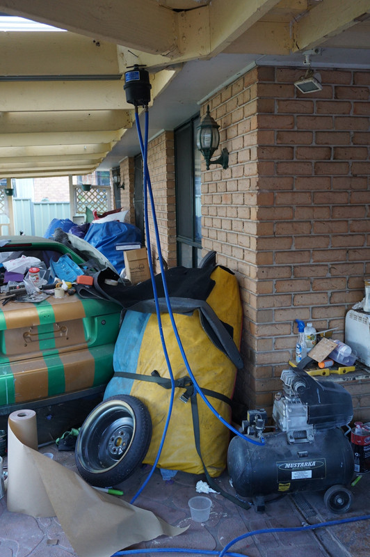

You use one of those don’t you? Is it best to fit it as close to compressor as possible or midway along the airline?

jokes aside I hang mine 2 metres above the compressor. just took you a photo. I could have tidied it up a bit but I thought i'd shoot it in its natural habitat :lol:

don't forget to run your compressor for 10 or 15 seconds and turn off. then-undo the tap underneath and let the air or water blow out -that's less moisture to travel up the hose. either way you look at it that filter will be well worth the investment
mine was pretty damp from the spray job . I would probably remove the hard type roll it comes with and replace it with a good quality toilet roll-maybe sorbent :lol: either way I thought the toilet roll collect the moisture better than the harder type roll it comes with.
so far on this spray - not a single droplet of water has come out the gun and at times I have witnessed mini streams with those poor quality water trap crap :lol:
