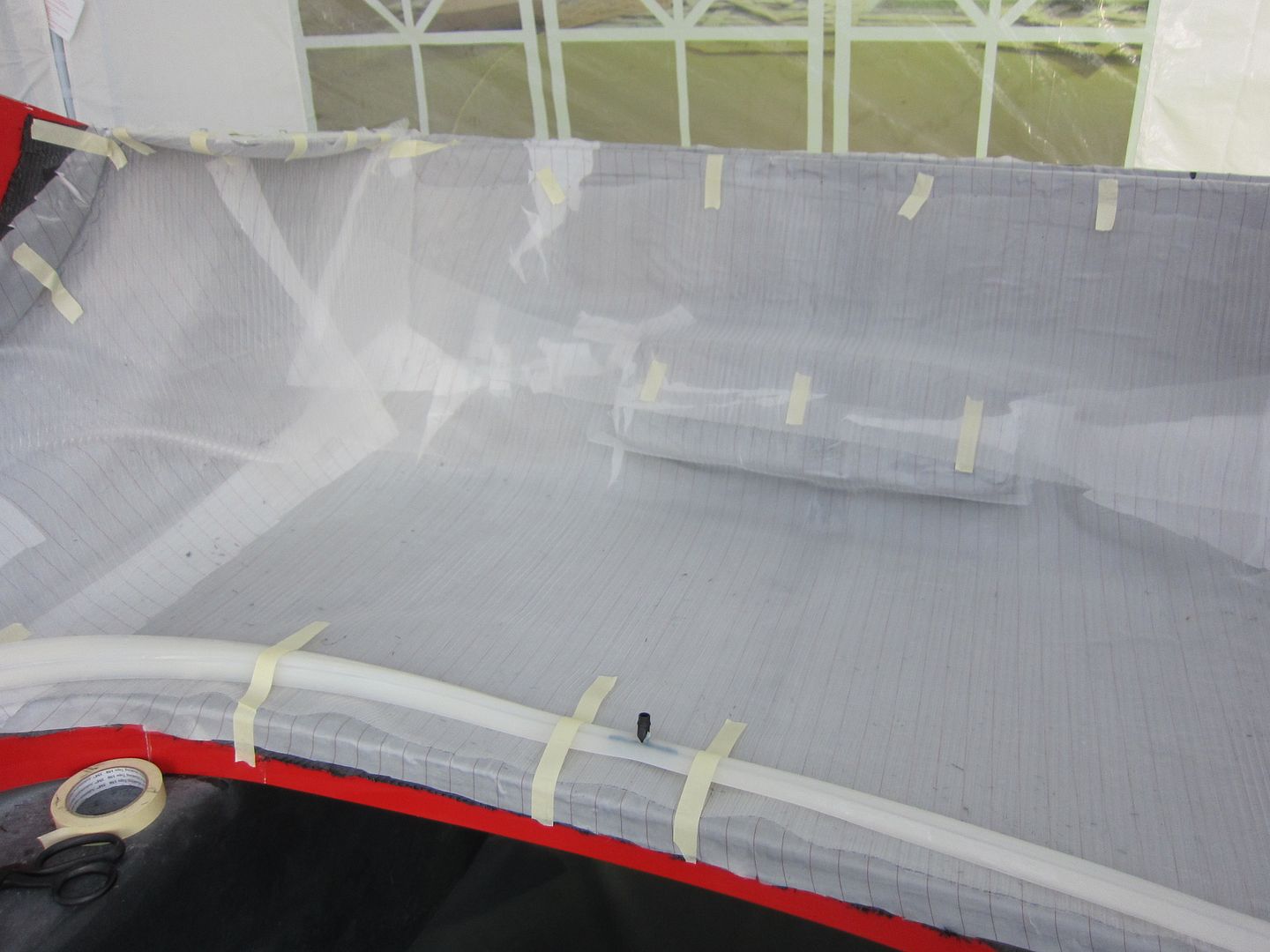

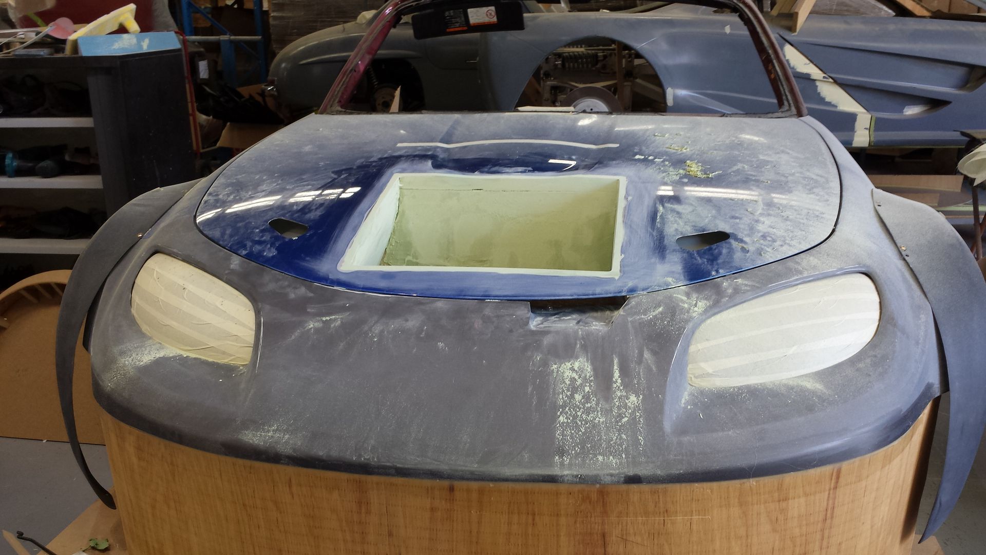

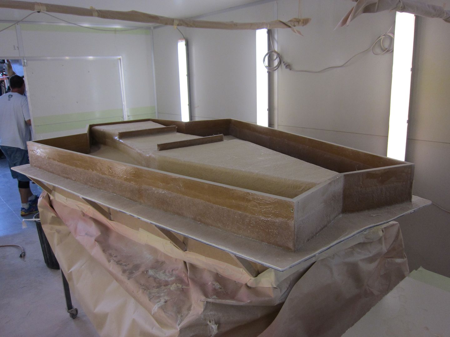

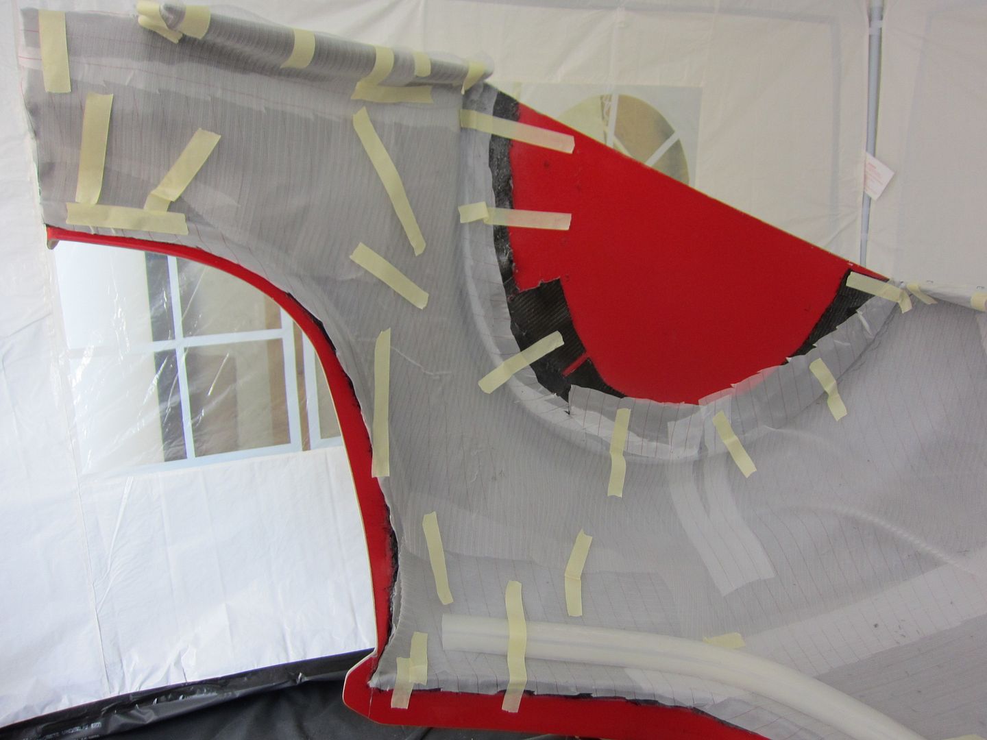

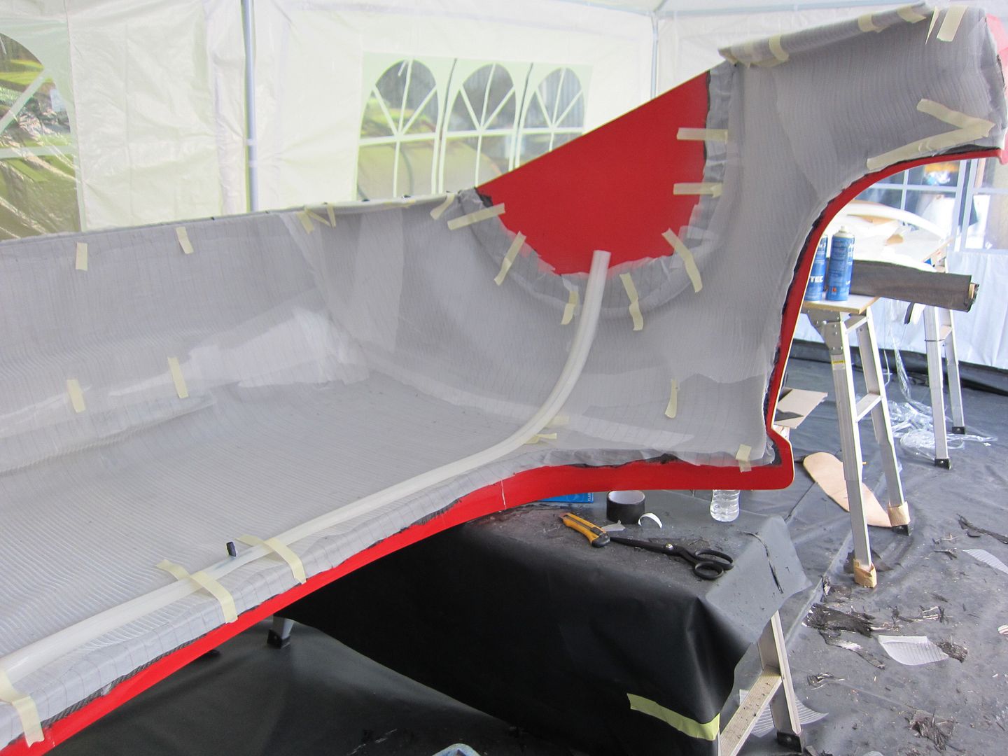

These photos show the mould with all the layers of carbon in position, the peel ply on top and the vacuum and resin distribution lines in place....all ready for bagging and vacuum to be applied.
This is one half of the side skirt moulds finished.

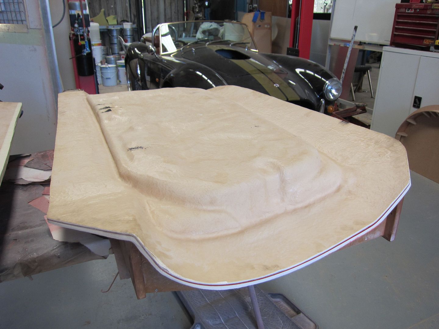

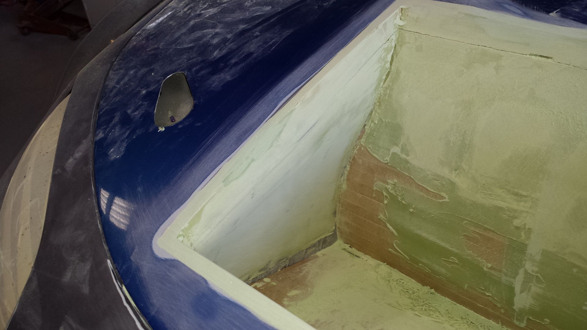

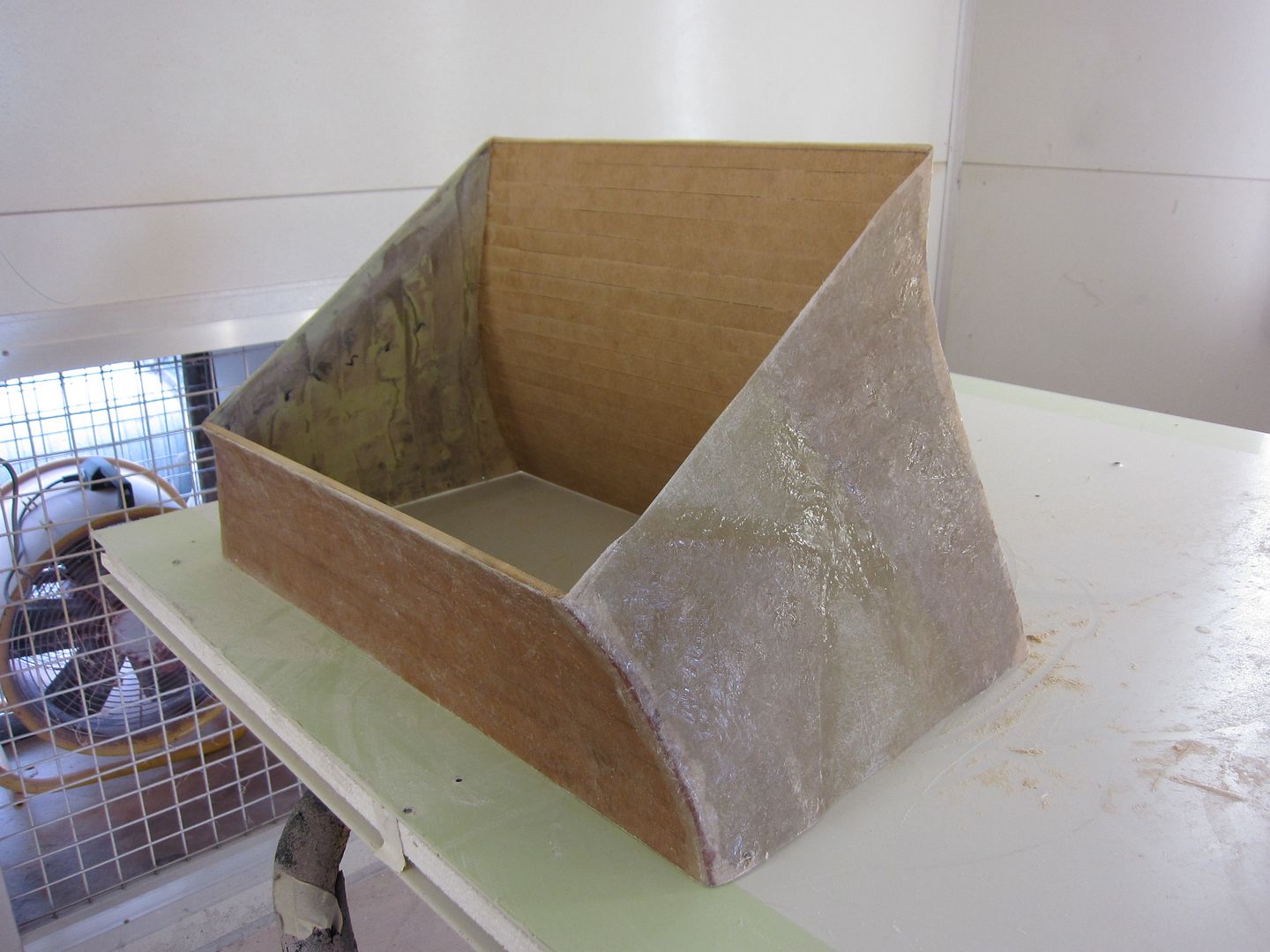

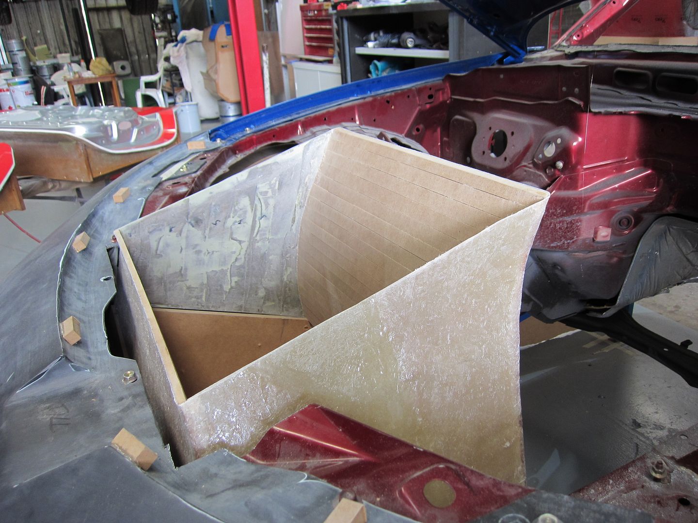

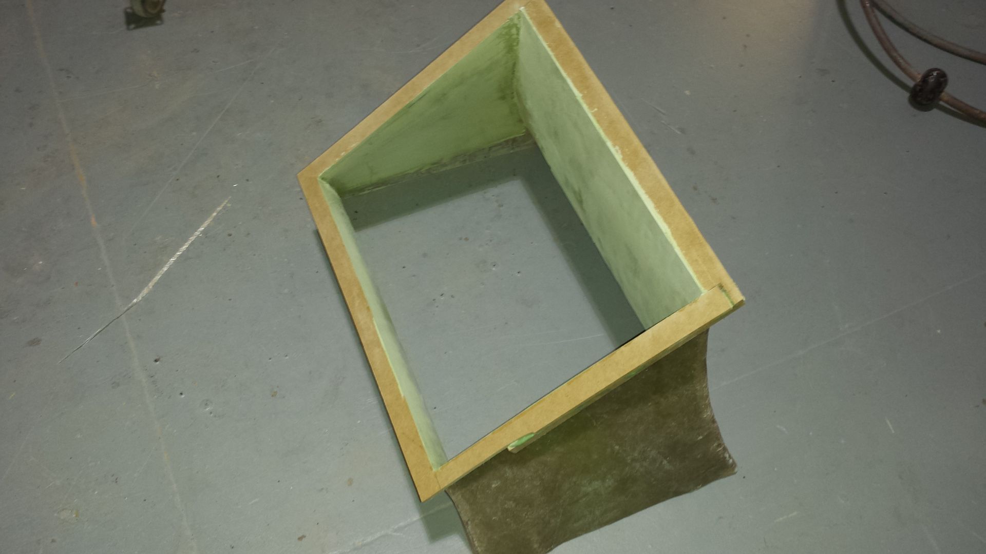

The plug for the heat duct almost complete.
Smoothing all the surfaces out.
Flanged!

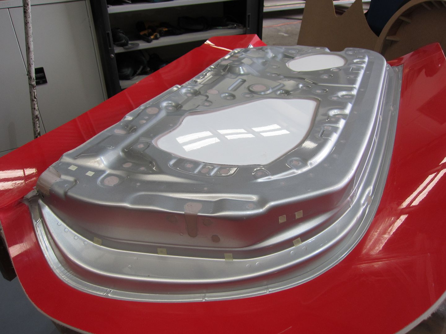

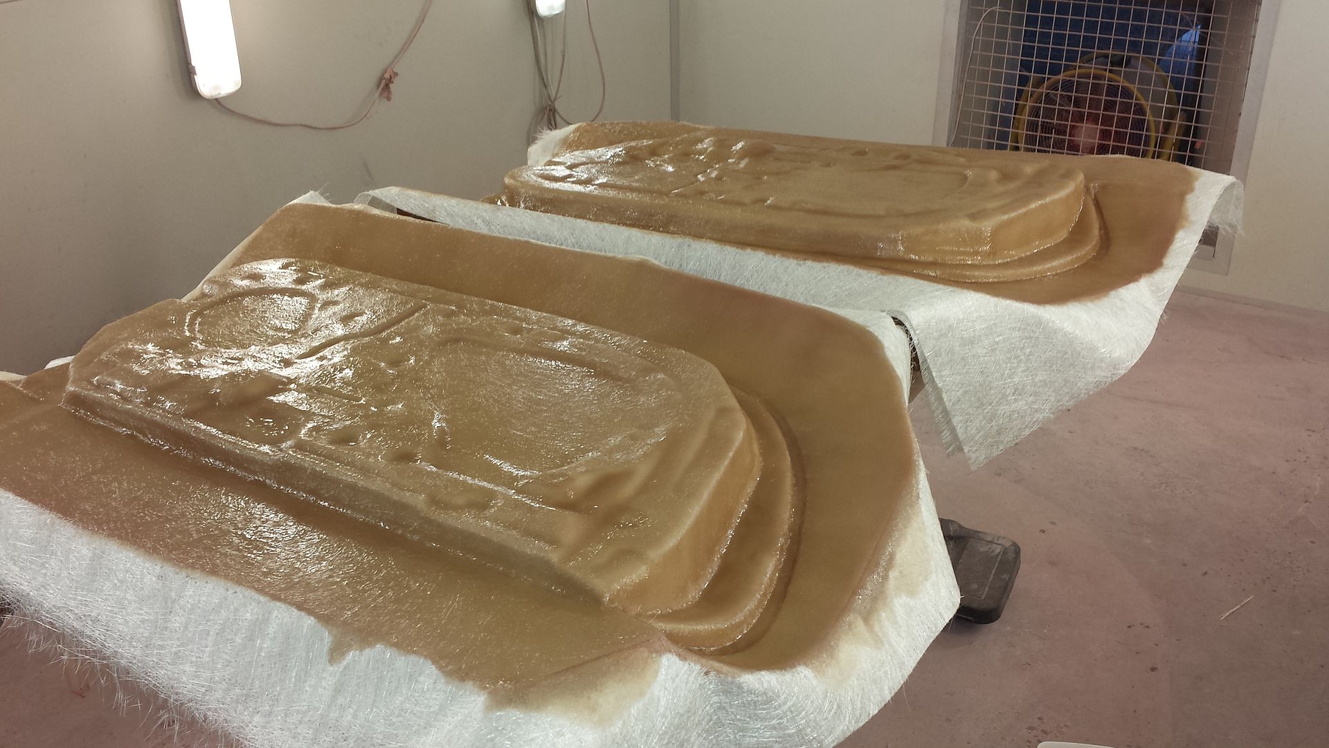

With the mould for the door's outer skin completed, it was time to mould the inner skin.

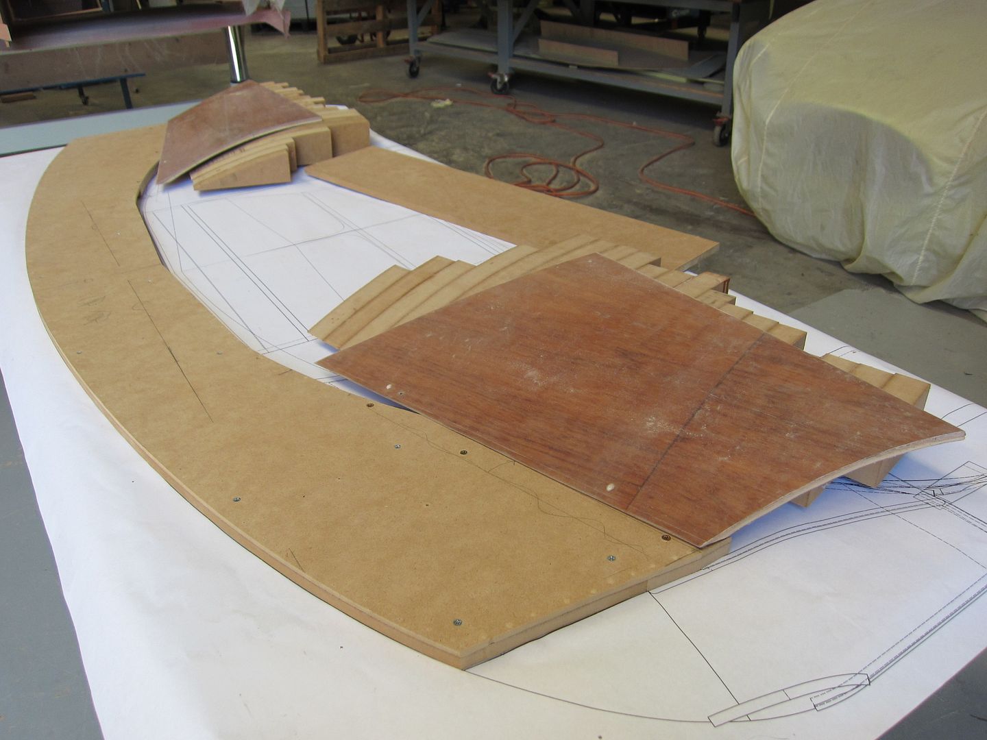

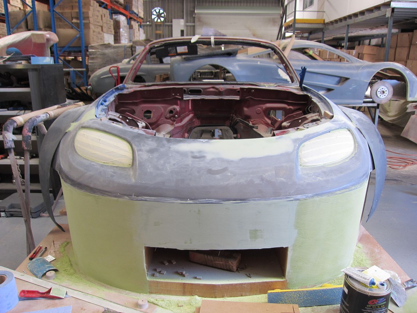

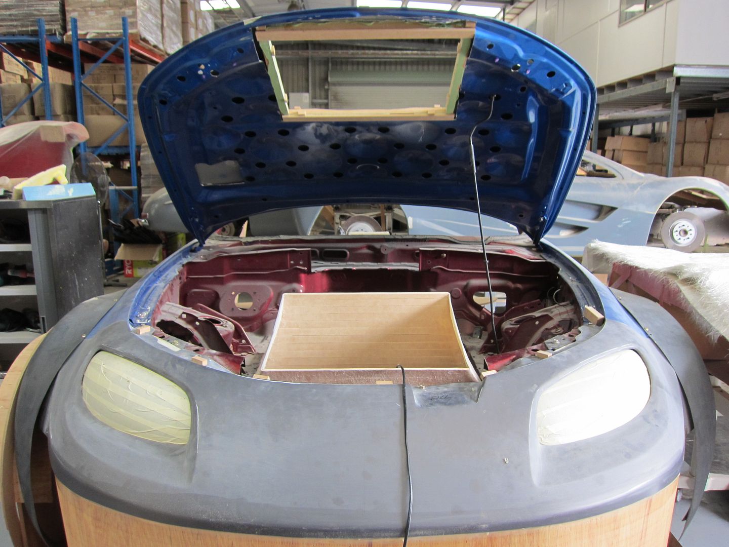

The plug for the front splitter in progress. NB this did not make it into production for WTAC 2014.
Front plug progress photo.

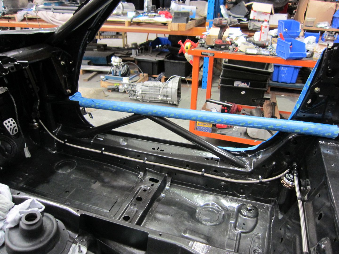

Plumbing of the air-jacks was almost completed. Just the supply line to be done.

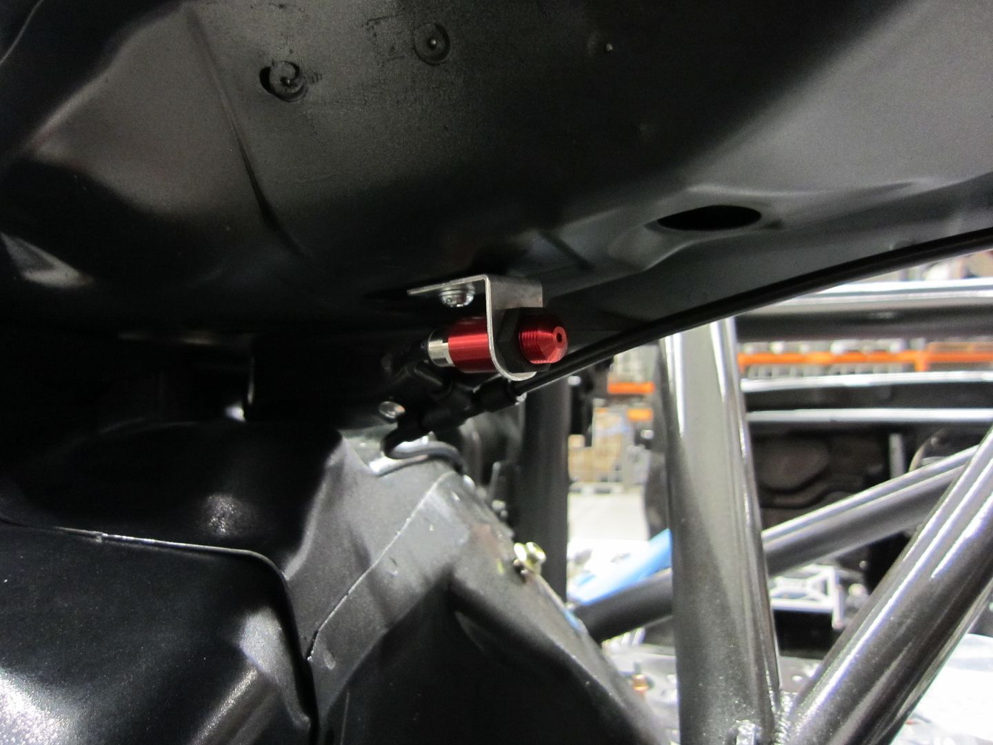

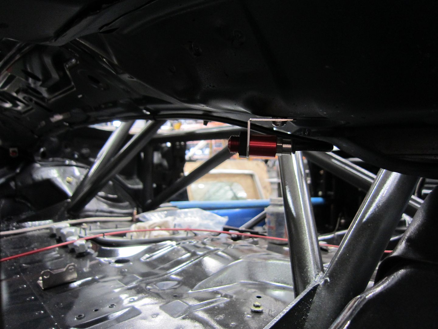

Two fire suppression nozzles were fitted in the boot area direct at the fuel and oil systems.

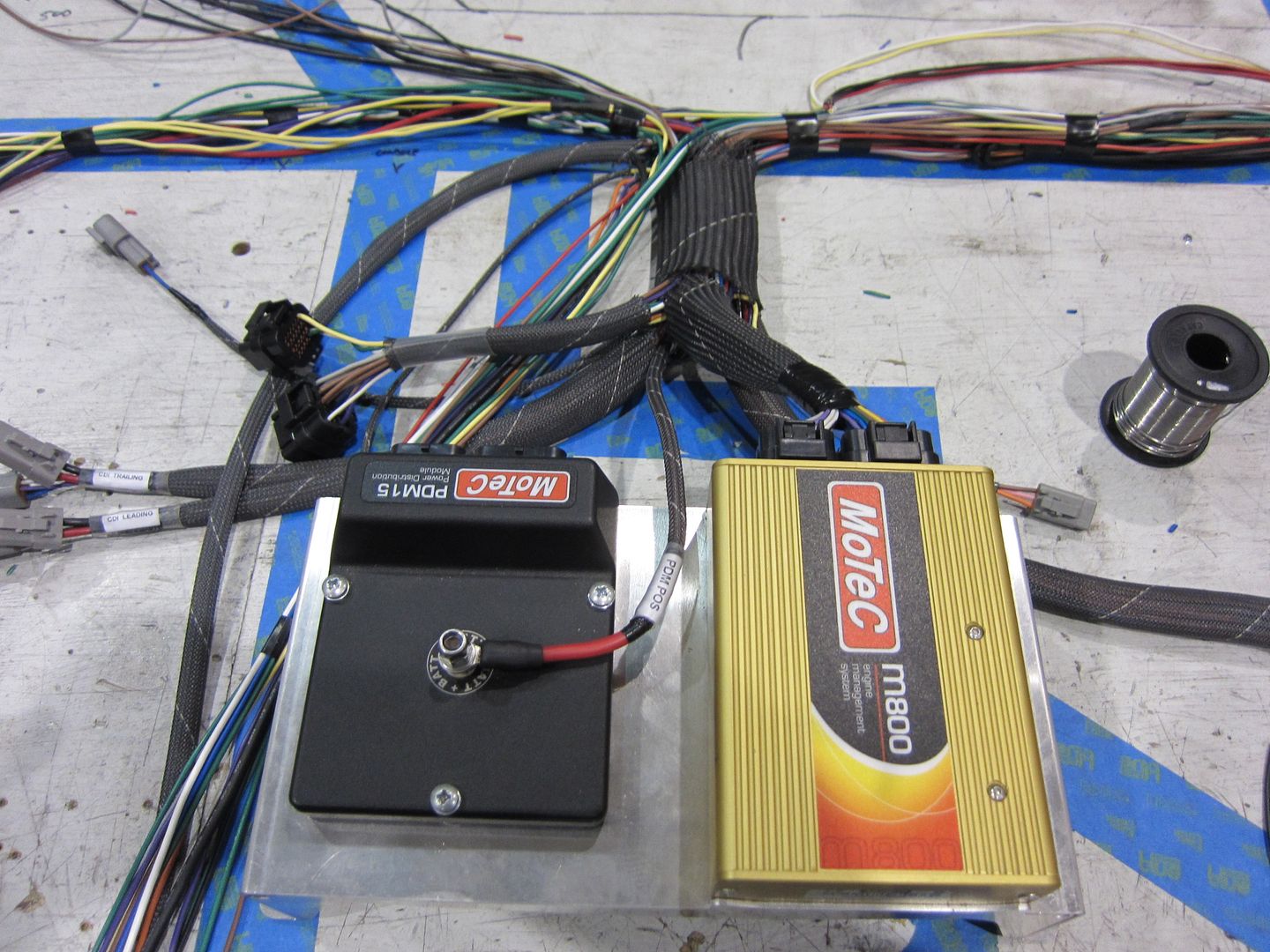

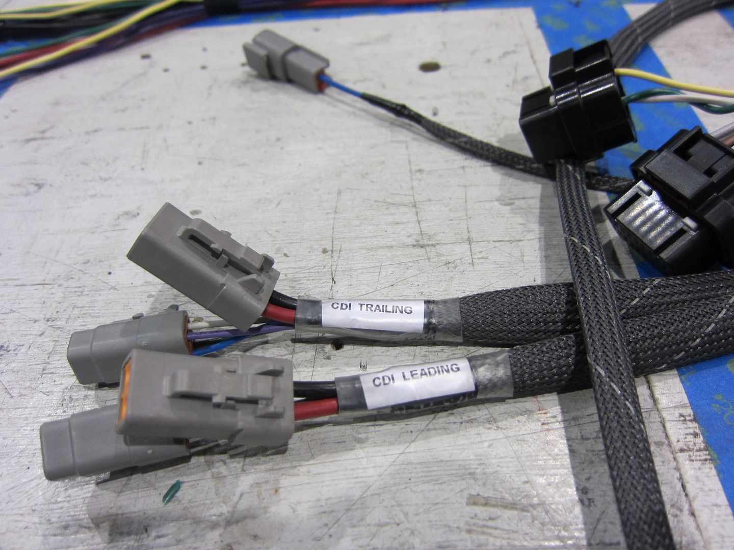

A couple of progress shots of the wiring loom.
Flanged!

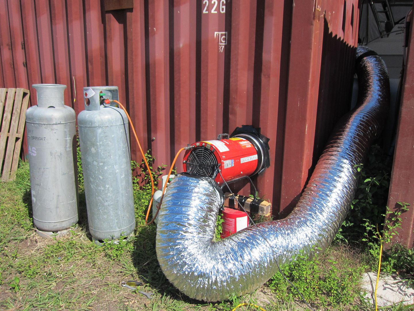

To post cure all the carbon components we modified a 20ft shipping container to be a gas fired oven.

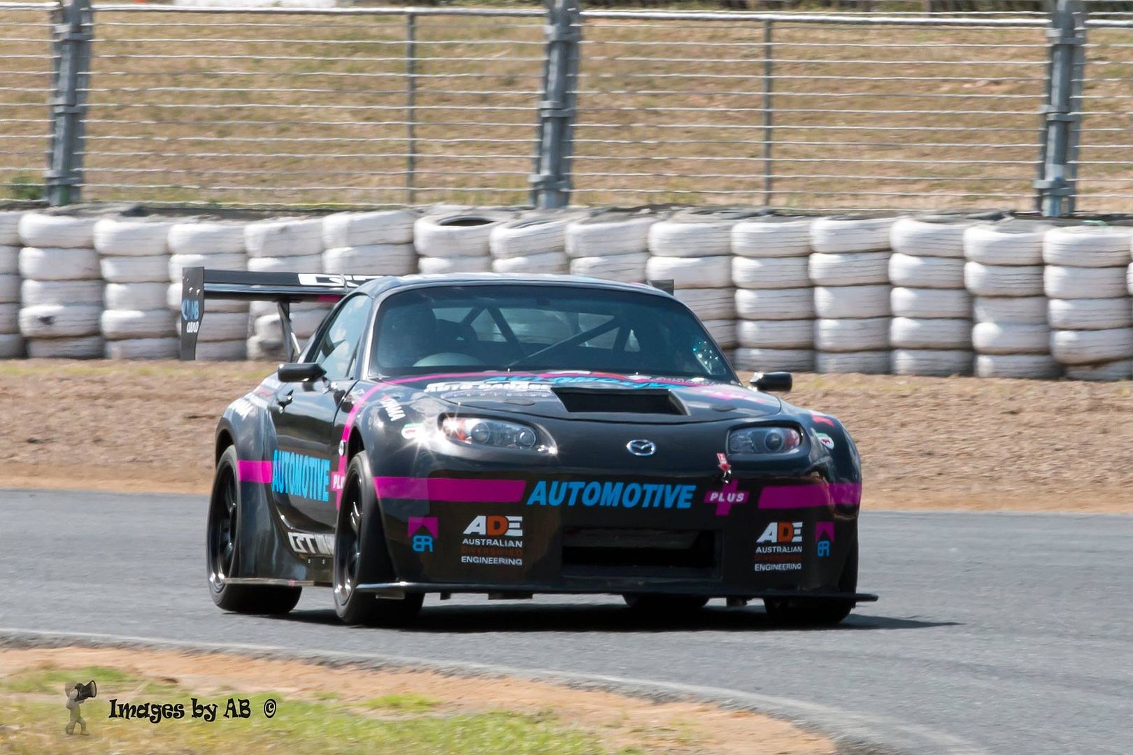

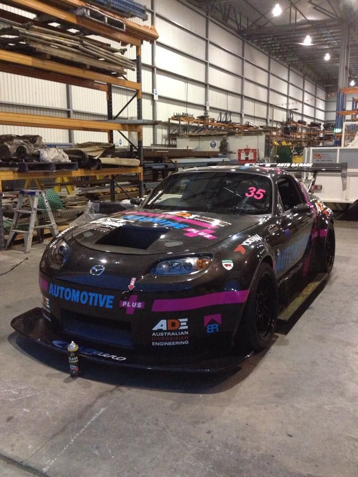

Had a really good test day out at the Maximum Attack event at Queensland Raceway on Saturday.
This was the first time I've had the car at QR so I was really excited to drive at a circuit I knew. The few bits and pieces we addressed after WTAC 2014 went very well and uncovered a few more bits and pieces that need addressing.
By the end of the event I had achieved what was previously known as the Holy Grail in the local Time Attack series. This is when you complete a sub-60 second lap of the Clubman Circuit....and I was stoked to do this at my first QR event with a 59.3986 second lap.
Here's a few photos from the usual culprits....
Here's a short video of a few laps (early in the event) before my camera died!
...and a well put together video summary of the event.
