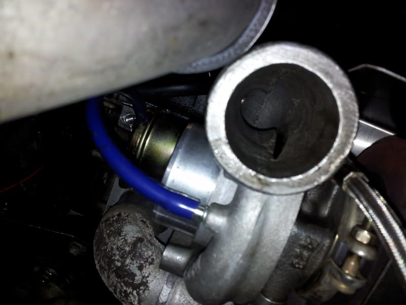

Few little issues while i was just checking things this morning while still waiting on my silicone adaptors
i decided to pull the hot side pipe off the turbo for a look.
Bit of oil, as i expected.
After full boost and the engine goes into vacuum i get a bit of a oil cloud.
But i looked inside the turbo and saw light coming in.... little odd.
Turns out there was a little allen key bolt of the housing which i guess has fallen out.
Luckily it must of fallen out not in the turbo.
So i will grab a small bolt today to fit there.

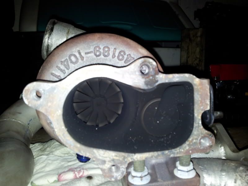

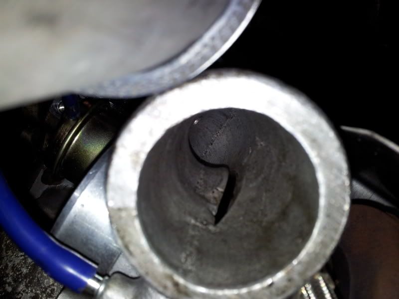

Also noticed something i do not think i noticed before but i am not very observant
Is that split meant to be like that inside the housing?
Just i seem to get far better answers on here than elsewhere."

yeah dude its the end of the ... ah... vortex-ie... bit.

Thanks Dann!! I was a little worried when i saw it

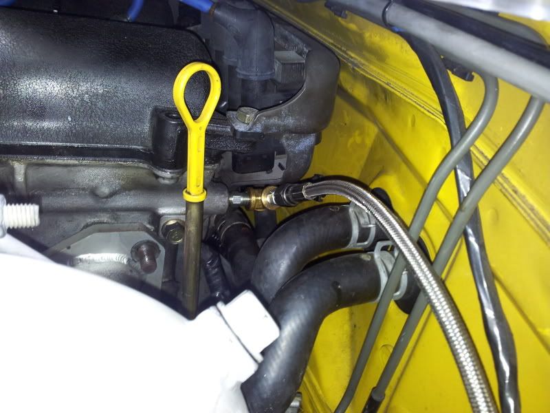

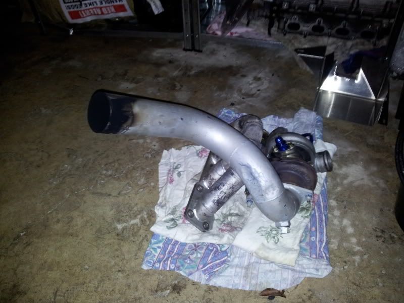

After going over the engine bay a little this morning i decided there was a few things i kind of wish i could have done when we installed it but couldn't for various reasons.
With the car off the road till i get the intake Silicone i decided to fix-er up.
Was funny that it took hours to install yet within 40 mins i had most of it off.
Turns out all i have to do is disconnect the mid pipe from the cat and down pipe, then remove the manifold nuts and i can pull the whole unit off.
Because i did not have the correct fittings we took the oil feed from the back of the B6 head.
Seemed to work fine, not sure why no one else uses it as it is really easy to get to.
But i figured i might as well get the right fitting and use the normal port down low on the block.
So off to ENZED, apparently they can not get the correct adaptor so they are going to weld me up one using the original bolt that was in the block.
I have asked them to make the feed hole -3AN size, should be the right amount of restriction to hopefully stop the high boost oil cloud.
Turns out the fitting i was using was -4AN so at 60PSI of pressure, it could very well be too much.
I am also going to install the STAGE 8 locking tabs this time and i will replace the heater hoses so that hopefully they will not prove to be problematic any time soon.
They will need some heat protection as the downpipe is might close to them.
My poor turbo got dirty very quick!!! haha
Not sure what the shiny little metal bits stuck in the rear housing are . A little concerning.
I do worry a lot
Anyways, ENZED say they will have it ready for me Saturday morning.
Can all go back together some point on the weekend and hopefully will be all sweet.
I do worry a lot
