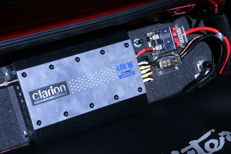

I've had several different amp setups, I currently have a tiny clarion amp attached to a board in the boot. Is been designed so that with a couple of wingnuts and plugs it can be removed within minutes for motorsport.
