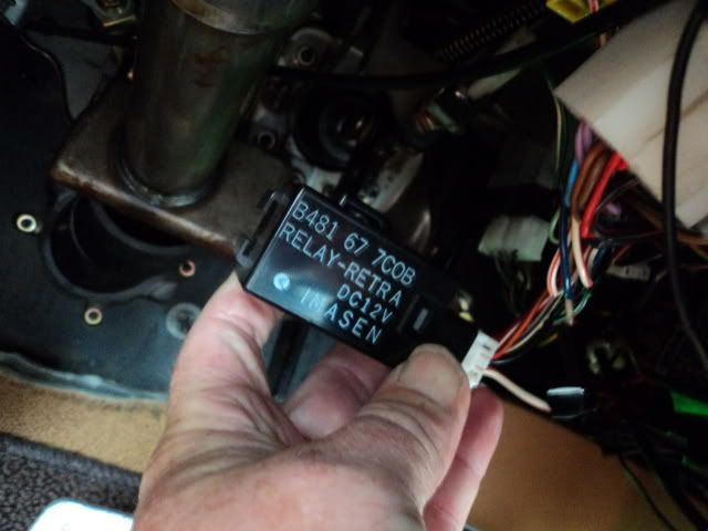

I've had the same issue, pretty sure it will be this lil bugger... open it up & it'll probably smell fryed
