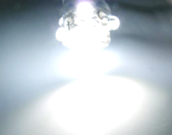

Stu wrote:I have now replaced the rear plate lights and front parking lights with LED's.
I went for the pure white LED's with 6 LED globes that I got at Autobarn.
Stu, are they similar to these LEDs (parkers)?
They are available from eBay.
And here are the tail lights:
Do you mind me asking how much they cost from Autobarn?
