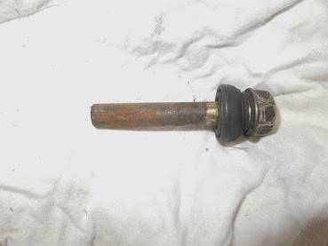

Slider pins possibly. If changing the fluid you may as well check these as well.
When I did my calipers a while ago I found this. I make sure every few months or before every second track day I grease the pins. Another lesson is to have some spare slider pins on hand in case they need to be replaced and nothing is open.

Noted. thank you.
