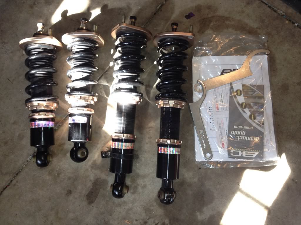

Just got new BC coilovers and removed my old suspension.
I can't align the new coilovers so the lower bolt threads through the coilover and control arm.
The old suspension bushing looks to worn at a angle where the new one is straight.
An tips to getting the bolt holes aligned?

So they look like these:
Release the bottom lock ring so the hole in the bottom of the damper can rotate, this should give you enough play to put the bolt through then just tighten the locking ring up again.
