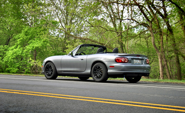

17" rims should NEVER be put on an an NA/NB unless it's just for stance or photoshoots - they're heavy, ride/handle shithouse and I'm one of the many SE/MSM owners who gladly upgraded to 15" rims and will never ever go back to 17s.
16" rims are aesthetically the best for NBs which is why they came that way, unfortunately tyre choice is limited and more expensive than 15" tyres.
15" rims on an NB give it the 4WD look:
You will need to lower your car to fix that (via coilovers or lowering springs).
