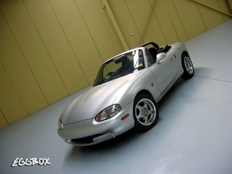

Hammer you got a NB right?
From what I read, NB can go up to +25 offset with 7\" wide rims.... best offset is +35
Me and Jolt run offset +25 on our NBs.....
Jolt has 16x7 volks
and I have 15x7 centra
and 205 wide tyres will cause rubbing on the guards
Plenty of Japanese and german rims have a wide range of offset to choice from... like you suggested Simmons do custom make offset and width on their rims
Garry

how about the volk's te37 cup?
GOT DISH?
this is 15x7 offset+25
