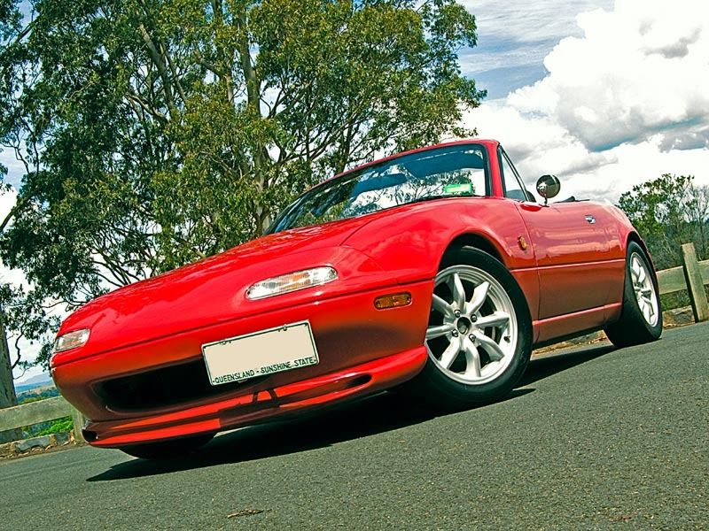

Been trying to understand a bit of photo fixing techniques in the ole Photoshop tonight, so thought I'd post one here given the recent wheel acquisition.
Watanabe F8's, 15x7 +36
