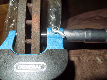

Thanks, I will measure them and see what they are when I get home. It will not be worth machining them it they are just on the service limits.

Well good news the fronts are 21.57 mm each and the rears are 9.58 and 9.52 mm. The disks have what is the minimum thickness cast into the inside of the rotors and for the fronts it is 20mm and the rear is 8mm so I have more than enough.
