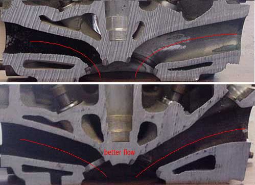

And am tossing up buying a NB8A Head and intake Manifold or staying with the NA8 Head.
This is the difference between the 2.
Most articles i read state that the NB8A BP4W head flows far better and the intake manifold helps with this also.
Some people i talk to say that in fact is not that big of a difference and that maybe my $$ is better spent on my existing head.
The Solid Lifters may also be of benefit in the BP4W.
Again, i would love to hear any views on my plans.

Manga_Blue made some useful observations about the NB8A BP4W head after he tried to source one a while back:
viewtopic.php?f=29&t=48320&p=611433&hilit=head#p611433
viewtopic.php?f=29&t=43856&p=557701

Spoke too two engine builders (woz being one) re the late head. Both said... Eh spend it elsewhere.
1. Stock for stock yes it flow better, but not when ported correctly.
2. Solid lifters are shim on bucket and not full Face, so ok if you have them but not worth trying to change to them.
I believe pham spoke to garry Stewart and got similar response.

and for the lifters, i'm sure warren has been though this with you. the NB8C ones are shim over bucket. really only suitable if the cam you are running are close to the same base circle as nb8C cam ie 36mm. otherwise getting a new thicker shim will add alot of weight to the valvetrain.

Regarding the head, maybe i will just port and polish my BP05 and save the headache.
