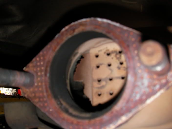

I've got as metal cat on the rotary. If you pick one up and hold it against the light, you can pretty much see thru it, so they must flow well. Also the metal substrate is stronger and can withstand heat from the turbo better, so that this doesn't happen (which is a non-metal cat that was in my car...who said rotaries are hard on their cats!):
