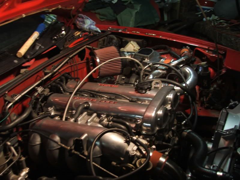

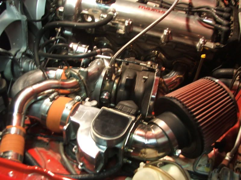

LM didn't have anything to do with Boags' funny engine bay noises, but he is responsible for this :D......
And this...

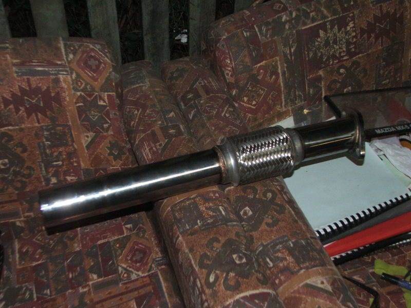

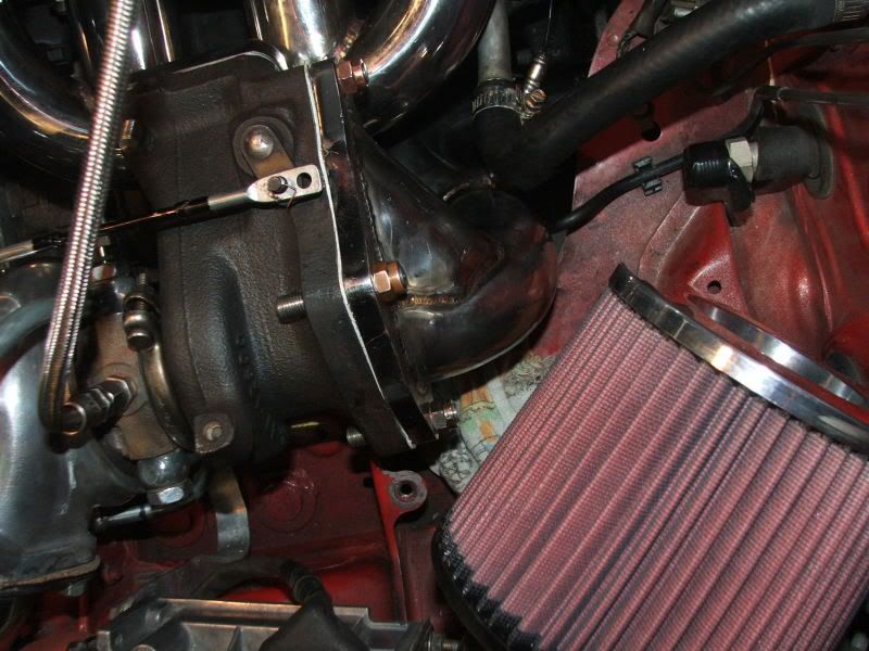

He was not responsible (directly) for this - this is what happens when aftermarket 'bolt on' parts (like the NPower dump pipe) don't actially bolt up and need extensive modification.
First it needed to be cut just to get it to be able to bolt up to the turbo. Don't aske me how much trouble we had trying to get the bottom stud connected.
Next, I have to find a way to shift the water return pipe because the O2 sensor position is right in the way (and I'm not pulling the dumppipe back off after it took an hour to fit up.
That said - we got it to start this afternoon, and the oil is happily being pumped to the turbo, and it still runs..... :D

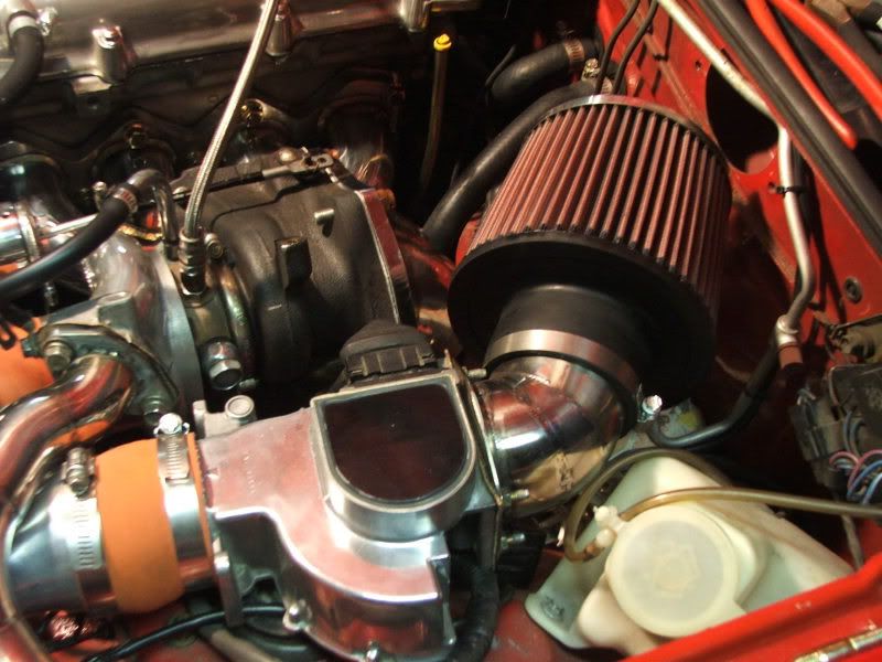

I like the air filter setup, good for a little bit more cold air still sucking from the cowl inside of covering it up again with the washer bottle.

What are you gonna do to protect the water line and air filter from all that heat?
One track day and it'll be melted/on fire (i know about that fire thing first hand :lol: )
Otherwise it's all looking very neat indeed!! Good work mate!

Postby Uncle Arthur » Mon Mar 19, 2007 10:40 am
I will be constructing a heat shield.
Just got to work out how, and get the material.
