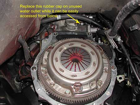

ok guys heres a challenge for ya.. i need a party number for something ive never noticed on my car before.
Its at the rear of the engine head. its a rubber end cap that ripped a little.
it sits on a pipe at the rear of the head.
ive taken many pictures to try and identify the little bugger.
end cap part number# ???

does it have a thread at all on the pipe? or is it pipe clamped?
if you are desperate find a bit of hose roughly the same size block one end, us a bolt don the tube and clamp it then clamp it onto the block
I cant say i've ever noticed the fitting and cant make it out from the pics clearly enough to jog the memory
but if it has a thread then chances are you can get something from a hose/fitting shop to block it
if it has no thread I can only assume it is pipe clamped on?
In which case the bolt in the pipe might get you out of trouble for wa while
good luck!

Part # FEA7-13-104

Postby Wuey » Mon Jan 15, 2007 3:18 pm
Yup, it's that little bugger.
Part no. FEA713104 about $4.00 from a Mazda dealer.
See list at the bottom of this page.

Postby Astroboysoup » Mon Jan 15, 2007 3:18 pm
this forum rocks...
thanks guys
esp jbt
thats the little bugger that i have to pull off and replace.
part ordered and hopefully replaced tomorrow.
