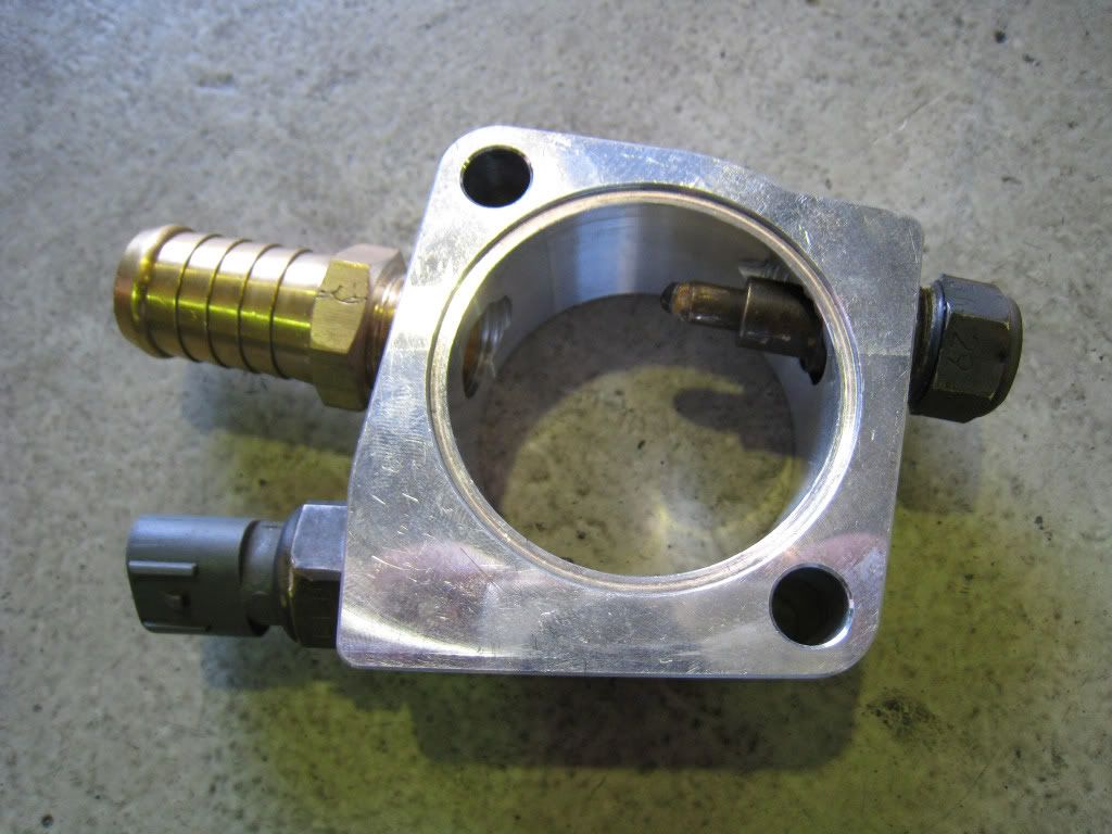

This is the MX-5 Plus re-route spacer that forms part of the hot-side and cold-side kits we are developing. There are two types of spacers, one for B6 engines and one for BP engines. The B6 spacer has provision for the heater hose outlet, the coolant temperature sender and one for the thermofan switch which is relocated from the thermostat cover originally at the front of the engine. The BP spacer also has provision for the heater hose outlet, the coolant temperature sender and a spare port for a supplemental temperature sensor or switch if someone wants to supply information to a data logger because the BP ECU operates the thermofan.
Here are a couple of photos of the B6 version.

Very nice Danny! I'm hanging out to see how you do your coldside hose routing for us hotside blower owners. :)
