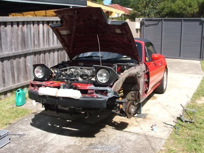

Right.
Got motivated by various things. The potential rust spots had to be adressed. I was inspired by the Grand Pubahh of JDM God DIY Mr Babaloui
This one is for you Babs. ;)
Thats the stuff. Recommended by Babs himself in his GT-R replica Build up. This is hard core marine metal rust preventer. You gotta wear gloves with this stuff. not cheap either if you buy it by the liter :lol:

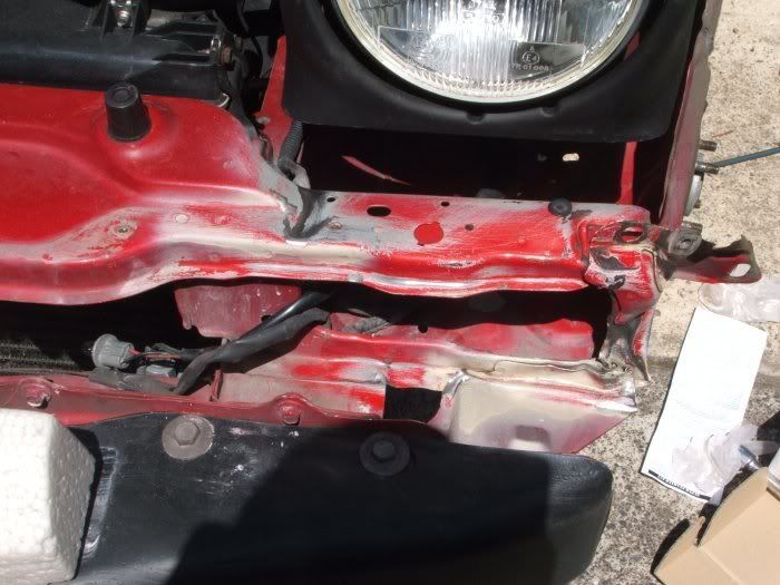

So the day started with removing the bumper bar & exposing the bits which were affected in the crash almost 2 years ago & make sure they don't rust ever. I I don't have to be paranoid about having to remove the front bumper any more.
the bit of concern is the one just underneath the headlight.
a closer look at it
this is just before treating it with marine clean but the metal brush had done some major work at that stage.
eventually it was then painted & also primed for spraying red. serious patience is needed for this 2 coats & preping it for spraying took all day.

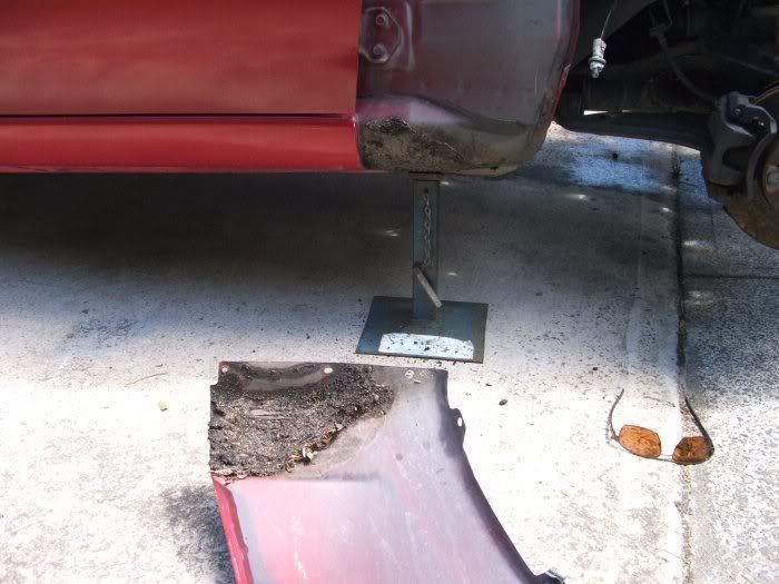

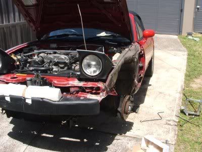

while I was waiting for the coats to dry & treatments to have thier effect The fenders came off to adress the potential rust issues there. I've been concernde about this for a few years but now is the time to adress it seriously. A half assed attempt previously need to be sorted so I can put this issue to bed for good.
this is the not so bad side. its about 18mths of build up with the inner wheel arches removed. I'm personally not sure guard rolling is such a good idera unless you remove all these leaves every 6 months or so. and or do this process.

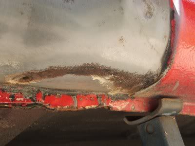

This is minor the other side looked a lot worse before the treatment. This is the driverside.
This is the passenger side during the treatment. A little more rust evident.
Paint drying time. When this is dry it looks like enamel or that stuff they put on wheels. It drys very shiny. its super hard & does not chip. not that its a concern in this spot.

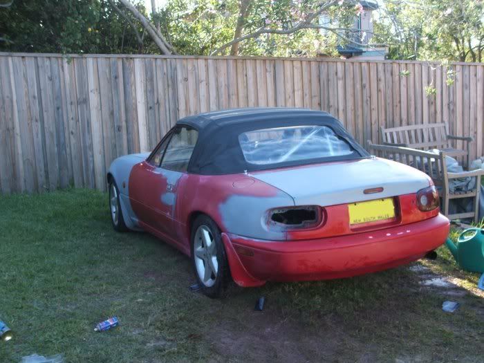

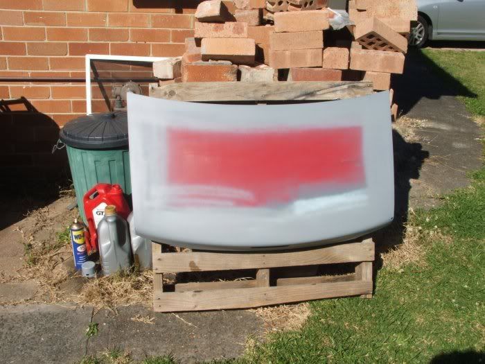

The Rod Millen Racing Boot spoiler had to come off & tidy up some slightly uneven paintwork.
Of course the screws which held on the rear spoiler wouldn't budge so they were ground off. And even though the spoiler vibrated occasionally is was also stuck on with some serious goo.....Not Double tape :roll:
so here we are removing whatever it was.....with a heat gun & of course took the paint along with it.:oops:
Its not all that bad. I have to take out 2 little bumps in the boot anyway.... probably means I'll get motivated to do some more serious work.
Patchy has been patchy for 2 years now.
