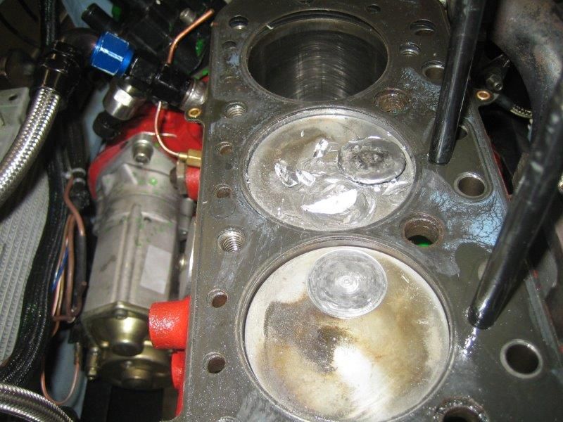

You can see where the valve was hitting the piston on all cylinders. No 2 valve head failed and fell off, bounced around a few times and ceased the motor (it was only idling when it broke). The timing was out by a tooth which happened during installation after timing had been done. There was no noise at idle, only on the track at revs.
The valve and piston were hitting above 4000 rpm but it reved to 7500 before some power loss was felt, which would have been a bent / jammed valve.
The head has been welded up, remachined, new valve seats, new exhaust valves with one intake. New pistons and bearings in the block. I'd expect to see a similar effect on your pistons, as no 1 in this photo... maybe not quite as bad as this as it was pushing some high revs.

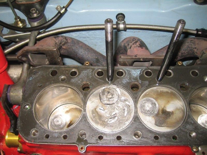

madjak
Posts: 1117
Joined: Tue Dec 31, 2013 12:11 pm
Re: Patchy's Fawlty Towers risk management. Enter at own risk
Postby madjak » Mon Nov 21, 2016 6:32 pm
This photo is better... the indent on the piston crown is less than 0.1mm so it was only just touching.

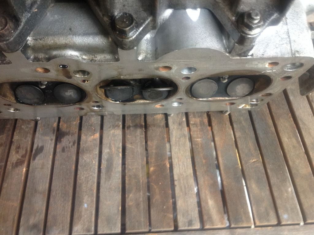

Interesting.
Looks like the valves are hitting the side?

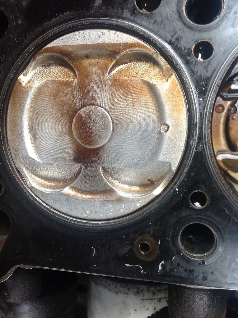

StanTheMan
Posts: 6828
Location: Balgowlah
Postby StanTheMan » Sun Nov 27, 2016 11:03 am
That's a bit of a concern :shock
madjak
Posts: 1117
Postby madjak » Sun Nov 27, 2016 11:18 am
I was going to ask if the valves were fully retracted into the head because the piston hit looked like they have been stuck out 10mm or so.
So bent valves.
Looks like the exhausts have been hitting also.

StanTheMan
Posts: 6828
Location: Balgowlah
Postby StanTheMan » Sun Nov 27, 2016 12:14 pm
The piston has also been hitting the head.
A lot of the valves are not seating correctly. But once cam is removed, they are tight in thier seat
I swapped the HLA,s on that cycilder and that has made the equal as far as the eye can tell. But they are not sealing.
I put blue tack down to check but it seems there is no interference once the timing is all correct.
Confused. :?
