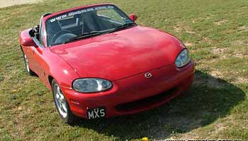

BEFORE
AFTER
Took me roughly 45minutes to do while watching tv :D I'm happy with end result
