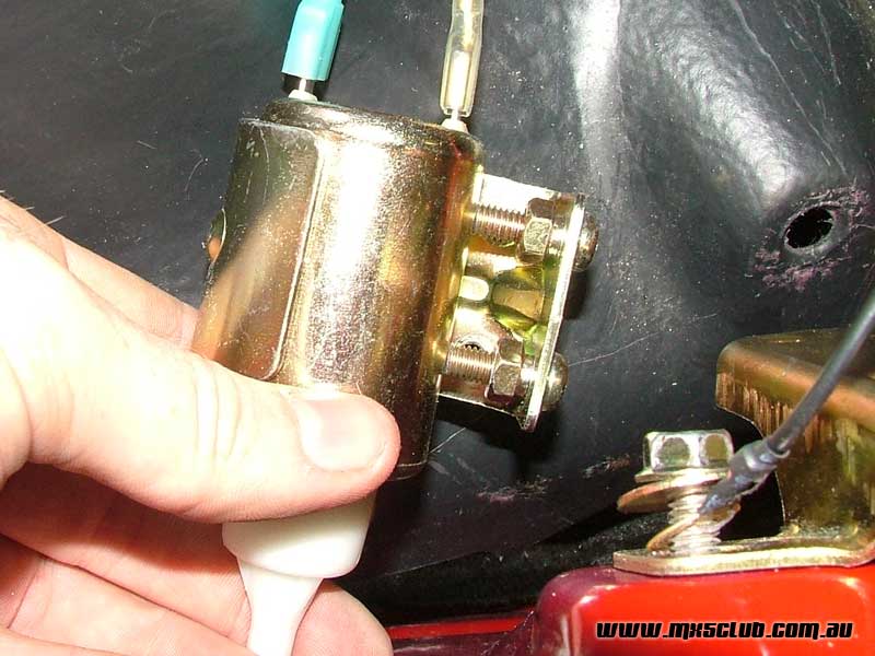

A standard central locking actuator could also be attached to this rod to pop the boot unlocked.

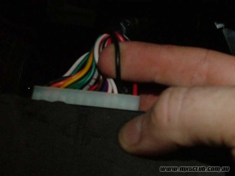

If you have the factory alarm with the 3rd blue button that flashes the indicators this button can be used to for your boot release

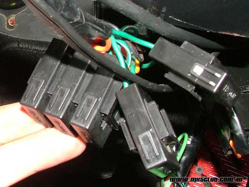

Use a vampire clip to splice into this wire to get your positive to trip the relay that powers the actuator

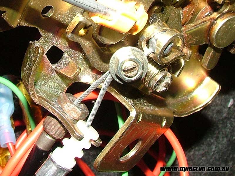

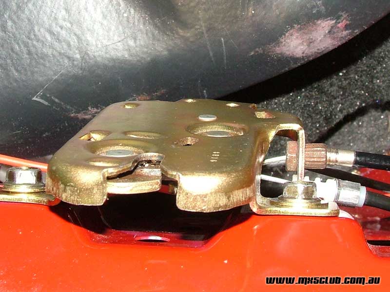

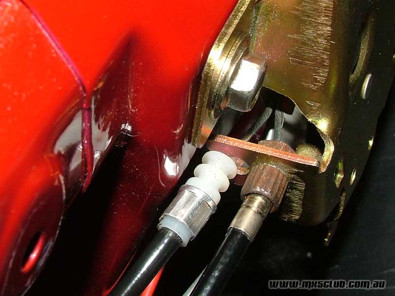

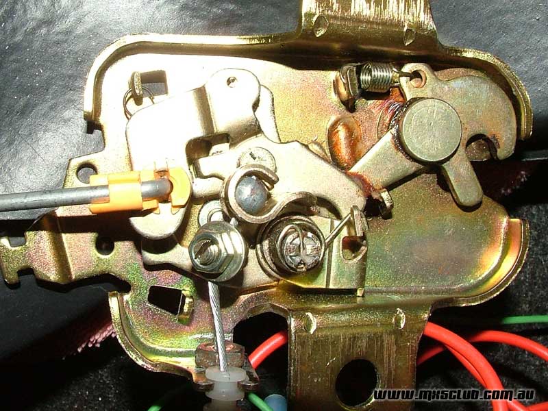

I drilled a hold in the lock near where the factory boot cable connects
Grabbed these bits off an old bike
Attached them like this

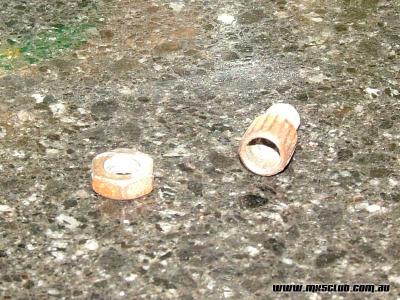

I used the cable nut that came with the kit to attach both cables together

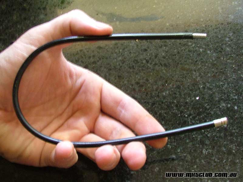

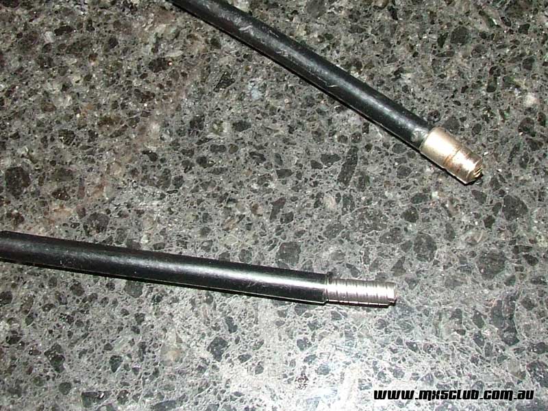

I cut a sheath for the cable

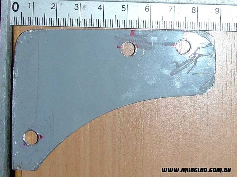

And made a bracket
Earthed the wire from the actuator

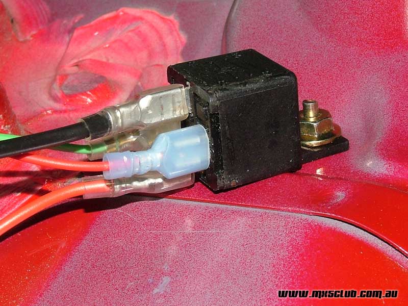

Mounted the relay
This was 8 years ago and it still works fine.

Mounted the relay
