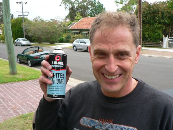

As you can see below, Garry is the expert on window lube Monsqueek... at least I think he was using it on his windows... :shock: :P AFIK he simply removed the door trims and sprayed lube on the moving parts. Maybe he can clarify for you?

Postby StanTheMan » Tue Dec 12, 2006 11:30 am
take the tracks out.
I cleaned very thoroughly with turps.
then lubricated them with stuff similar to what Garry is showing.
Its lasted more than 6mths so far.

Postby sabretooth » Thu Dec 14, 2006 2:14 pm
It sounds like the state that invented dodgy days... needs one!
That's the stuff to use alright. You can get away without taking the tracks out if you don't clean them and instead spray the grease in. It's preferable to clean them though.
You don't have to remove the cabling or anything like that - you'd just be pulling the tracks from the door. If you're familiar with it it's straightforward but if not it's best to leave it and get someone to get their bum into gear and organise a dodgy day.

Wooohhha ! Hold up the horses, that involves tools ! I dont have a licence to weild any tool, and if the tracks need to come out doesnt that involve unhooking the cables? Which sabertooth and I can both attest to the fact they are complicated little puppies to wind back on?!!?
And what is that stuff and where do I get it?
