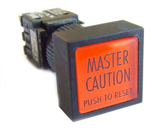

I have also picked up on Magpie's comment elsewhere to the effect that warning lights are often more useful than gauges. I have a set of nice Speedhut oil and water temperature gauges and an oil pressure gauge but I think I will put them aside, duplicate my sensors and datalog through the ECU to the Solo the sensor values, and use the second sensors to drive warning lights, including a big master alarm if I can get the wiring right.

Re: Data logging
Just the ticket! Source?
