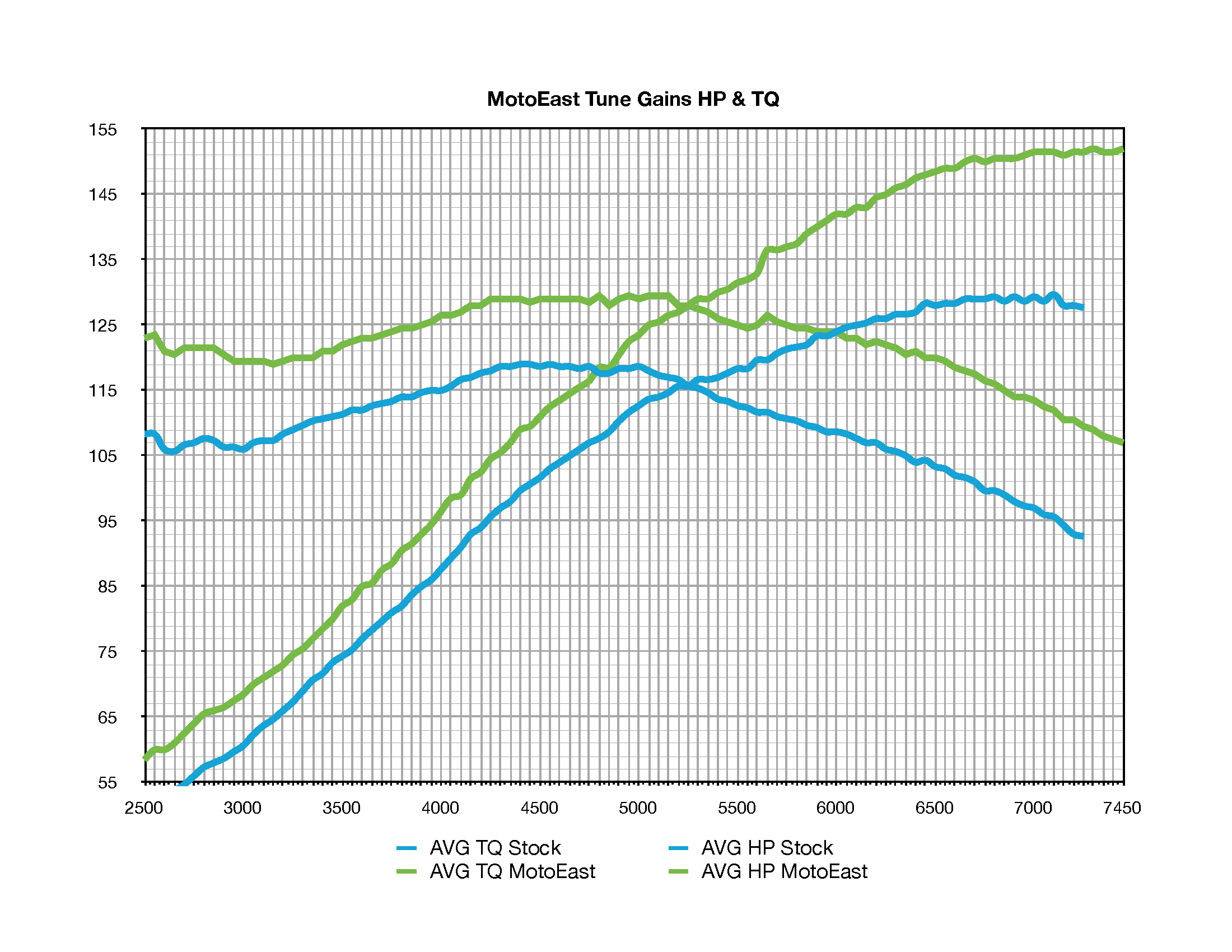

Complete exhaust with CAI and Tune assuming a healthy engine (I've almost clocked up 160K) you'll get ~30 HP + ~27 Nm, but the biggest gains occur after 5k, where you hardly visit for a road car.
http://www.moto-east.com/main/wp-conten ... -Chart.png
There is also considerably more noise, especially in a soft top, this is something to consider for a daily.
This has a low return as a "bang for buck" rating, I would actually say this is not worth the money (for me at least), the 2.5L while costing a bit more has a better return. I certainly have gotten better increases for the same sort of cash from other cars though, so from that perspective its a bit disappointing.
