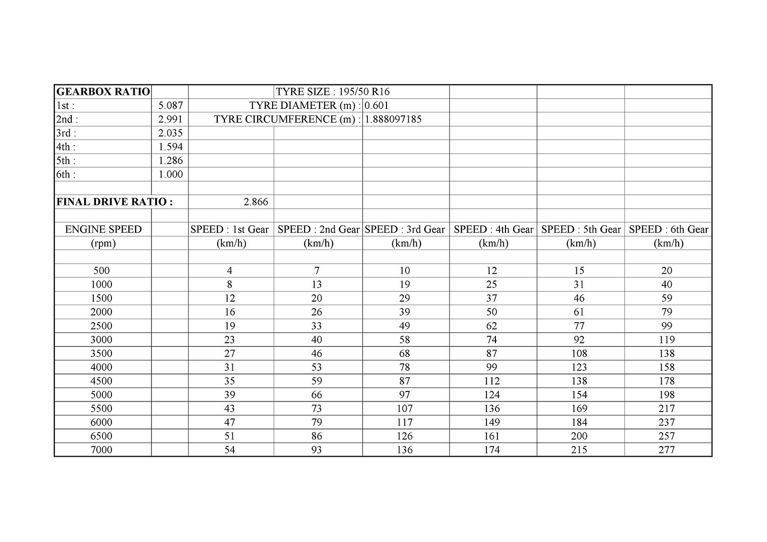

If you overlay the table for the standard ND with its maximum torque of 150 NM at 4800 and power of 96KW at 7000 rpm then it is easy to understand why despite the apparent good ratios it is still over geared.If it had something like the 1.2 turbo out of the base Renault Megane with 98 kw and 205 Nm at 2000 rpm it would fly with these ratios but as it is it is hardly ever in the sweet spot and passing quickly on B roads would need a change to 3rd or 4th at beast..And driving it that is how I felt it was ,loved the car,love the idea of a small high revving engine but....
And yes i do understand that it is good to have a high gear for nice cruising, just not sure it needs to be this high and I was only instancing the top speed gearing to illustrate that.

Cruising at 100 in 6th = 2500. Want to overtake - simple up and down to 4th and floor it. It's a very simple gear change to make. 5th gear in the 1.5L is short by modern standards. 30km/h per 1000rpm
That said, the power delivery of the 2L will suit the gearing better.

Agree,but if you are doing 90 klmph in fourth that is about 3600 rpm and still miles away from top torque and power and from my drive that is how it felt.
2ltr base sounds like the go.

I don't think changing final drive really solves that issue as final drive doesn't change the RPM you end up at in an earlier gear when downshifting from the same RPM point in a higher gear, it will only change your speed at that point.
So while going to a higher final drive ratio might solve the problem for your very specific cruising at 90 kmh example the same issue will happen if you are doing the same downshift with a few km less speed.
The solution to your problem of not being in the right RPM range at 90km with the stock setup is to downshift to third so you end up at 4600RPM.
Guran wrote:Nice one Dan. One slight flaw in your analysis: the 2.0L ND cuts out at 6500rpm and your calcs are for road speeds at 7000rpm.
Good Point, it shouldn't really change the comparison much though.
Maybe the lower redline and better low end torque on the engine could even make a slightly lower gearing than the equivalent of the NC 4.1 close to spot on with the 2L?

I think this explains why we are at odds,higher numerical ie 3.7 vs 2.88 = lower ratio =more revs=more likely to be in the power band.So the ratio is the number of turns of the engine,expressed first to the number of turns of the axle.

Yeh, you'll have more revs at the same speed and have a higher likelihood of having a more optimal gear available which has the right rev range for the situation when you increase the final drive ratio.
It doesn't actually create "more revs" though as Final drive doesn't change what RPM the car will end up in when you shift gears so if you were at X RPM in a gear you will always end up at Y RPM in the next gear regardless of what final drive ratio you are running.
