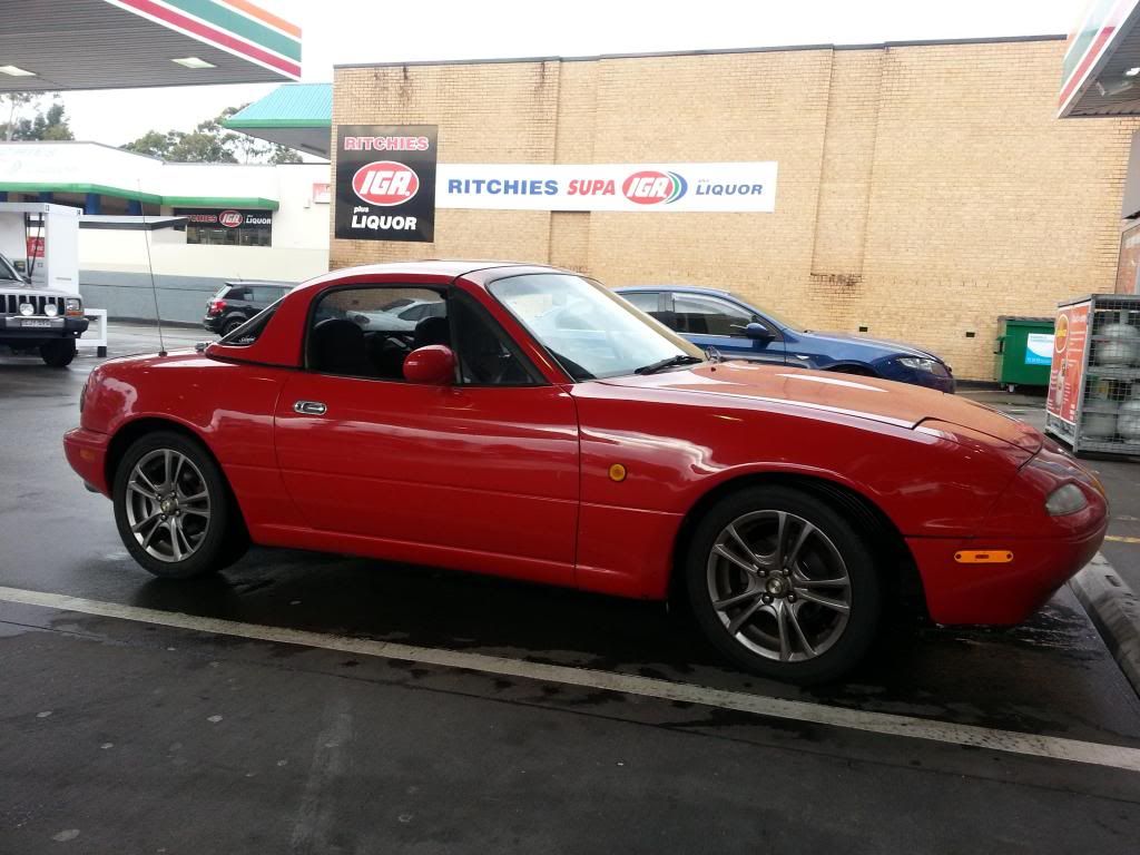

PS. Just n case anyone wanted to see a picture of the whole car lol.......................

Rear wheel looks to have a bit too much neg camber but could be just how it looks in the pic.
Suspension looks to be lowered or if standard springs, has sagged.

* Not sure on the suspension and alignment situation, will have to get it up on a hoist and check it out further
Re the suspension, standard coils are thin and black.

Power Steering is a nice to have, but you learn to move and turn in time. In respect to alignment if no power steering try not to have max caster, say around 3 deg on both sides.
